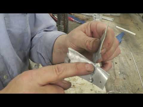

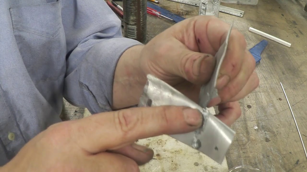

I would pick up some of the aluminum welding rods and use torches to weld them back on it is basically brazing and not very hard to do. I would definitely try it before I would replace the head. As to the liquid metal products or those puddy epoxy products I have not had great luck with them myself. Definitely don’t get them around gas it will eat JB weld even the stuff rated for fuel tanks doesn’t hold up.
Check out this video about aluminum welding
I have used this product with good results it is really not a hard process.
Thanks! This was so darn interesting! And considering the engine is really dirty and that there is a solid risk of fuel/oil spills, I won’t go with the epoxy products then. Luckily for me, this (final) outboard project is the 3rd of my medium-sized projects, so I can save up some moneys for a gas burner and such. (didn’t know brazing aluminium was a thing)
