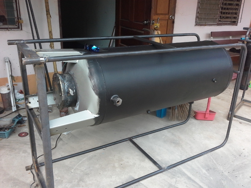

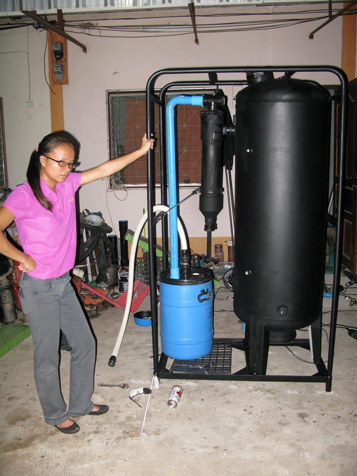

Two Charcoal gasifiers, build for export to Nigeria
So…just wondering here…once they fill that big boy up with charcoal…whats the rest of africa going to use to cook with?..going to be alot of cold chow judging by the size of that
nice work…whats it being used to run?
Hey Koen, I burned the shoelaces off my shoes while welding and cutting. It makes me nervous to see you doing that in flip flops,
Hi Callum, Don,
They want to run a 2.0 Liter engine running on it, not sure yet what for, but the rep he also wanted something to show. farmerstyle like ;-)… so i did build them a bigger version…

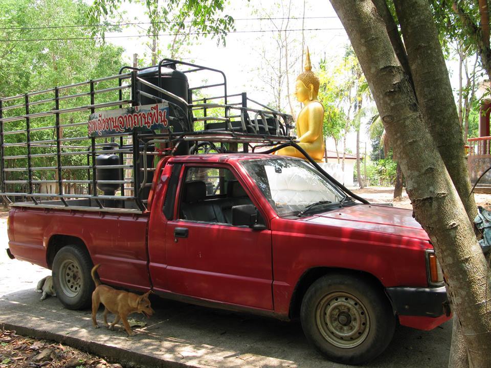

This size is also intended to be used on a pickup here in Thailand
It also runs great on anthracite, even more cheaper then charcoal…
Don, it all depends where you aim with your torch… i am quite fast now with flip flops when a hot drop falls on my foot. i had a few times drops and glowing parts in my working shoes… no way you have time to rescue your skin with shoes…

This large gasifier he will also be used with the small coal (1 / 16-1 / 2)?
The cyclone appears in iron, it is because the gas will come out too hot?

Thierry, no , the cyclone is from blue pvc 4"
The charcoal can be more coarse, between rice corn and thumbnail ( 3 and 18 mm )
but as usual, testing testing testing…
Koen.
Do you want to control the reactor temperature with CO2 and steam?
A tank coal this height (+/- 1.6 meter) produces a significant pressure loss.
Can we know distance between the gas manifold and air l`injecteur in the reactor?

This big unit go’s to Nigeria
I can control, but this unit is not equipped with the Co2 and steam
The actual distance between the nozzle tip and outlet manifold is 100 cm

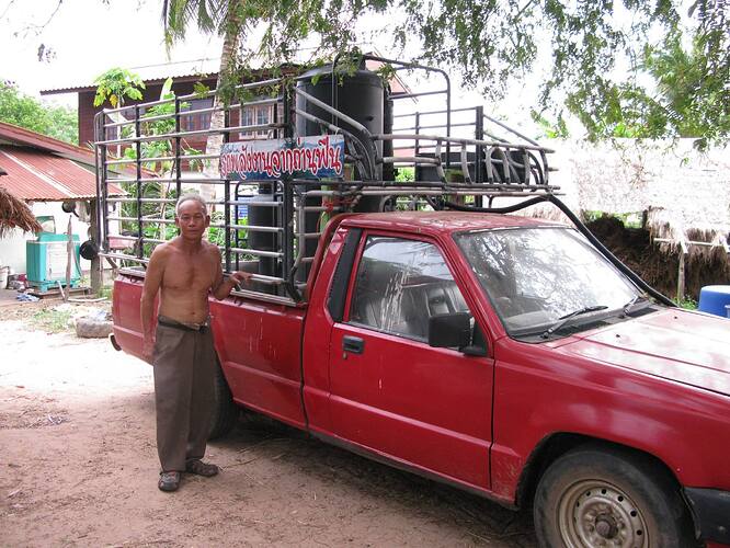

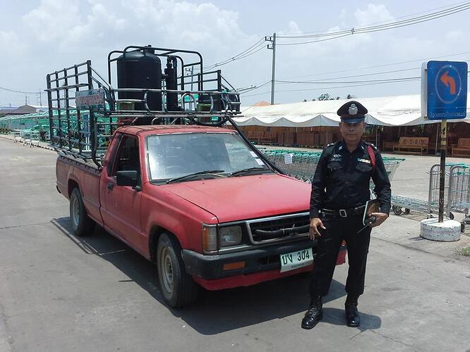

Decided to do some testing with the big one…
Big smile on my face…

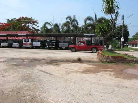

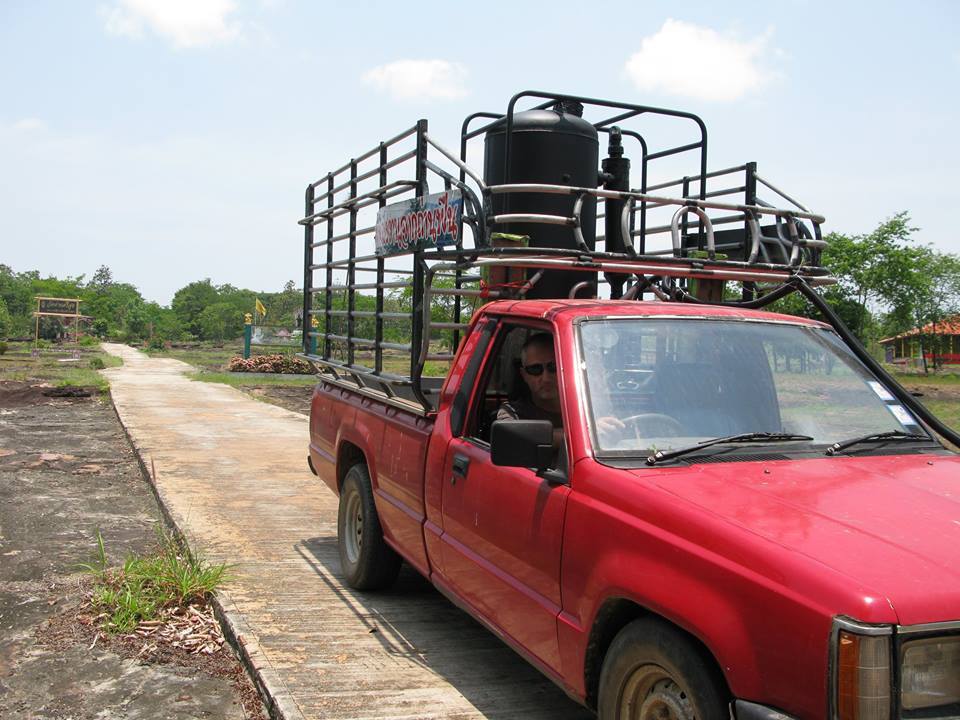

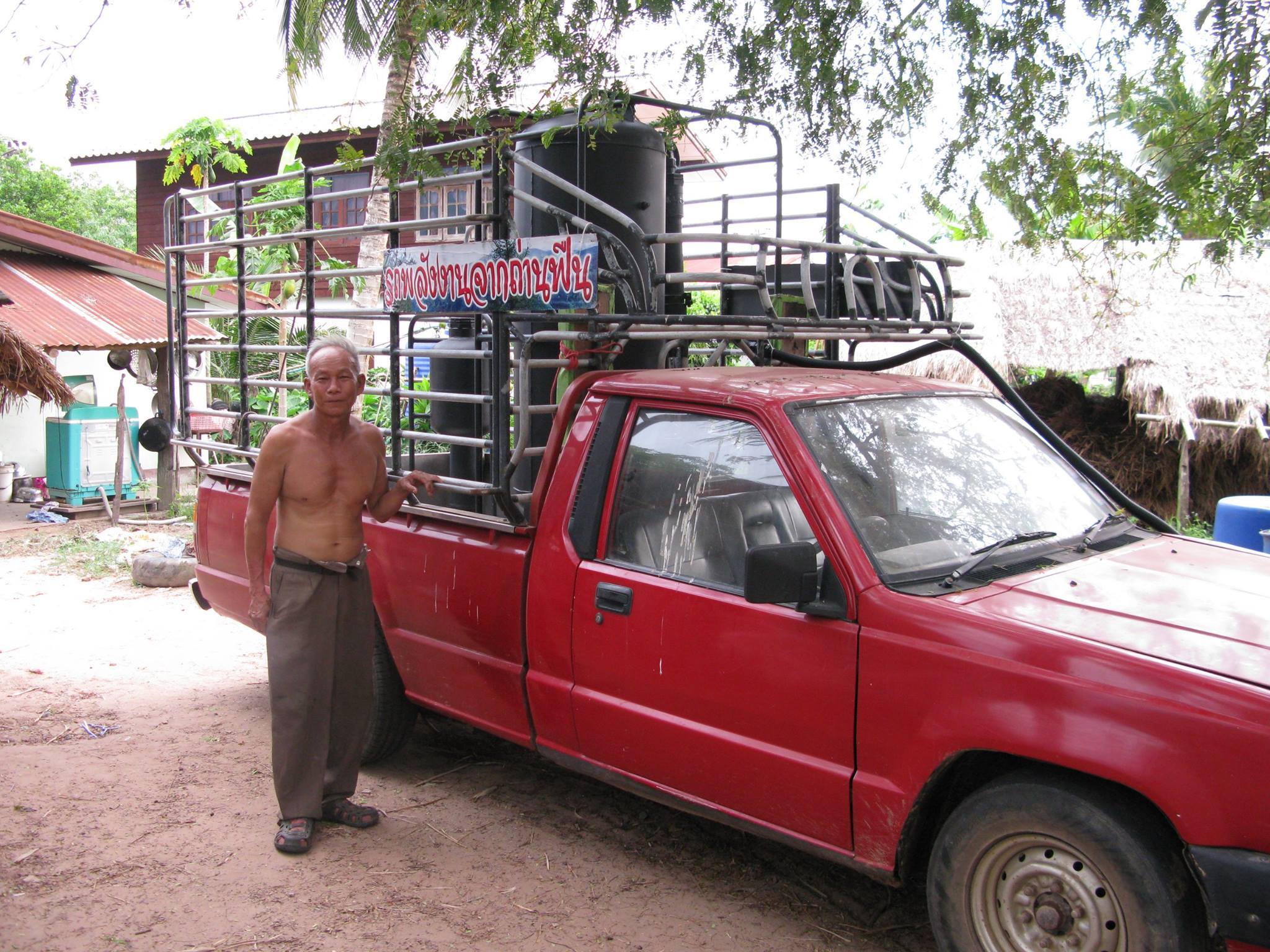

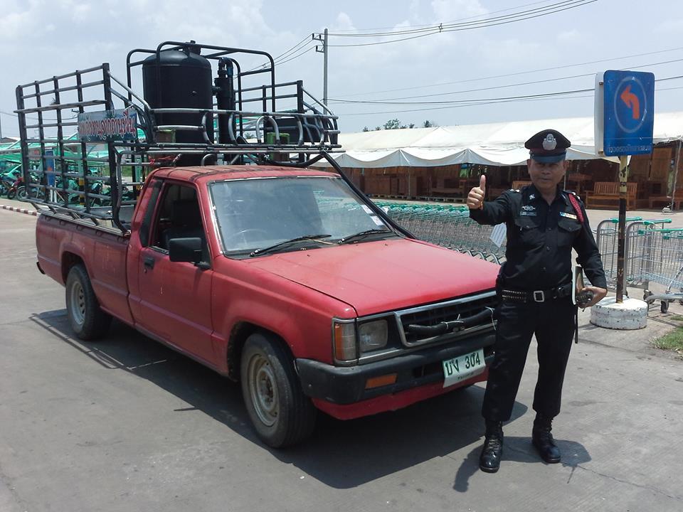

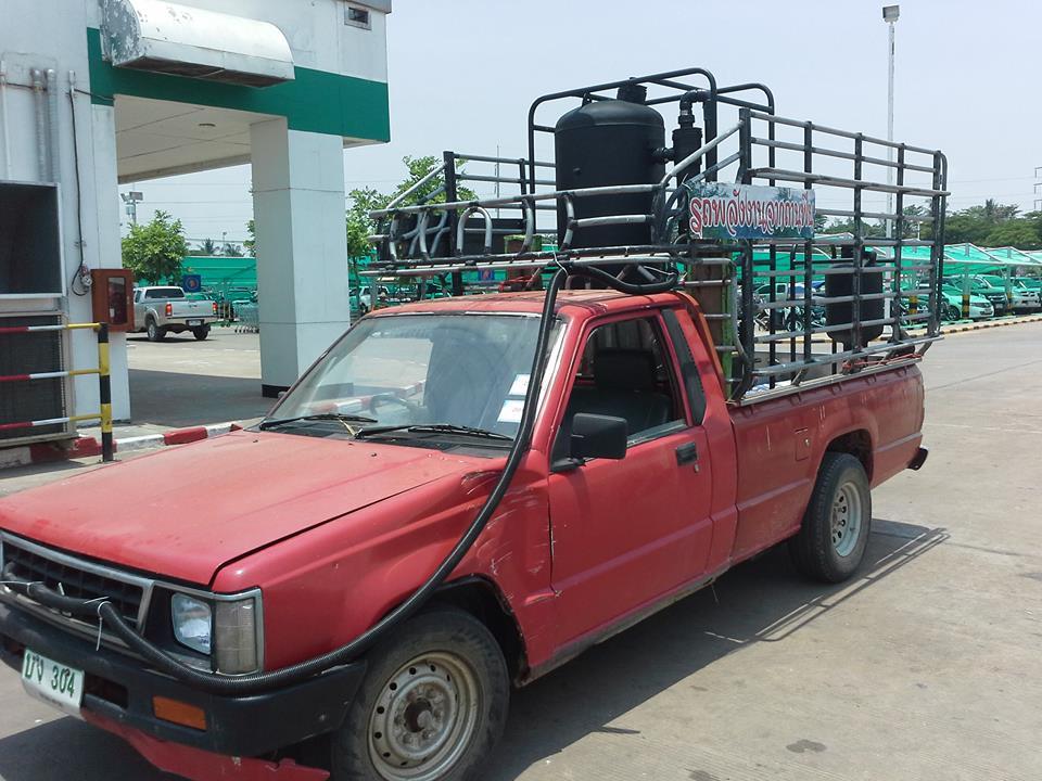

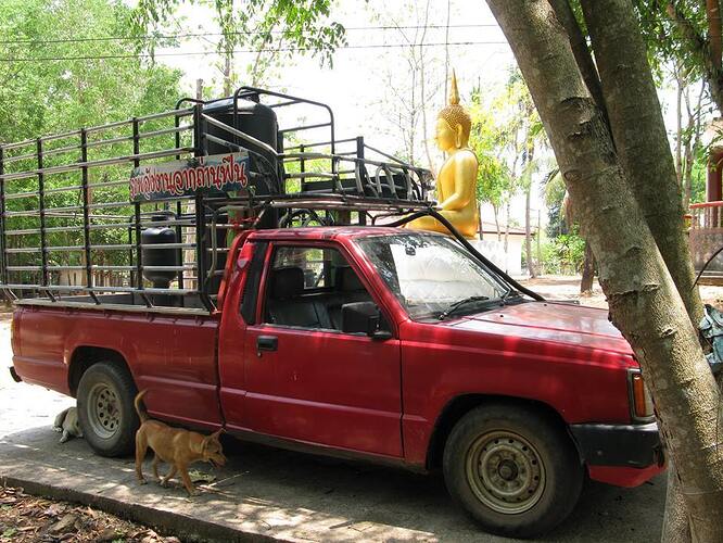

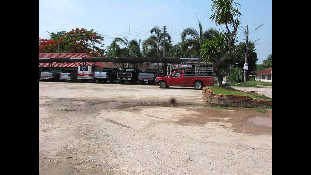

Video and pictures, unmodified diesel engine 2,5 liters
OMG Now that is impressive. Do you have the diesel pump set on idle to ignite the CO gas?. Why do you have the small gasifier sitting in the back? Just hauling it someplace? I am impresses. TomC
Hi Koen
The gas supply pipe going to the motor seems small section?
Yet the engine does not seem limited.
The gas must be very rich?
Hi Tom, Thierry,
Yes, bringing the 2 sets to my village from my workshop…
The engine diesel pump is choked down but adjustable, timing unchanged ( noticeable)
The gasifier is “nozzled” with a 3/4"
Rpm engine kept low for not stretching my luck…
Pipe forwards is 30mm ND so just within limits for the show…
