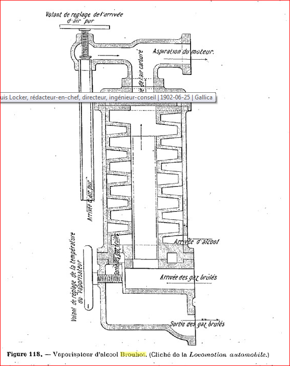

Large subject that I think will keep us in suspense for a long time, here is a 1902 drawing of an alcohol vaporizer from the Brouhot establishments, carburetor device before engine.

Old engines indeed needed the alcohol preheater, but new engines do perfect without it
