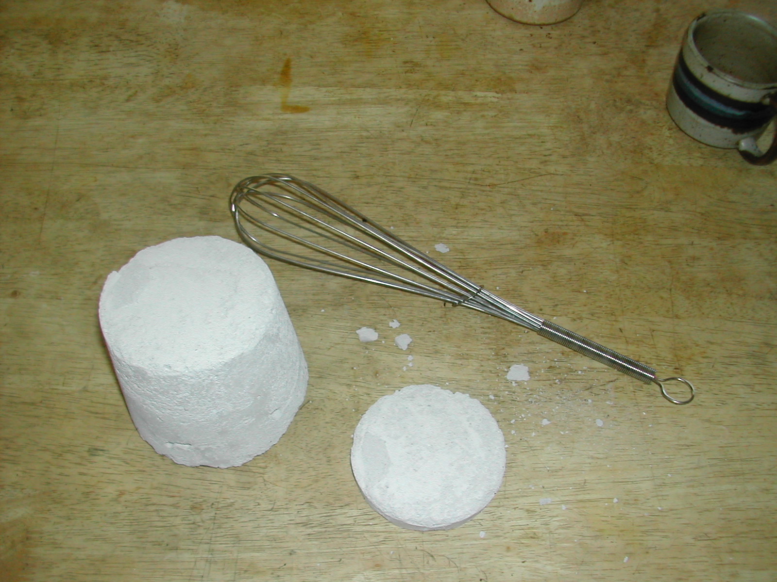

I recommend everyone should make a little bit of aircrete in the kitchen just for a test. You can use a wire wisk to make foam for the test. If you are going to make a lot of aircrete, like for a patio or something, then make a foam machine. https://www.youtube.com/watch?v=aSLJCPR1Prw

I used Dawn soap the first time. And then I used Suave shampoo. The shampoo made foam a little faster, but they both worked.

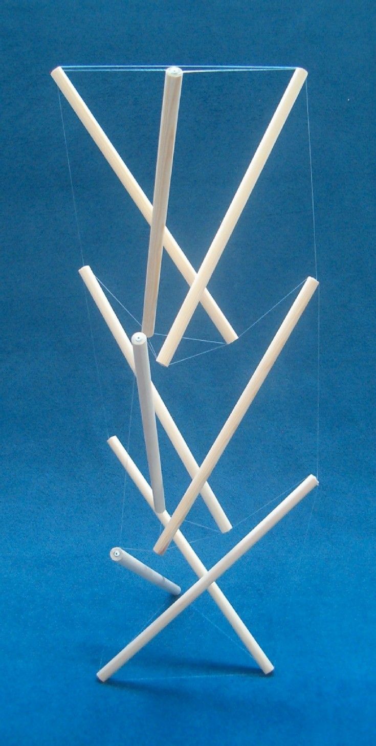

Bag_of_bars
question what is a structure ?
this is what google says:
Structure definition . Within the context of the built environment , the term ’ structure ’ refers to anything that is constructed or built from different interrelated parts with a fixed location on the ground
iI dont know what it is but it looks like abstract art or somthing. I couldnt see somthing built using that. But i am old fashion i guess.

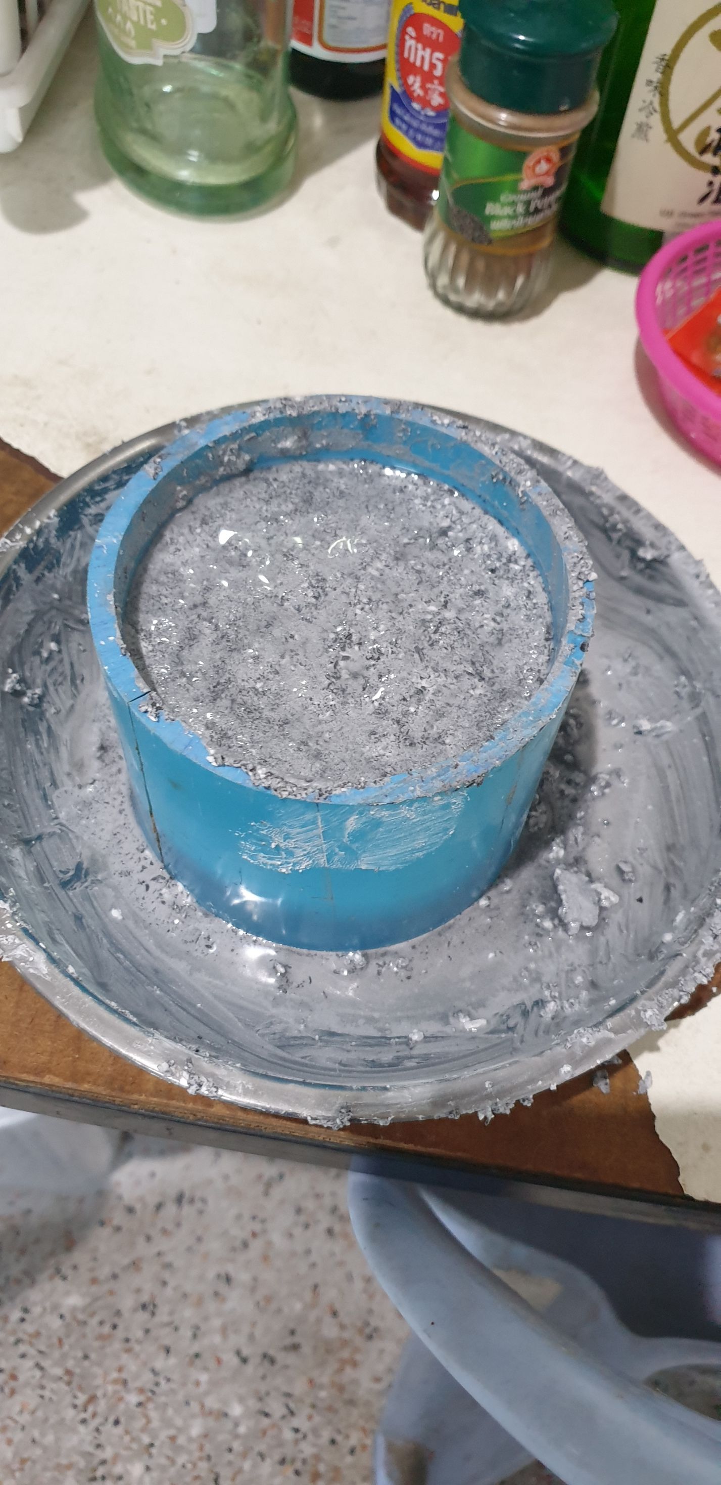

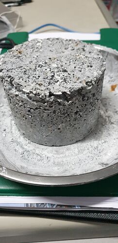

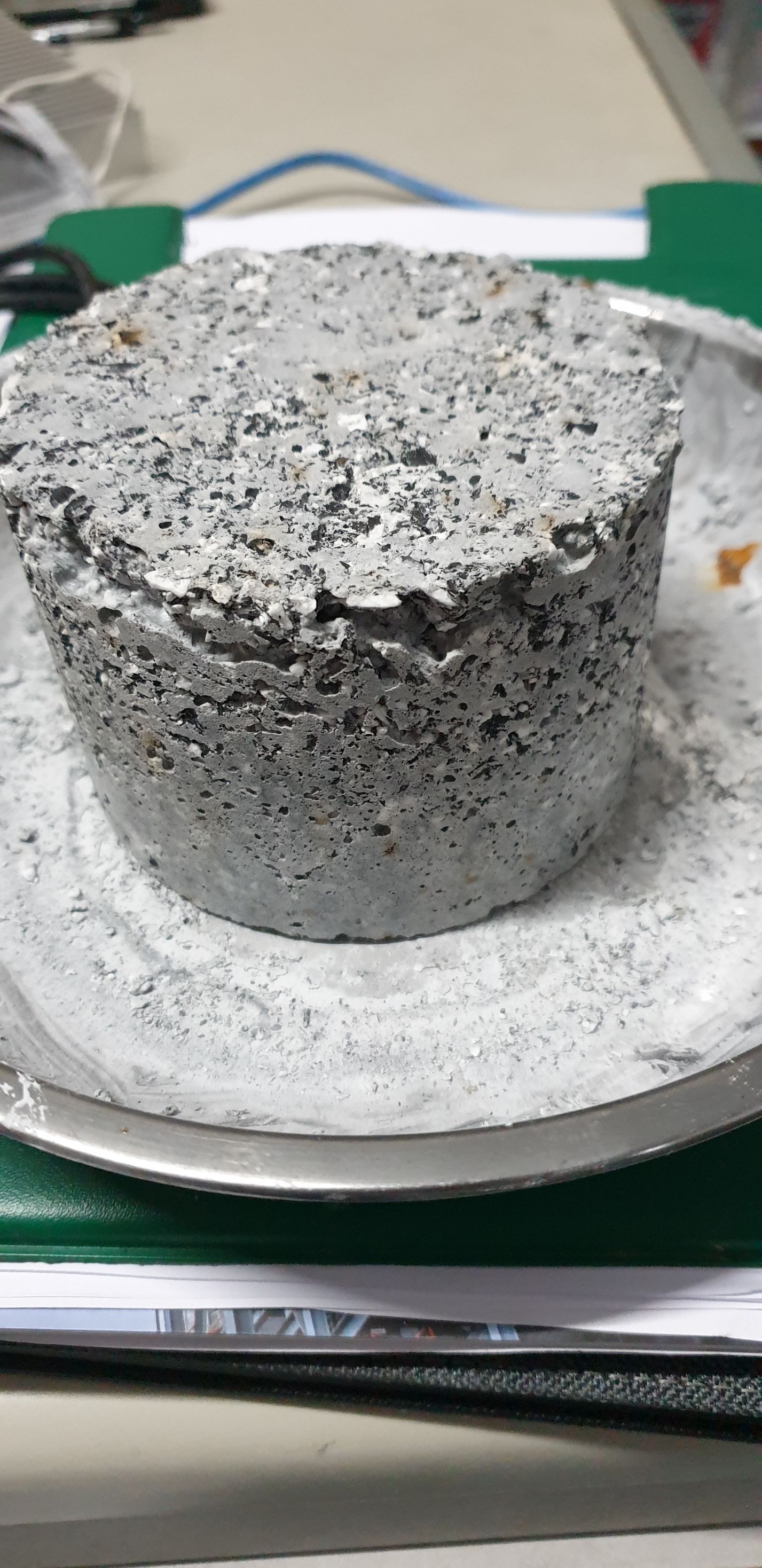

As i have a lot of boiler ashes and char, i just mixed with ciment and some lime into a test brick.
Has to be charcoal concrete, yes,…
Purpose and effect: cooling by evaporation
Goal: industrial cooling of process water for one
And making bricks for a sun facing wall at the other…
as the blocks retain water and evaporate slowly, they are amazingly cool to the touch… about 10ºC cooler then the room temp.
