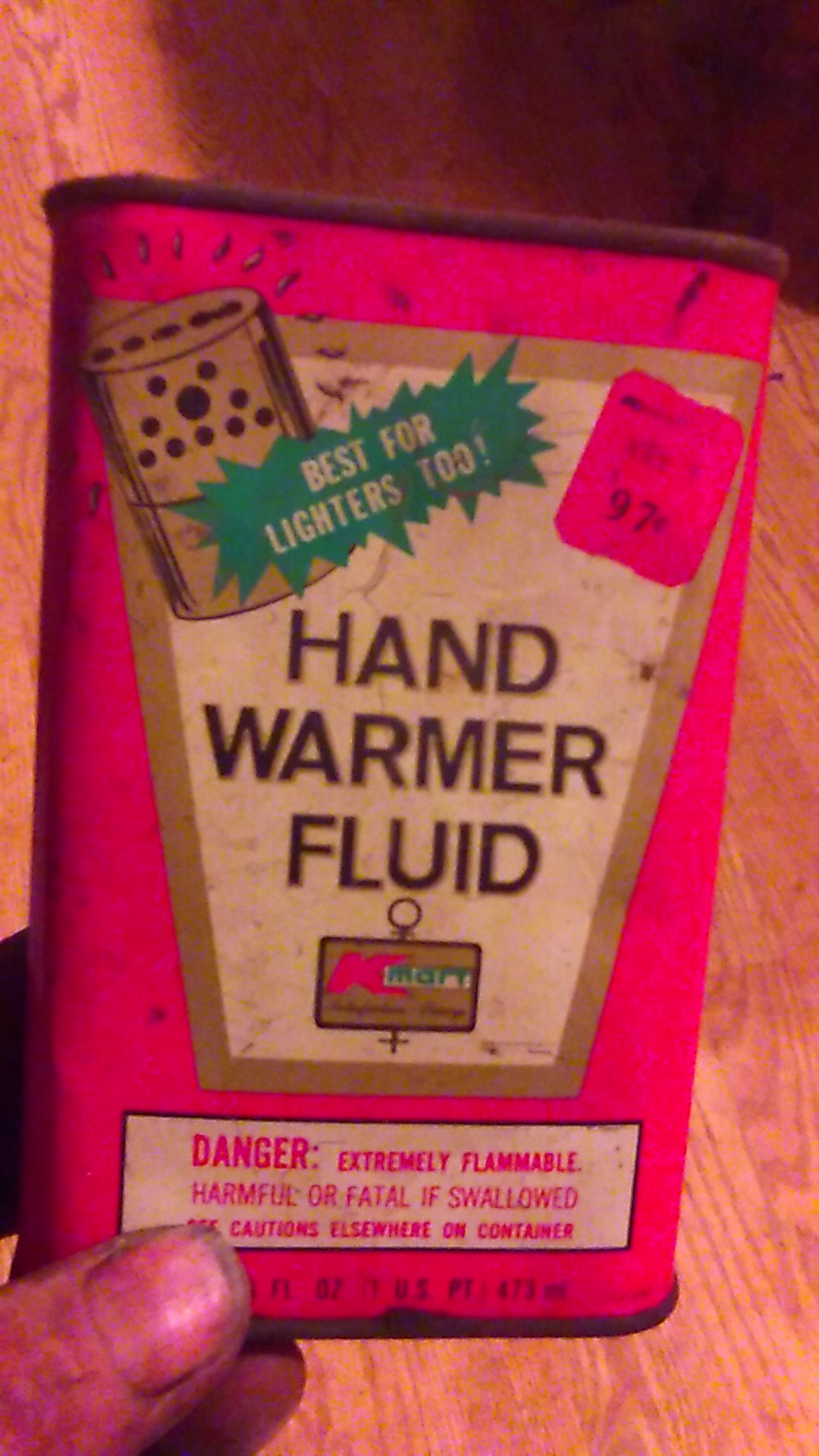

Hand warmer fluid. Is this what you mean?
The price tag says K Mart.
