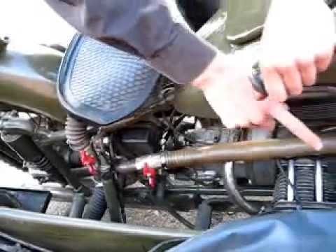

hello, see my motorcycle
Siarhei Atr. Nice Job! One of my ongoing projects is a charcoal powered motorcycle sidecar rig using a Honda 600 cc V-Twin, which has a single carburetor. Thanks for the very detailed link showing the construction at http://oppozit.ru/article85319.html To view the blog in English, I used Chromium Web Browser which translates the whole works. Toward the end, some of the photos were blank, and to view them, I needed to do a “right click”, and select to view them in a new tab. Also, I’m not exactly sure what is used in the bottom 20 liter filter bucket?
Great project, Siarhei Atr! Very nice woodgas bike, certainly a couple steps up from my project. You’ve inspired me to get back to my carburetor problems and finish up my bike.
John

Thanks for the nice comments, few people can evaluate such projects.

Excellent build Siarhei, the original motorcycle looks old with a history of its own. I like the finished look like something from WWll. Good video too.
Fantastic motorcycle!

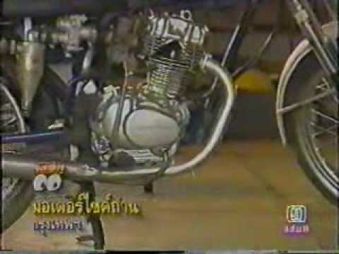

I did see this one, charcoal bike in Thailand,…
