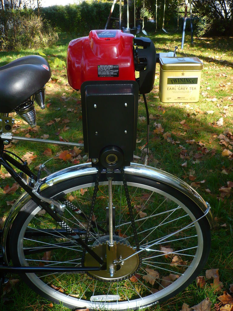

The project is to make a charcoal gas powered motorized bicycle similar to the few WW II era gasbikes I’ve seen on the web.

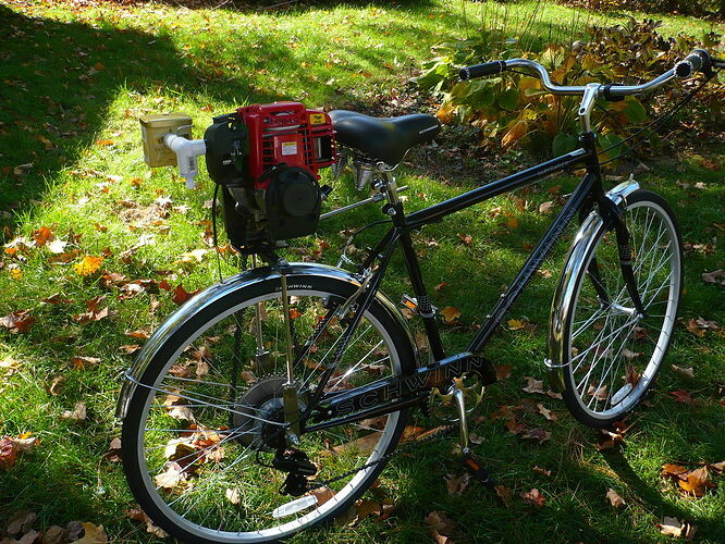

The engine here is a copy of a honda OHC clone, 37cc 4 stroke. Mounting kit from livefastmotors. It looked like a basic rear mounted chain drive kit which can also be adapted to recumbent bikes (as opposed to within frame kits)–I’ve built a couple of recumbent frames, too, and may use this on one. I’m hoping the kit is heavy duty enough as I am also planning to use it for support of the gasifier, filter, and cooler.
The gasifier itself is a slightly smaller version of Gary’s simple fire using a stainless steel stock pot and 1/2" nozzle. The test of this system appears on another thread here, easy gasifier for a log-splitter engine.
Below are pictures of the basic engine and drive setup as well as carburator and mixing modifications. The rest of the build will be coming over the next few months.

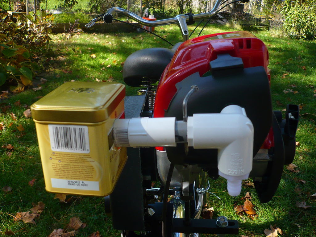

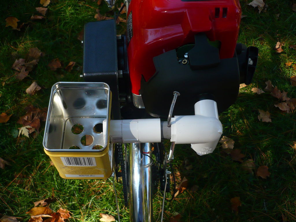

ok, i’m intrigued. looks like a great project to start out with. what’s the square metal can do?

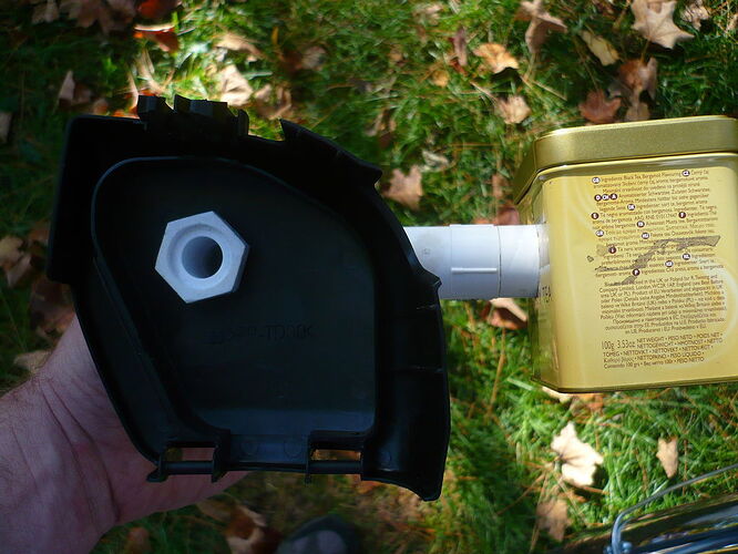

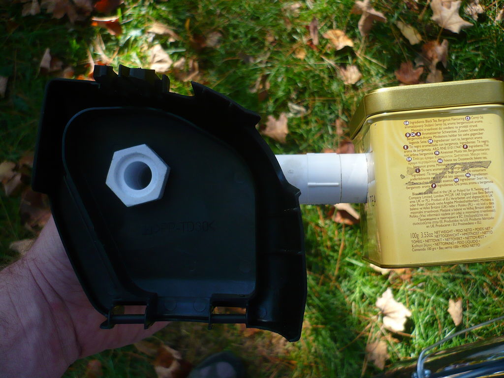

Robin, the square can is meant to house an oiled foam air filter since I’m mixing charcoal gas and air before sending it into what had been the original air filter housing. I want to use the original throttle, plus I have the option then of making this a gasoline/woodgas hybrid, too. Interesting there were also versions of woodgas bikes in asia then. The ones I’ve seen pictures of were Swedish and Russian. The tech was really widespread I guess. I hear you about the electric bikes, Matt, but that seems way beyond me at this point. I was thinking this extended commuter bike might be fun to run on yard waste.

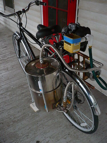

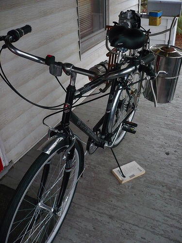

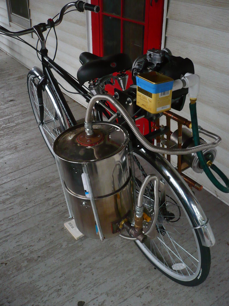

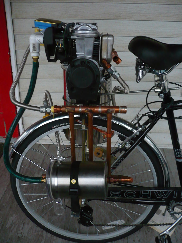

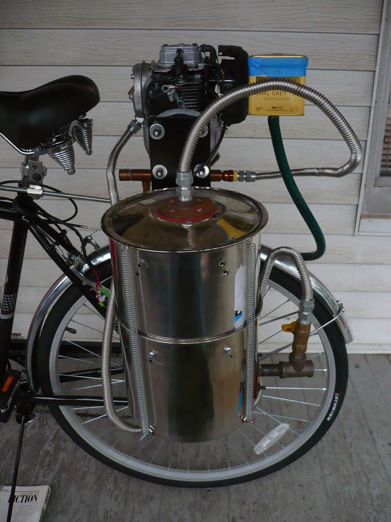

Here are pics of my progress. The basic system layout is finished. Pretty much only need to work on seals before testing.

Thanks so much, Wayne, and thanks for this site! We’ll see what kind of mileage I can get per pound with this thing. I’m working my courage up to a bigger woodgas project one of these days.
