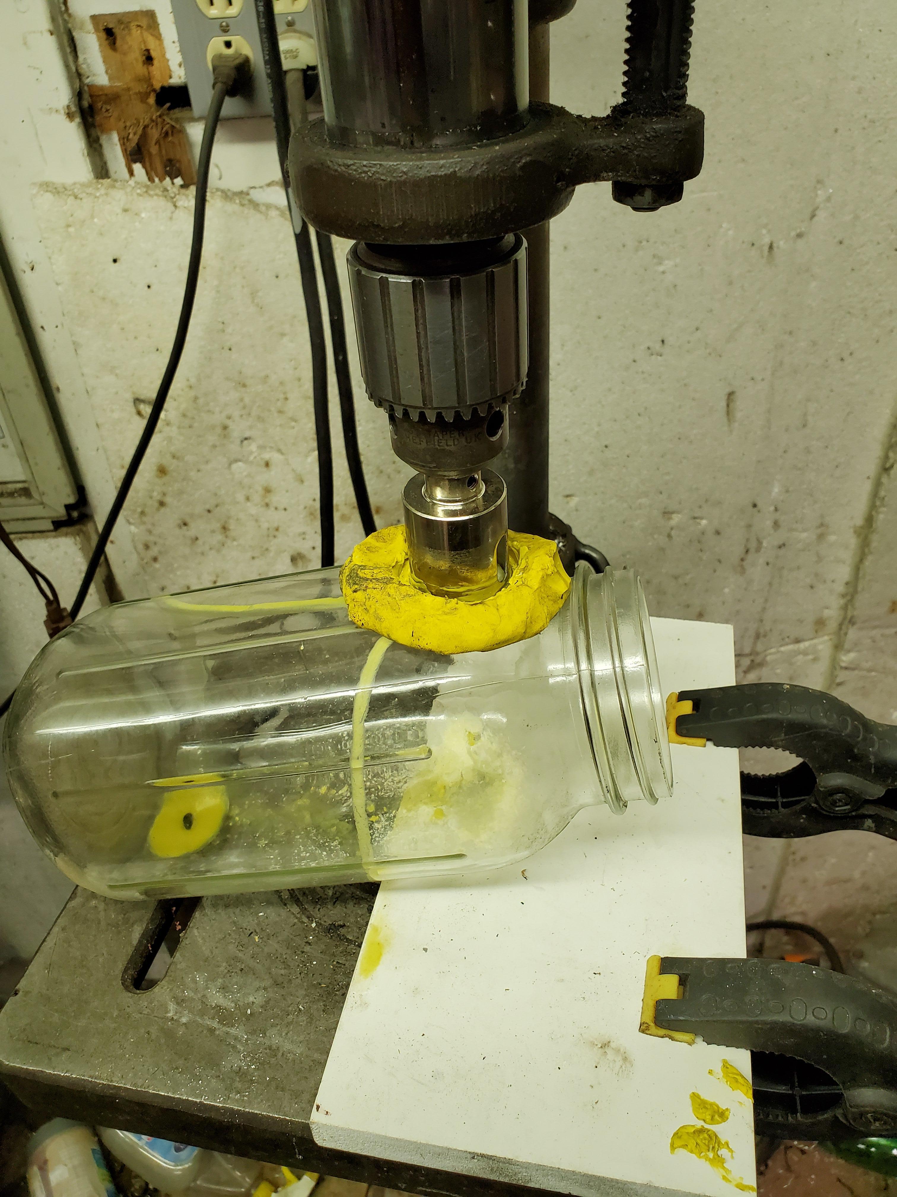

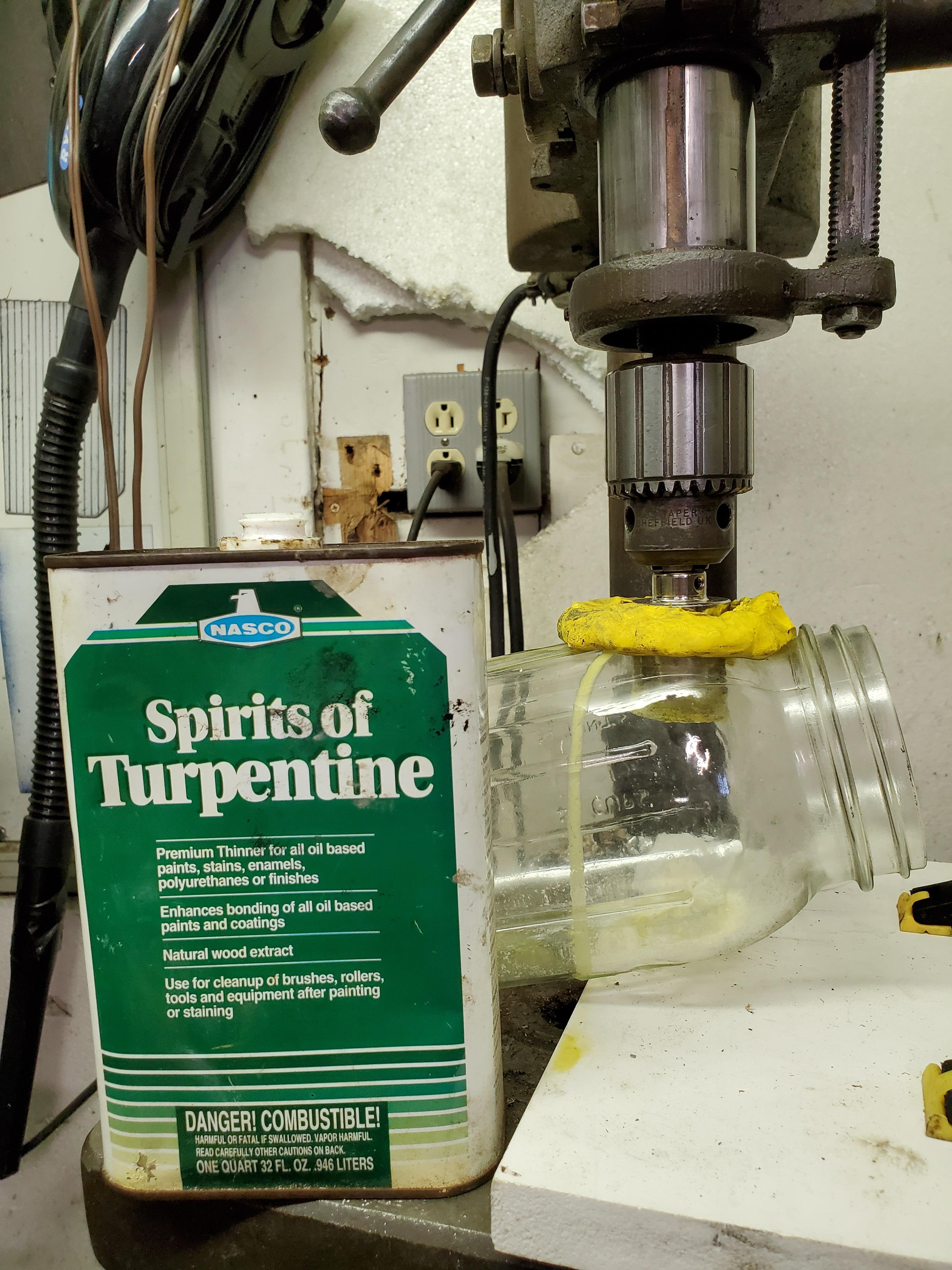

My canning jar “spectrometer” is going to be a bit more basic. I drilled a hole in a 2 Qt jar for the outlet.
Cheap Chinese diamond hole saw, modeling clay dam to hold a little turpentine.
So far, so good.
Impressive drilling!!! :smiley::smiley::+1::+1::ok_hand:
