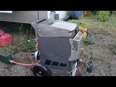

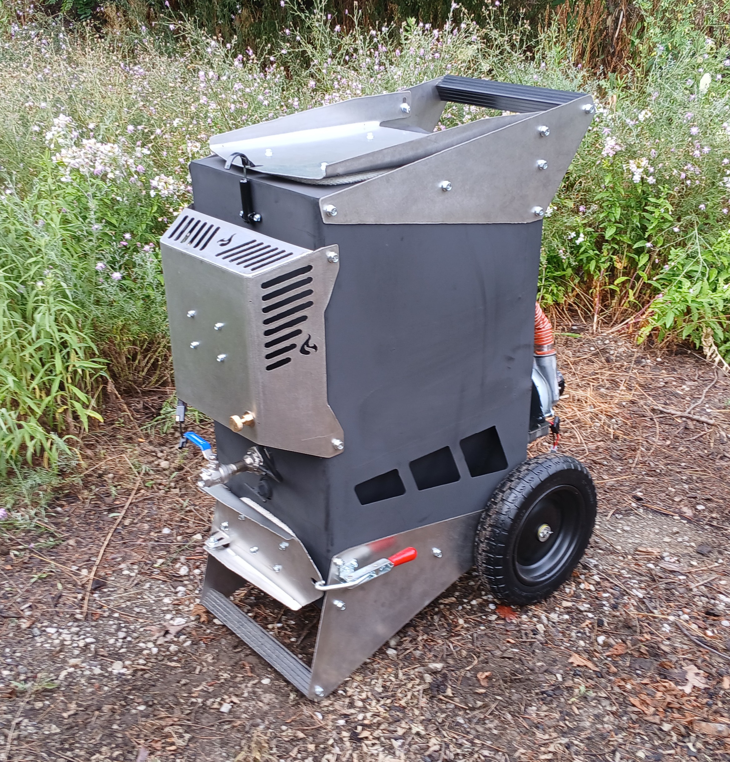

you cant beat a cross draft especially with steam injection.
First time I have seen a cross draft… So his last build was to make the charcoal, this build is the real gasifier, I can tell this was not his first rodeo…
Havent you seen the charcoal units Ive been building the last 5 years. They have been this design since the start. I built that first prototype and not even month went by and scrapped the wood fueled system that spent the last 10 years of my life devleping. Just like that too! Ill never go back in fact his is the last revision of the CXF. There is just two more things I want to do. One is use a PWM speed control for the RV Pump rather than the flacher relay. But I dont think it will work as the presure switch likes to stall with full voltage. So I dont know until I try and then I simply want to add a water loop that will run along each side of the reactor to help preheat the water plus convert some of it to steam. As the flow is so low it will have plenty time to convert. Im going to build one last one for myself to keep and that it.
