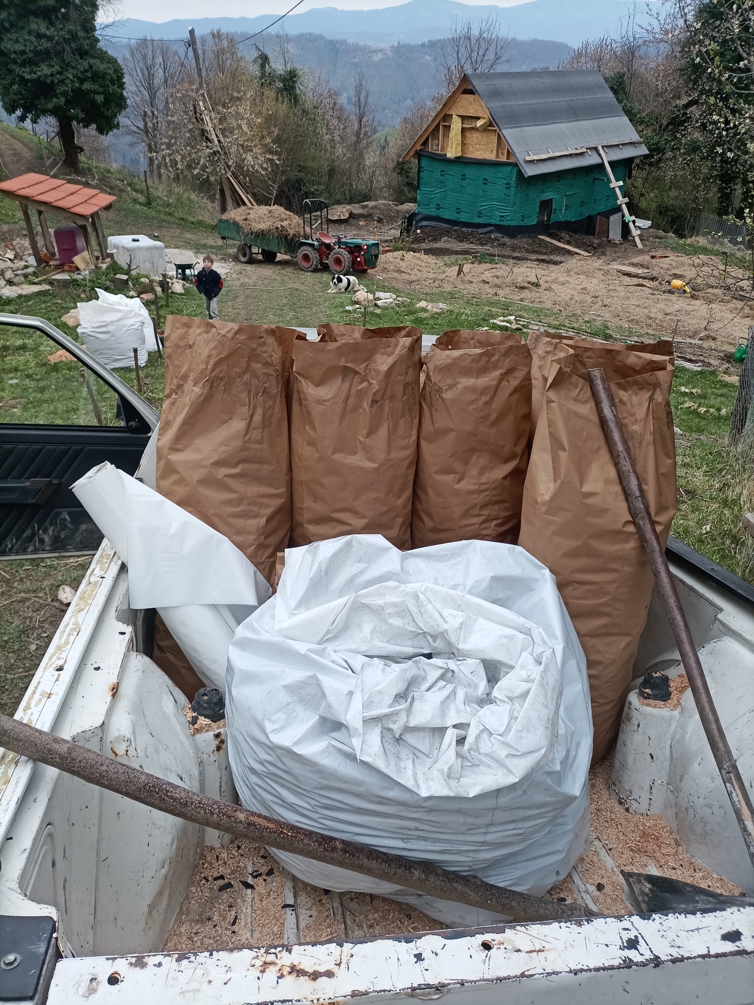

Second “comercial” run was sucsessfull.
Havent weighted the sacks yet but l wuld WAG there is about a good 20 pounds in each. Closer to 30. Those 5 paper bags of premium BBQ charcoal alone are worth about 100$. And about as much charcoal is in the white bag, finer stuff, great for gasifier fuel or for the garden. There is so much of it because l had to quench a hot spot and while perfectly good for home use, l dont dare to sell it.
Kristijan,
What bags are you using for your charcoal. I use plastic garbage bags usually pushed into a sack for strength and durability. I would like a single sturdier bag.
Steve, the paper bags are ment for sale. The big plastic bags l got years ago from a guy, no idea what they are for. But l am not a fan of neither. Paper is useless in moist conditions and they both tear. My preffered soft packageing is either thick plastic wowen big bag, or a smaller 60 pound same material grain bag. Durable! But will let dust trugh some. Still, better to get some dust trugh a loose part of a wowen mesh thain a big tear in a garbage bag…
My preffered is hard packaging. Plastic buckets. And, for the engine grade char, l plan to make a silo out of OSB boards that will hold acouple of cubic yards.

Kristijan, about the charcoal bags. I have used the plastic garbage bags inside the corn grain sacks with the thought of keeping moisture from being absorbed by the charcoal and also to contain the dust. I think the dust would filter through the corn sacks without the plastic liner. A plastic bag, heavy enough to be reusable would be nice.

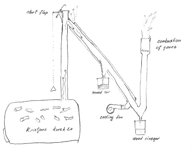

Yesterday we talked a little with Kristjan about the co-production of wood tar and wood vinegar in cooking charcoal, and here I am attaching a sketch. Let me also mention that Kristjan provided me with a premium membership, … thank you.
Seems simple. Am i correct in thinking that the vinegar is still in gaseous state when it bypassed the tar dump? How would you assure that it only dropped out after that?
I would maybe use a water jacket with natural thermo-siphoning. Would cool it a lot faster and more thoroughly especially considering the size of Kristijan’s kiln.

I have been thinking about doing something like this too. It might be a next step toward building a bio-products refinery. This might be a way for a farmer to work during the cold winter months. The cold will make the condenser work better. Will you be able to sell the tar and vinegar?

I am afraid a water jacket wuld be too cool. If tar gets too cold its basicly chewing gum.

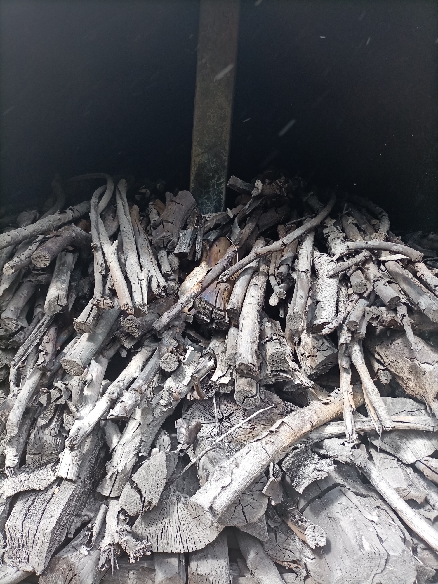

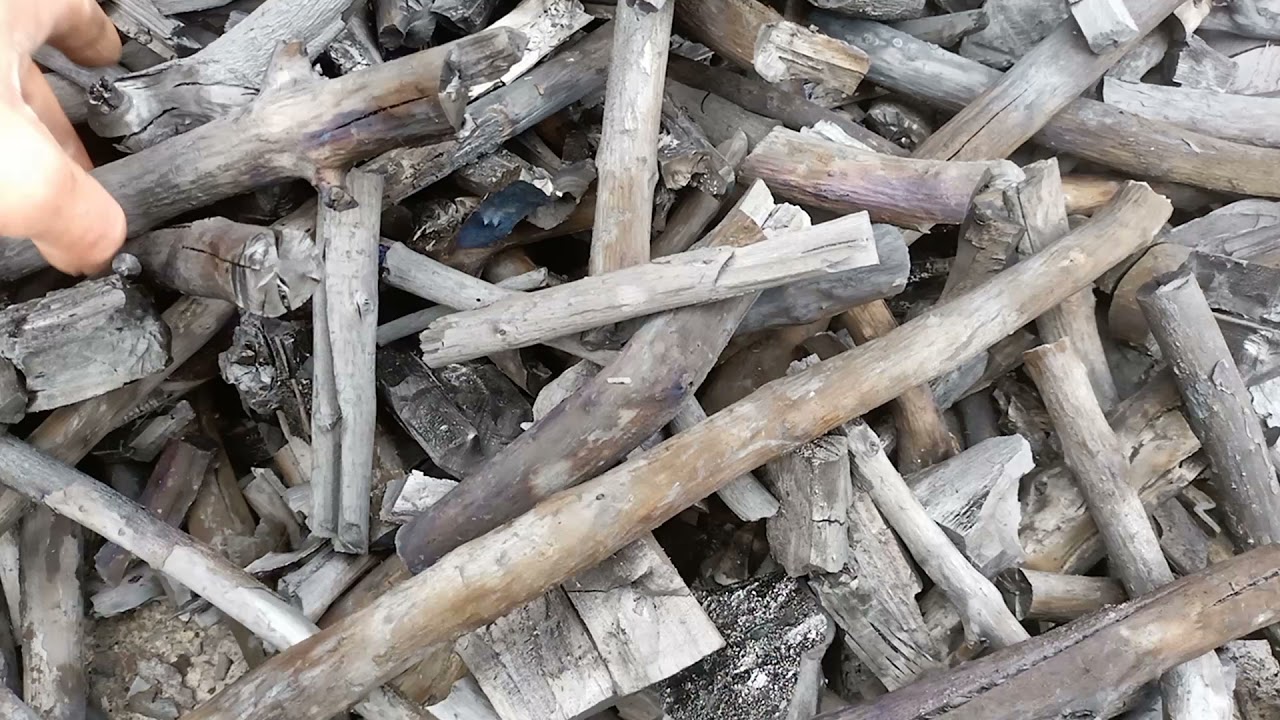

Dogwood charcoal. What a batch! Incredible.
WoW!!!
Do you have an OHM meter - Ω ?
That sounds like it may have transformed at least partly to graphite.

On your distillation apparatus once you determine the best angles; lengths and cooling rates you might what to consider making a second one, in-parallel.
You kiln once up to heating and producing is not going to want to stop until the mass is completed outgassing.
Be a shame when the distiller clogs to have to then just dump out your hot out-gasses to the atmosphere.
Cut in the 2nd apparatus.
And as any who have worked around heated vaporized and/or fine ground liquified slurries . . . it will always slowly inner walls deposit; flows slow, and clog.
The new-mans break-in/low-mans job . . . . cleaning the equipment’s between cycles.

That sounds and looks like that super-high quality “white charcoal” so prized by the Japanese for their formal Tea Ceremony. Those are individually wrapped and sold at upscale stores!! Wow!! :smile:
