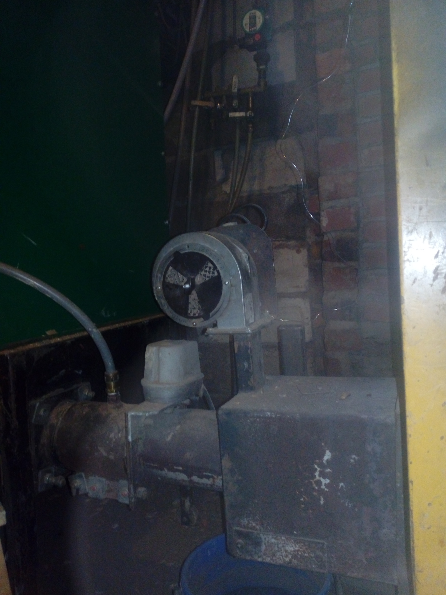

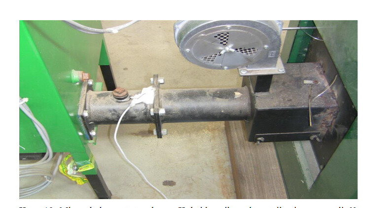

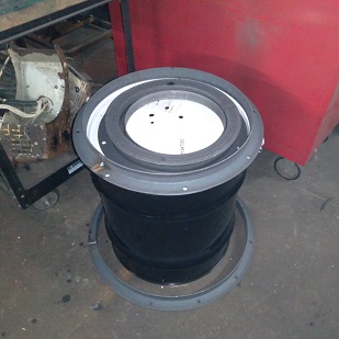

https://yle.fi/uutiset/3-10470198![kattila|375x500](upload://9ZEE5if8276kuZ0sM1V73T22iNN.jpeg)

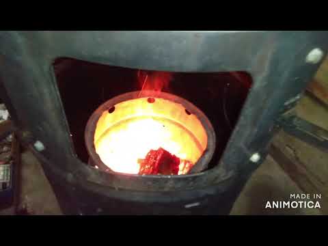

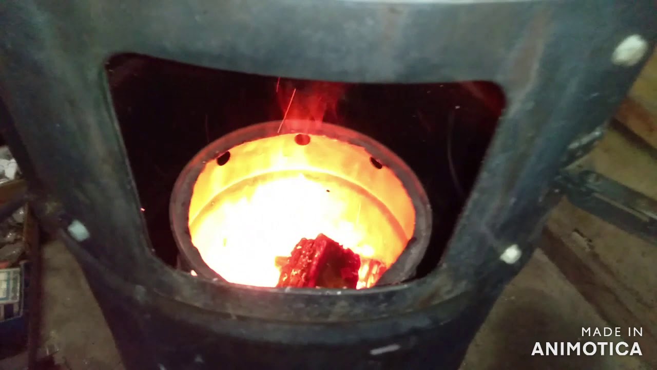

me first picture from me burner at home

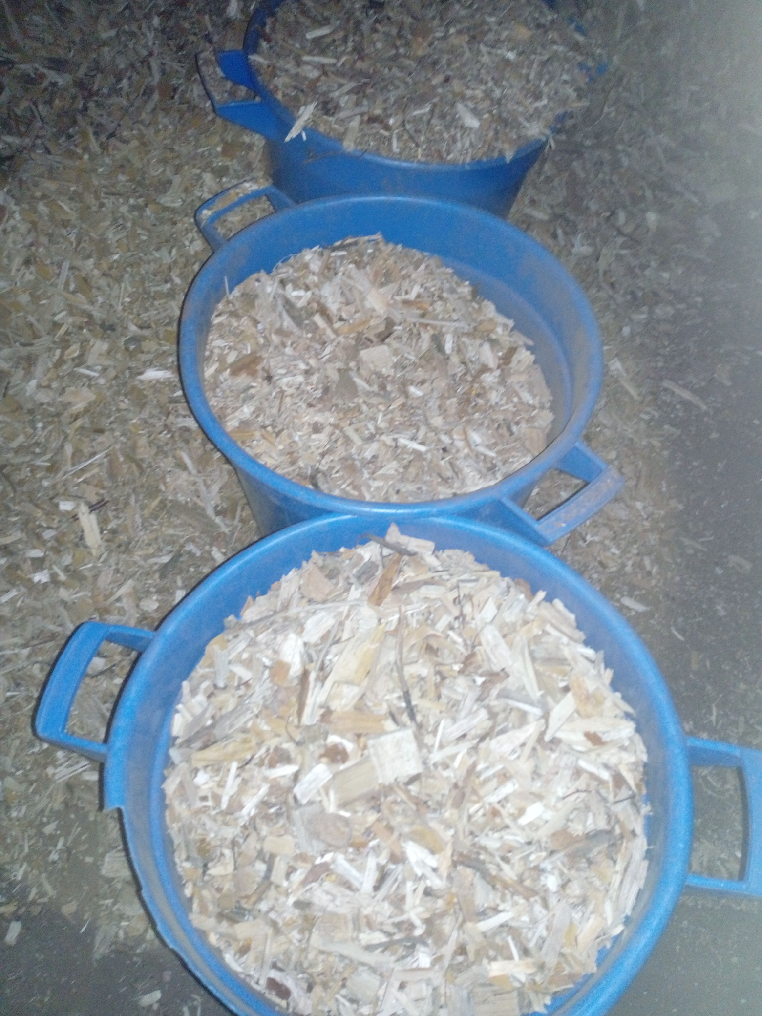

woodchips
evey day need 6 box 50 l woodships
build in 1995

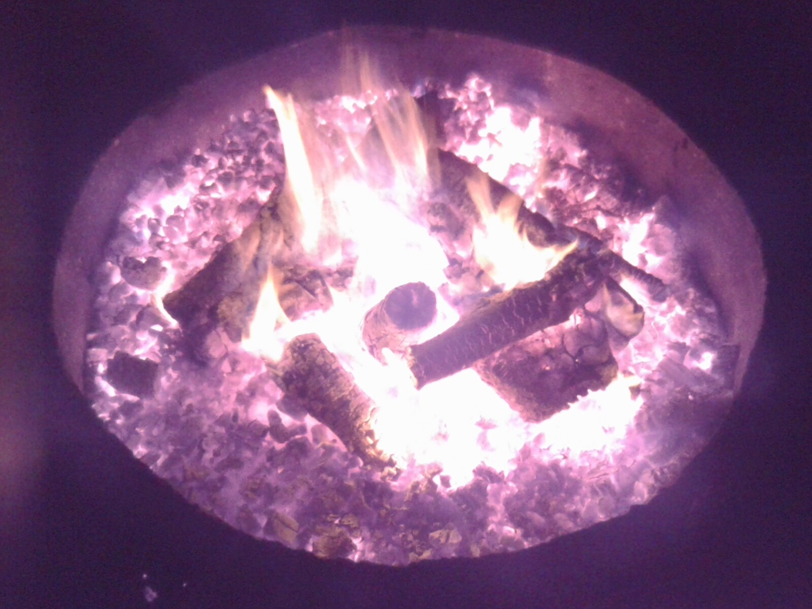

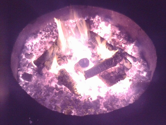

There is 3" of fresh snow on the ground and we are going to have a fire out in the back yard around the metal fire pit. Enjoying the evening with some friends. It will be cold so the fire will be large. When we are done for the evening I will shovel all that charcoal into my barrel and close the lid.
Charcoal made easy, and fun.
Very Nice!! Yeah I wish I had one out back to melt all the dang snow we got out there!! lol
Yeah If I had two or three out there no doubt they would melt the snow away. My generator melts a 5 foot radius around itself; thats running it all day and every day.

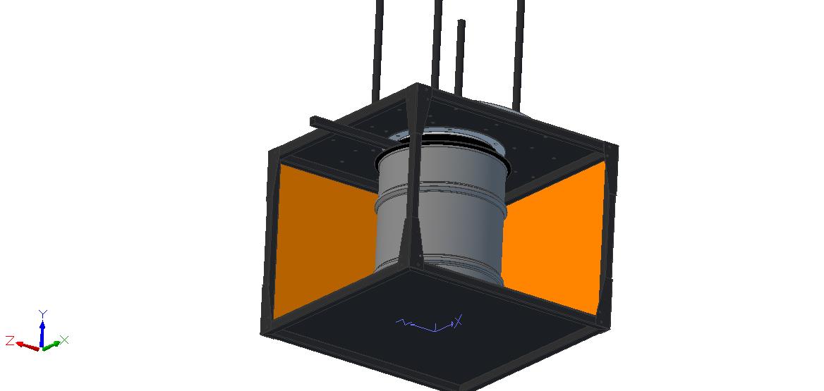

Well had to crank out the CAD model so I can quit thinking about it. here is where I am at. I need to draw Mock up 55 gal and the new 20 gal 19 inch diameter barrel. Done for night and have the basic design down, Ill work on creating those drums this weekend.
Ok done with this thing: well design wise anyways. Still need to create the CNC files and work orders to crank one out. Hope to be building and doing the tutorial by next weekend along with start up videos of the Ute and networking a few Max units with it. Busy busy!!
So what I think I have here is the BLUD CFCK (Bottom Lit Up Draft Continues Feed Charcoal Kiln)

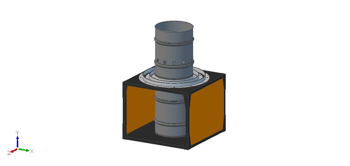

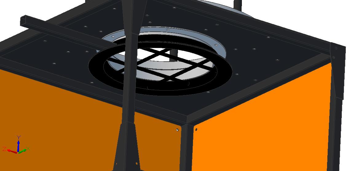

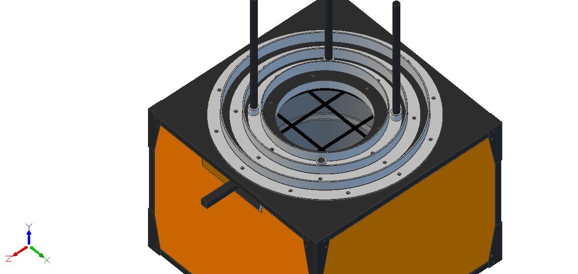

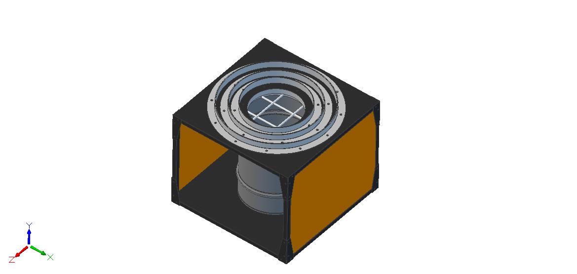

So here is the grate set up. Note the chains are not drawn but those will be hung from the fire tube. There is a flange that bolts to the bottom for the grate to follow and stay centered. It will be very loose so you can shake radially and back and forth. The grate is made from a solid flange and the flange side will rest on the catch barrel to seal it under operation.

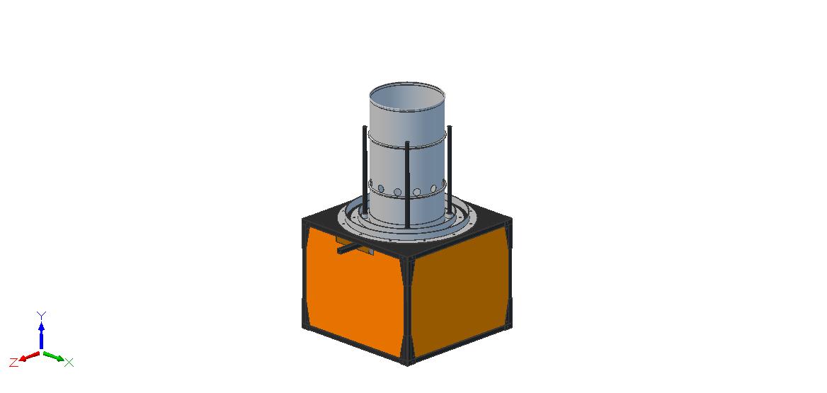

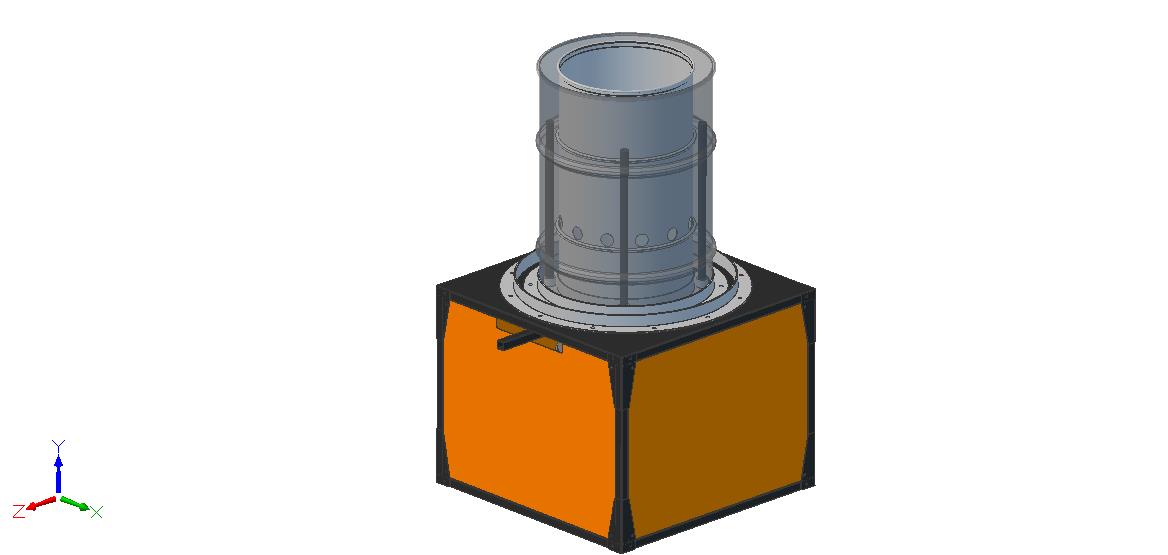

Here is the fire tube with the vent holes roughly one third the total height of the barrel. The four tube surrounding it are the second stage air tubes to provide air for the pyrolysis gases produced from the raw fuel in the hopper and combustion for the second stage burn process.

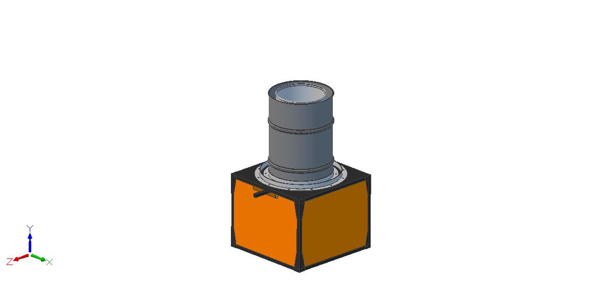

Not sure what call this outer barrel; Just calling it a shroud barrel. So here the fire tube is housed with this shroud barrel to transfer the combustion gas away from the raw fuel feed and bring it to the top. Then mix with pyrolysis gases given off of the raw and the second stage air feed for the second stage combustion process.

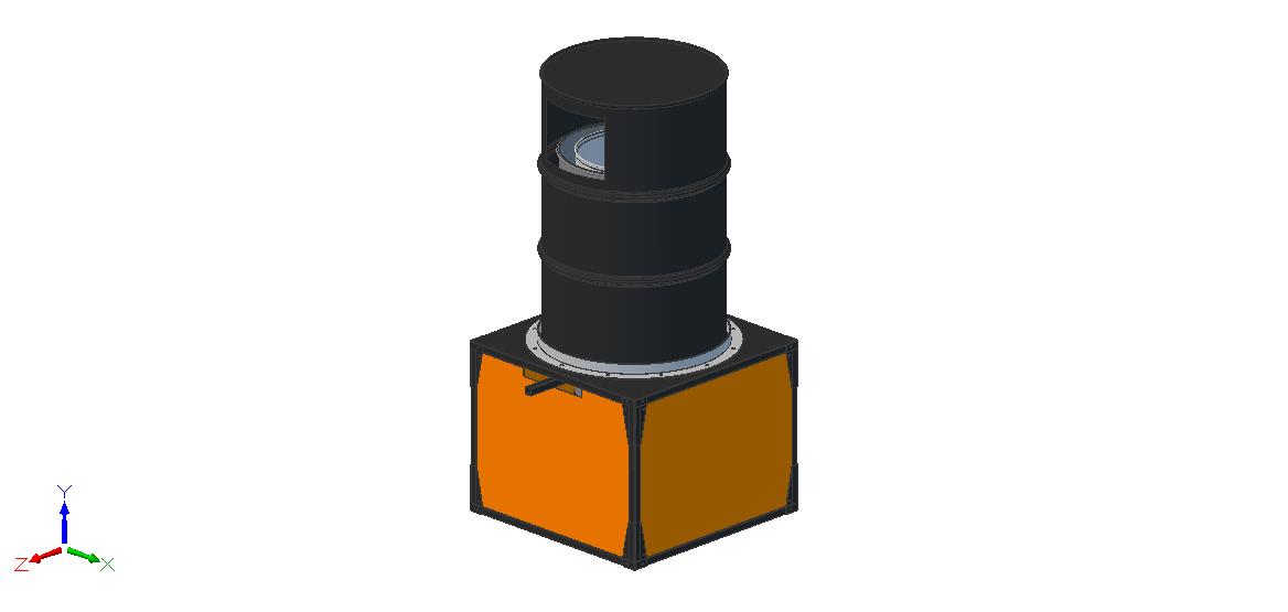

Then here is the 55 gallon drum “bell” with cut out for the loading door and chimney port out the lower back.
