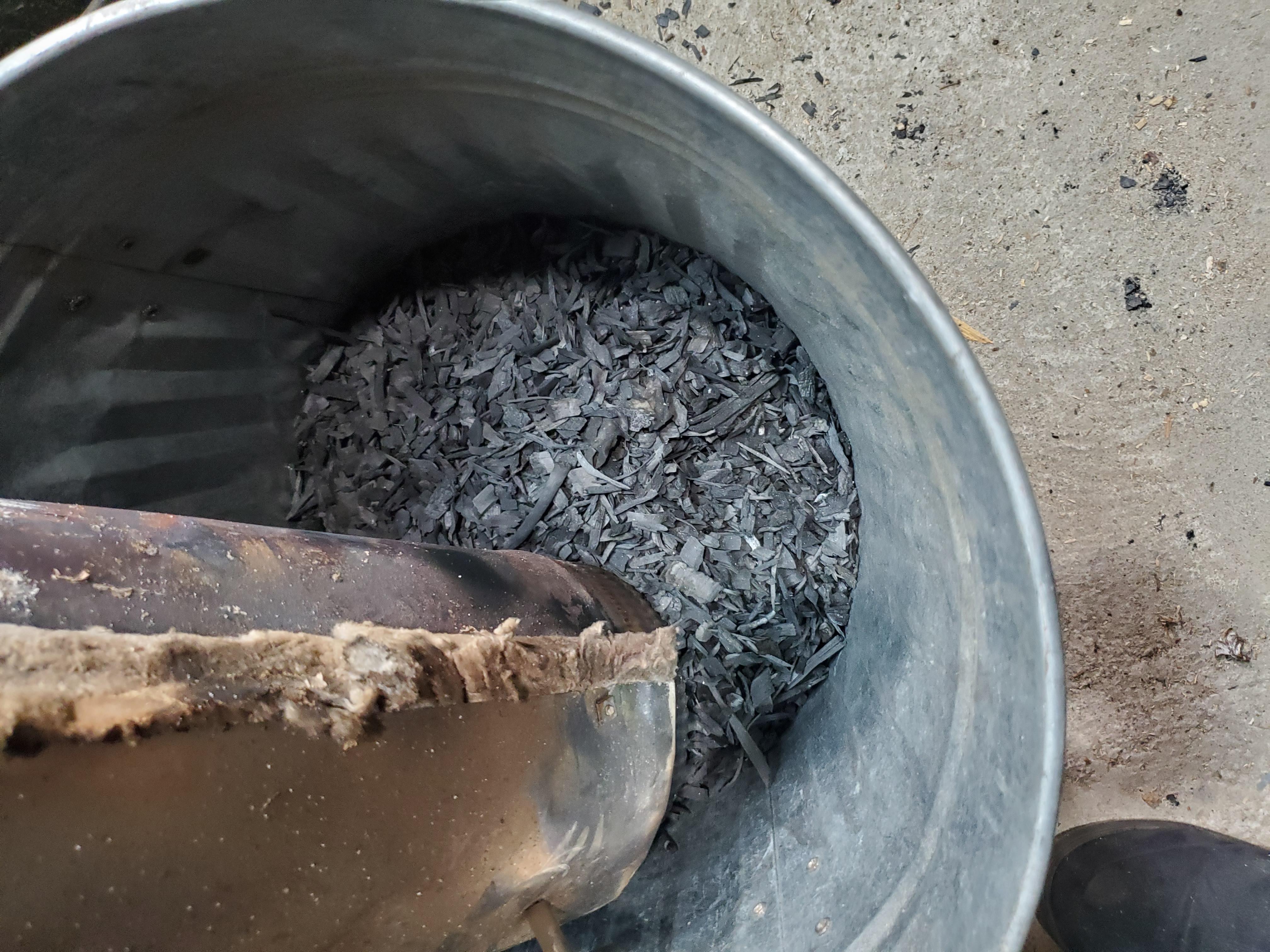

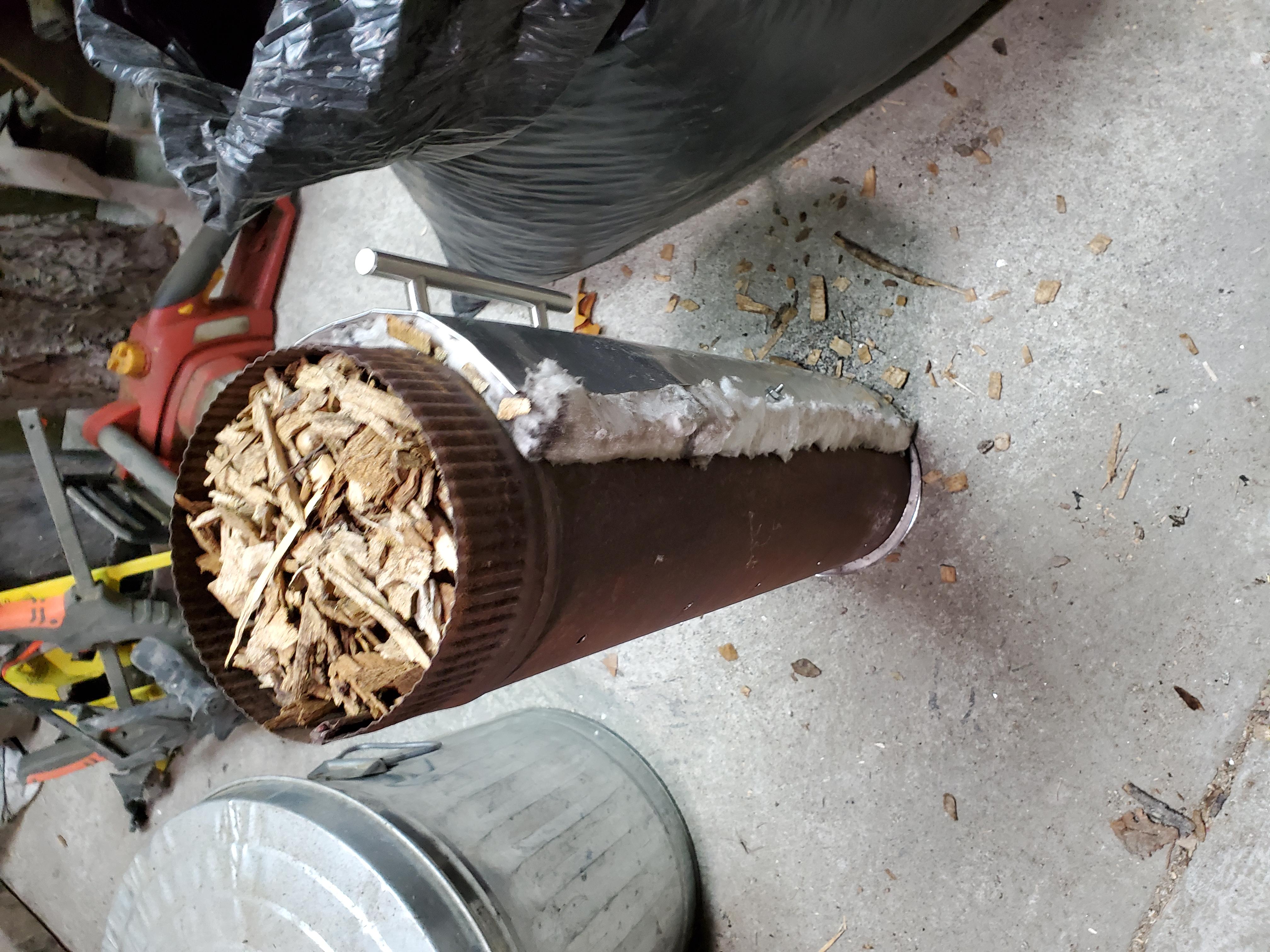

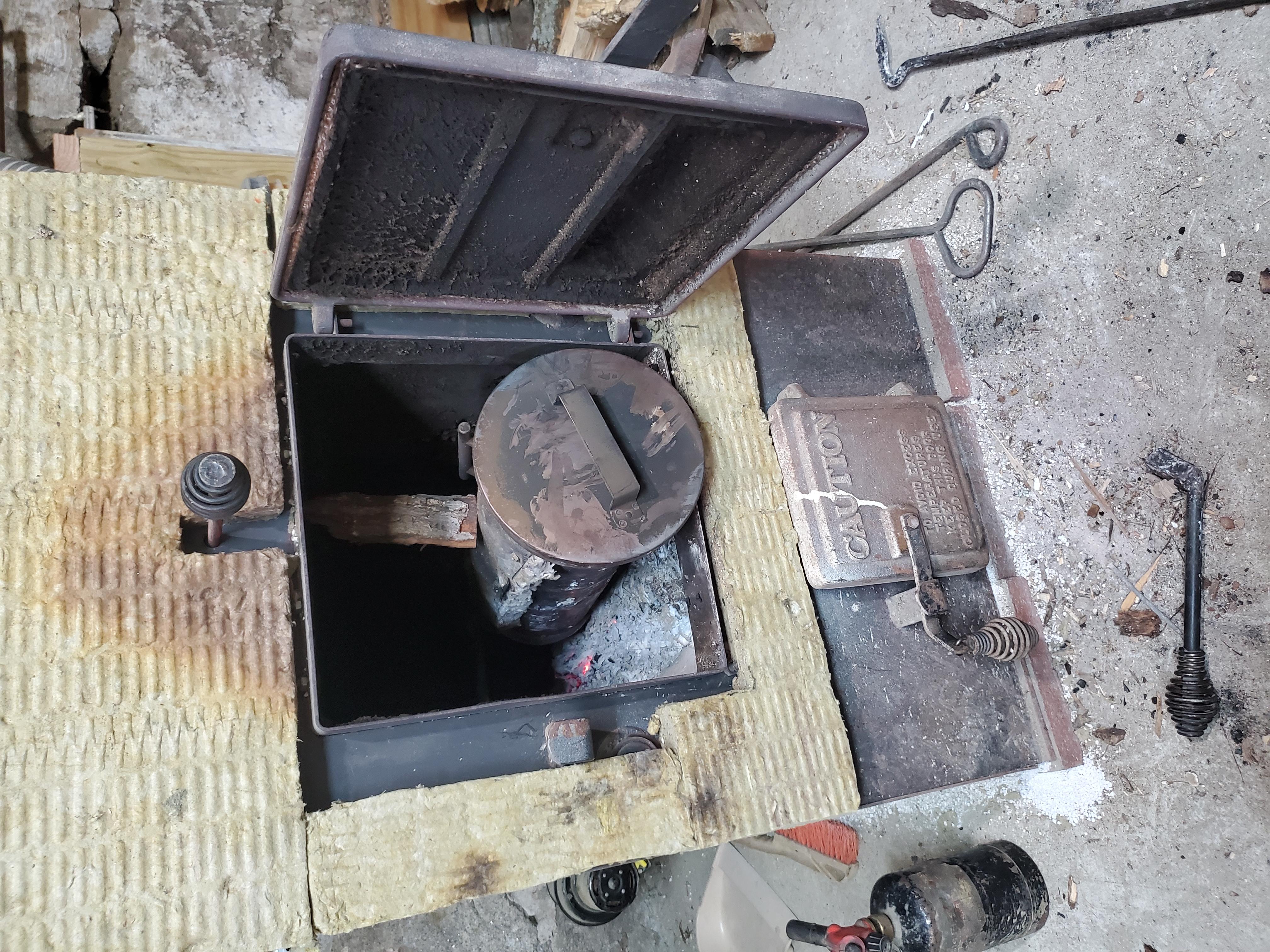

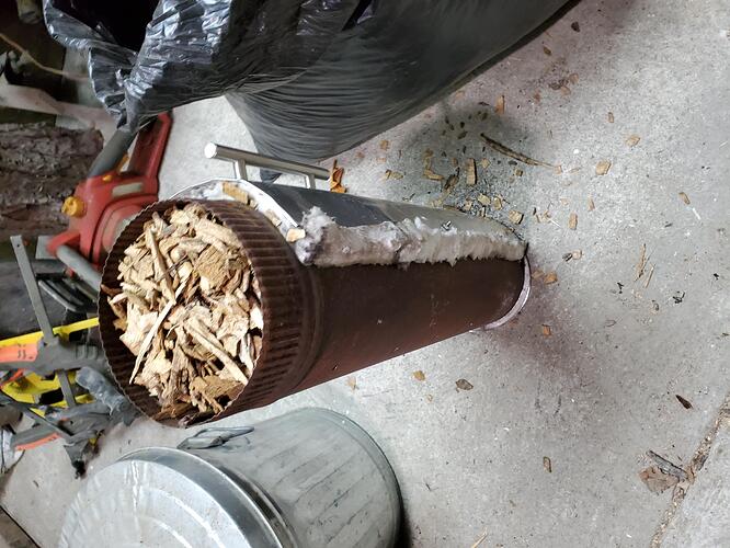

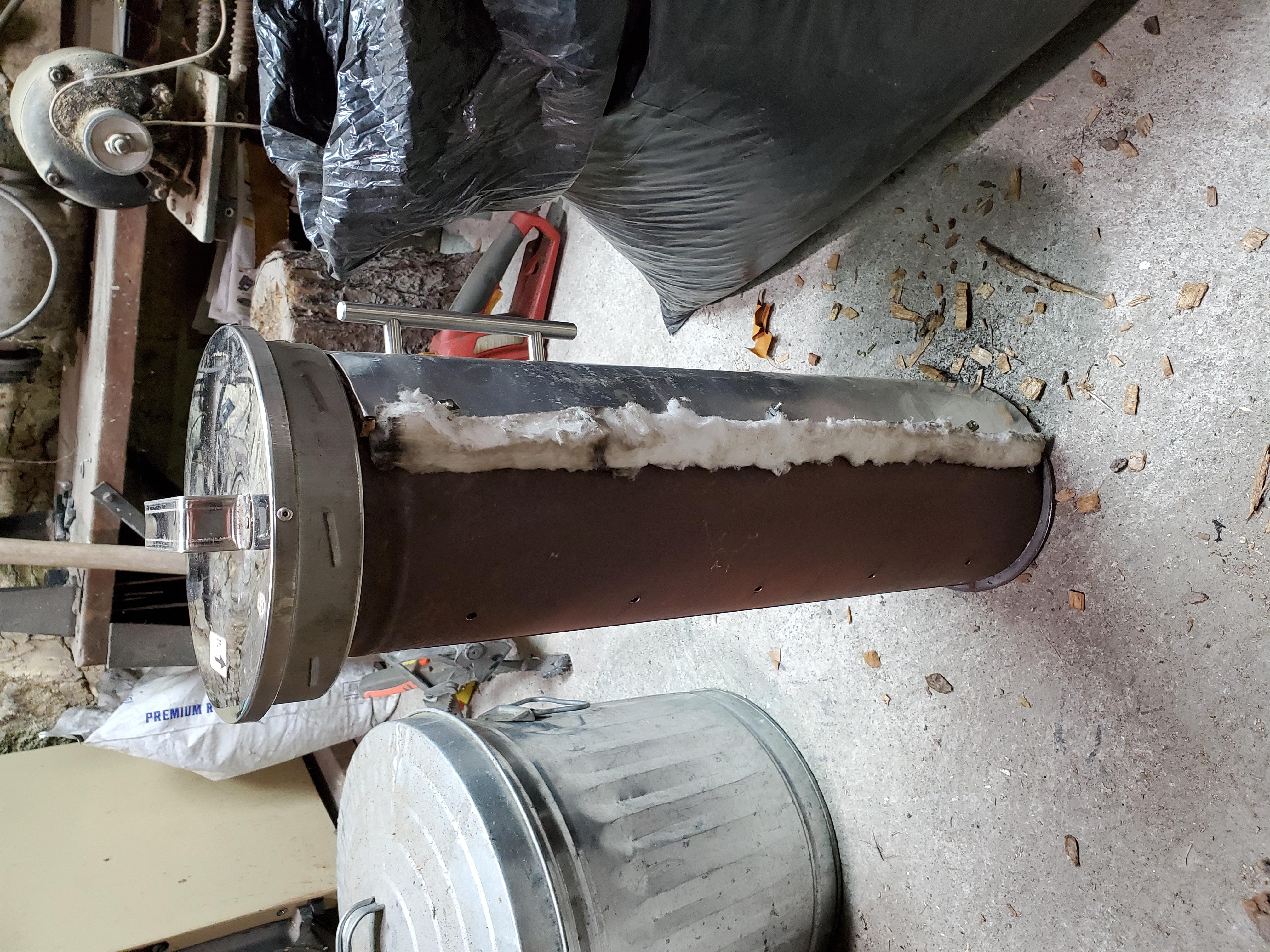

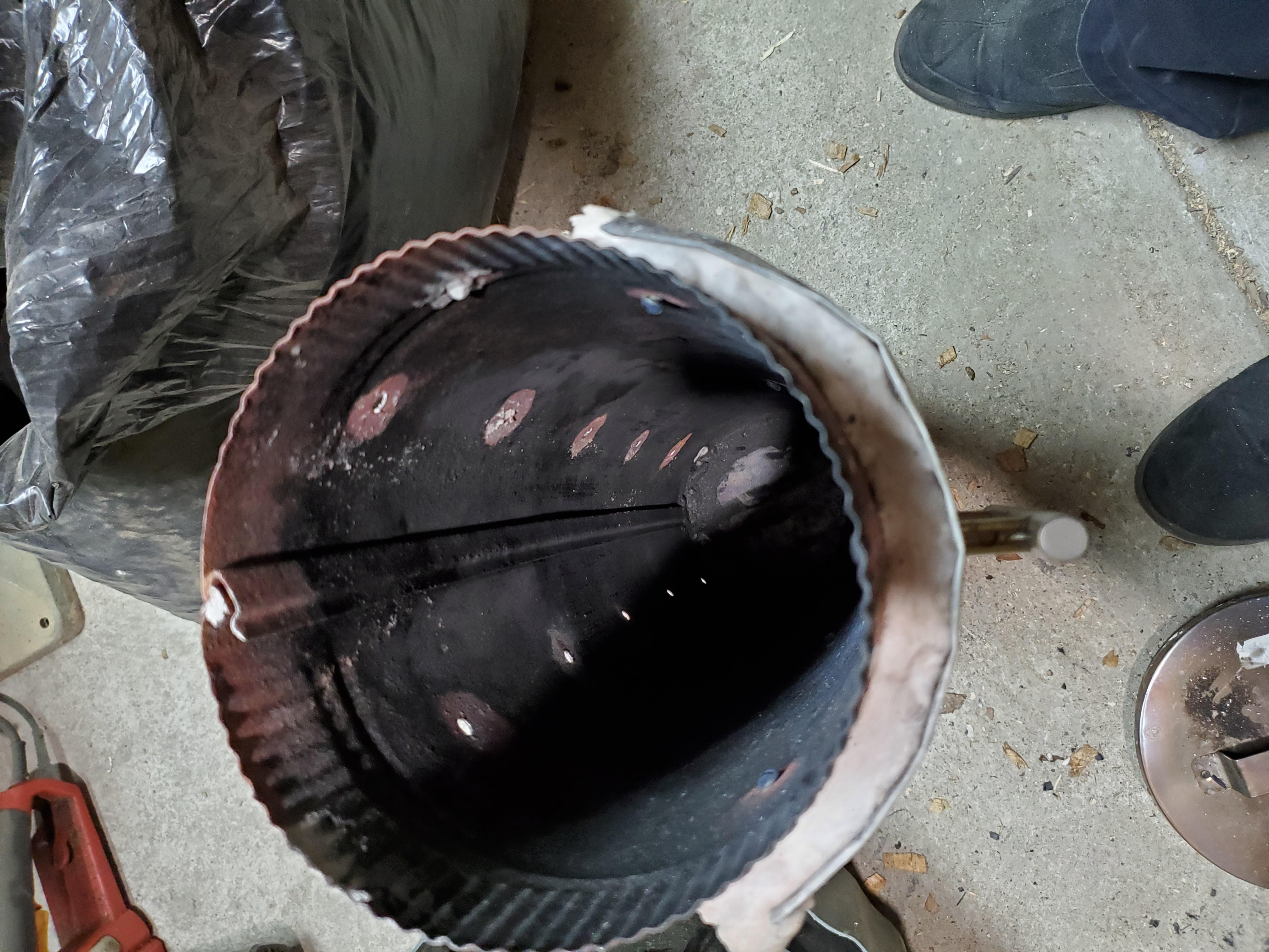

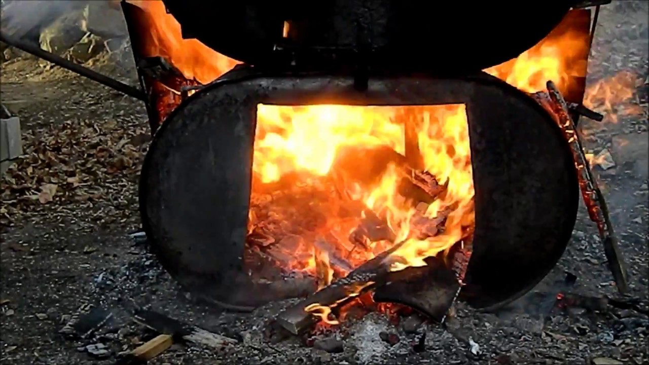

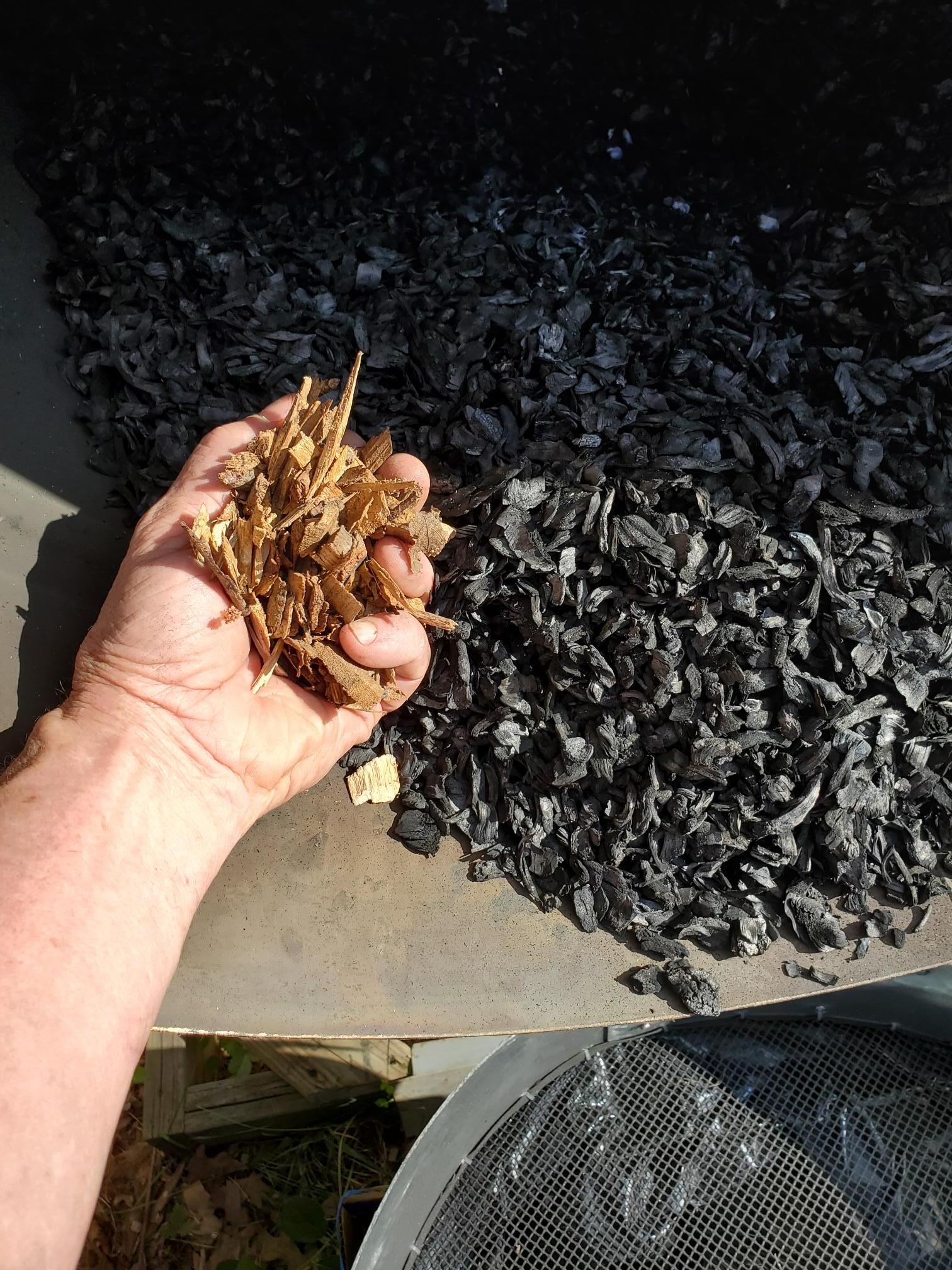

My latest charcoal maker. Hardwood chips are delivered free from tree removal company. I screen dried chips between 1" and 3/8" screens.
Stovepipe Retort
Top half insulated
Gas exit holes
Boiler firebox
Engine fuel

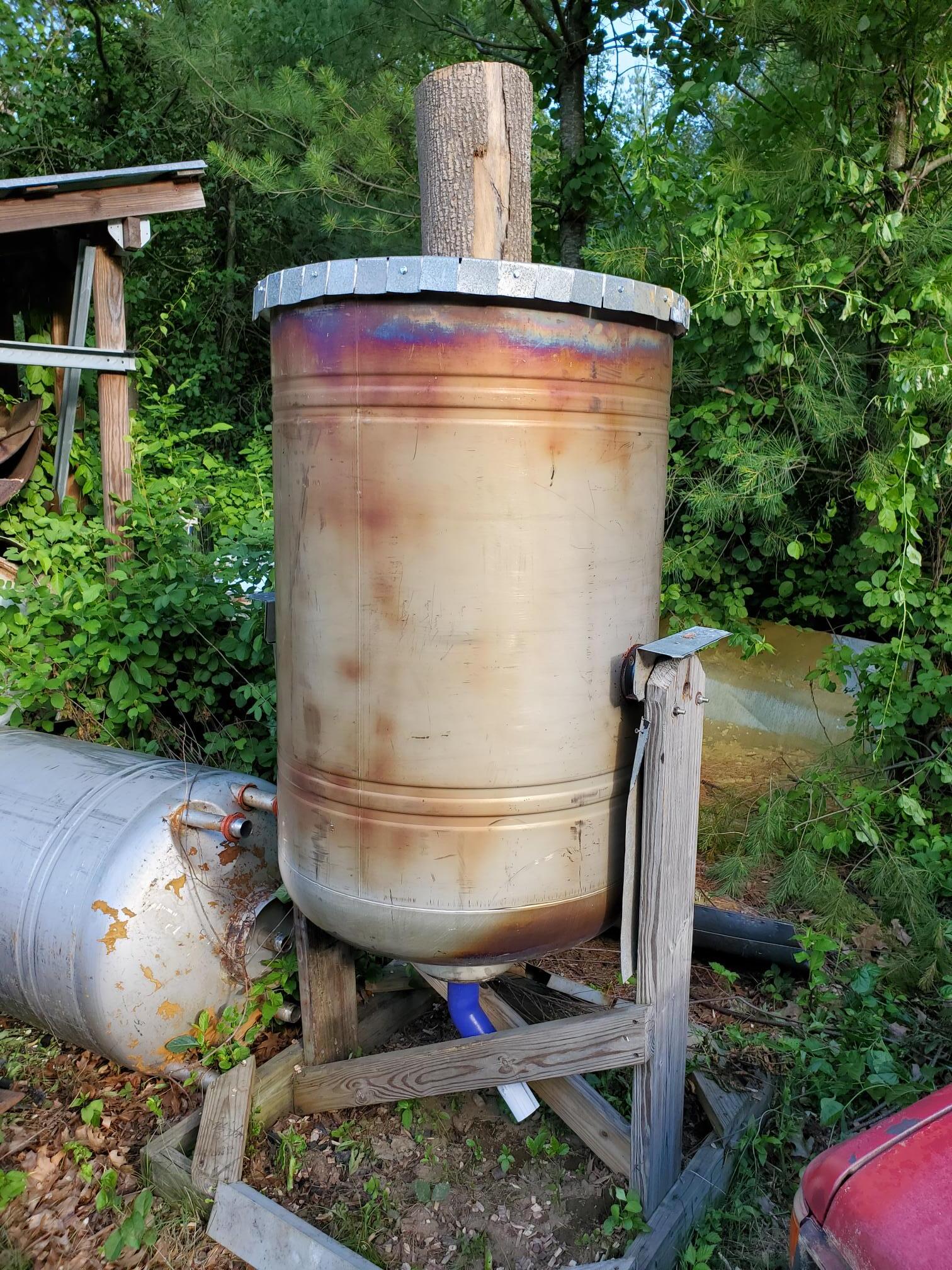

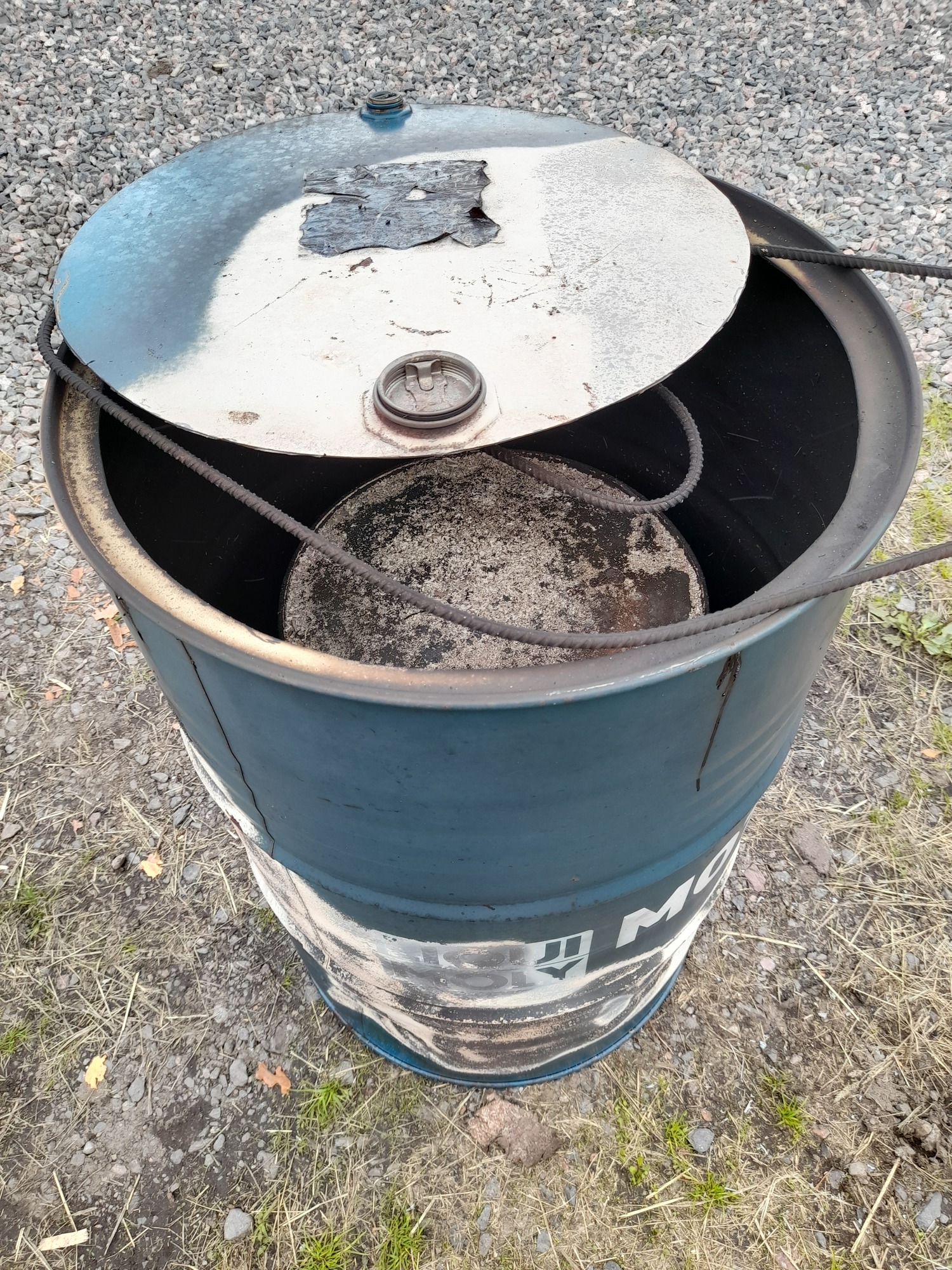

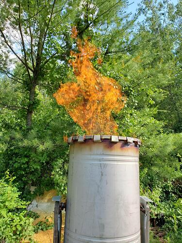

Here is a giant 100 gallon TLUD. No smoke 1 hour and 10 minutes burn time.
That is very impressive, you could almost put another tank above it with all that heat coming of the top. The forced air on the bottom would really speed up the time.
That’s a great looking retort Bruce , you should manage a few miles on each load .

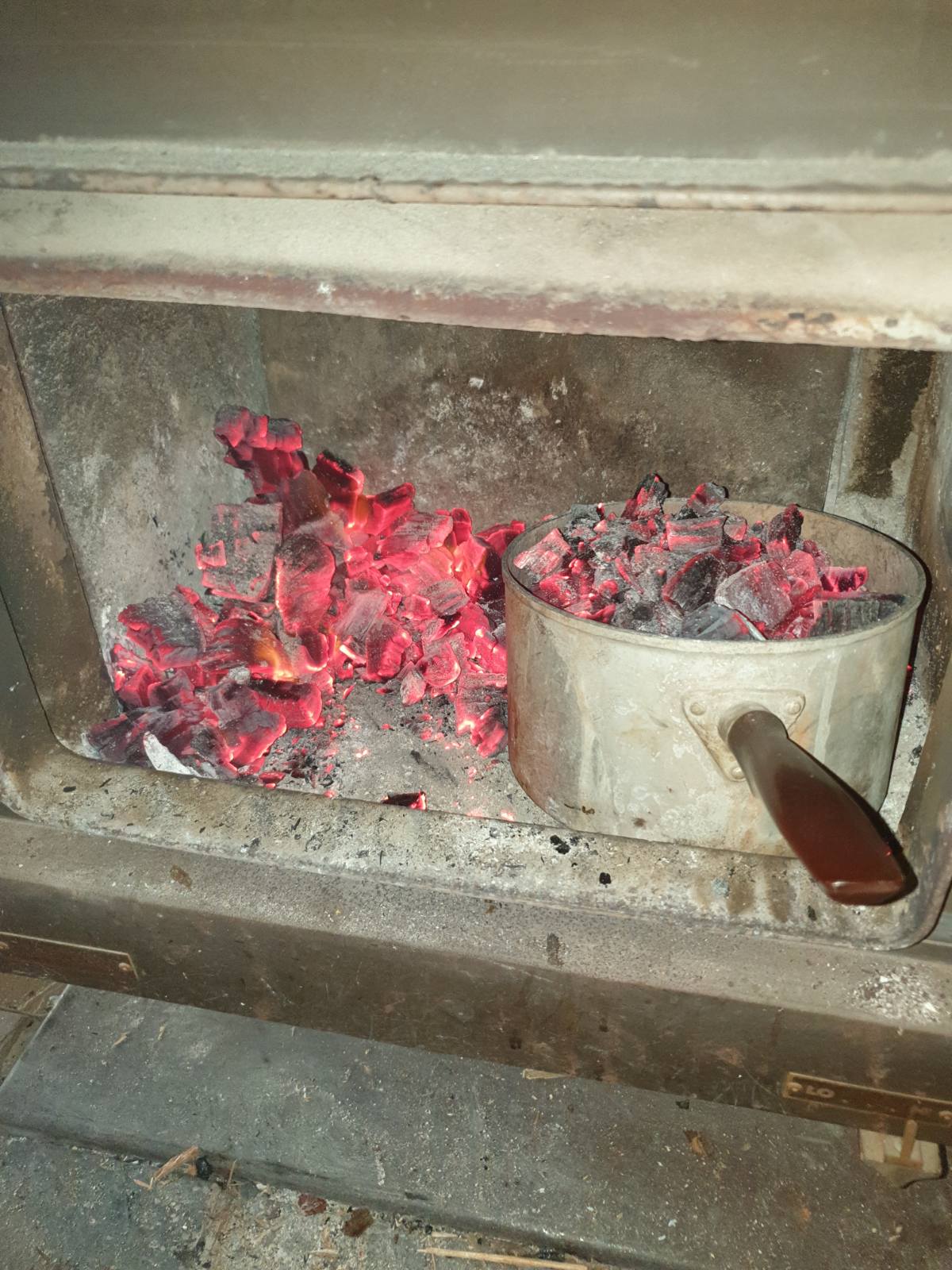

I get 2 saucepan’s full of charcoal every load and the embers i leave will start the process all over again .

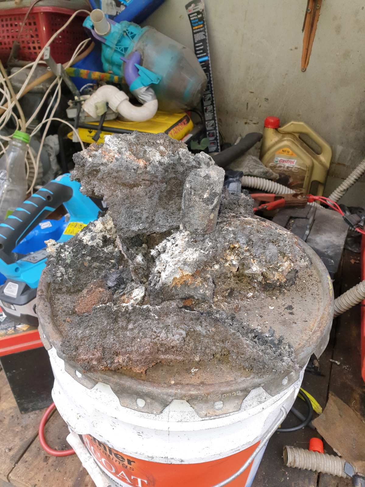

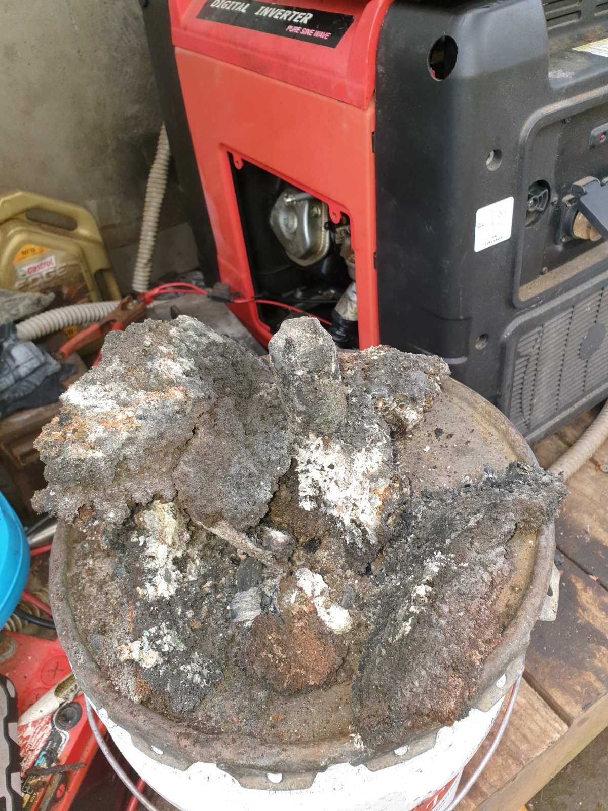

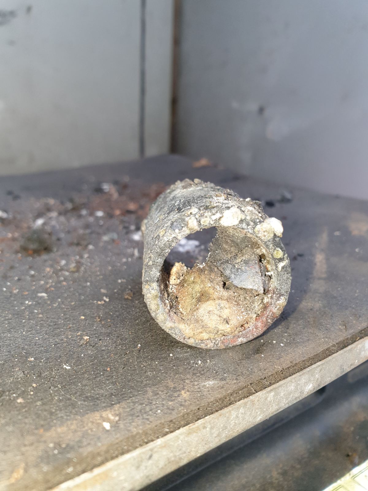

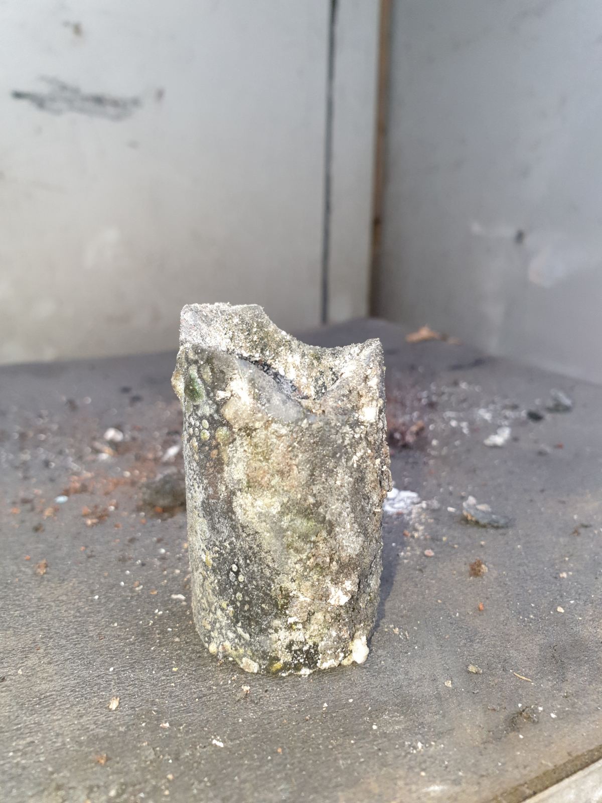

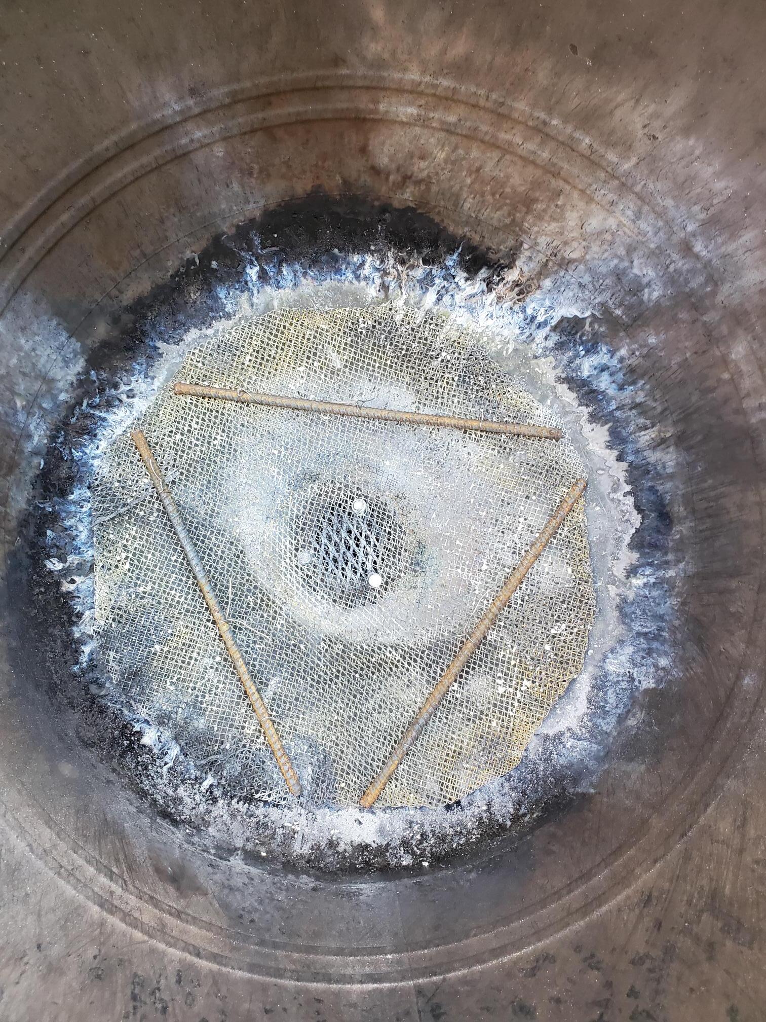

I decided the day after the power came back on that i would clean out the gasifier and check the nozzle, crikey what a mess inside , i really ran the generator hard this week and so i have a lot more crumbly slag that broke off the nozzle without trying too hard at all , plus i seem to have a lot more build up on the inside and out side of the nozzle , maybe i should think of getting a few more sent over when i have some spare cash .

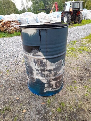

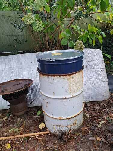

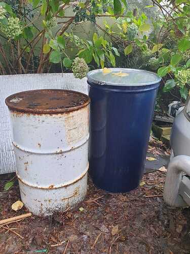

I have found a supply of really nice standard 200 litre and also tall but slightly smaller diameter drums with locking rings that will fit inside a standard 200 L/ 45 gall drum .
Hexaloy carbide nozzle still useable the broken edge was from me poking at a while ago trying to clear the slag from the Centre
Not sure of the last time i cleaned out the gasifier must have been a while back though .
I’d say it held up pretty well for some hard use and abuse in a grid down situation!
Did I mention that I bought three more of those hexaloy nozzles. I didn’t even open the box to see if they were the same size yet. I figure I can make a simple fire out of almost anything laying around but nozzles, not so much. Maybe I should order more. I’ve been real careful poking anything through the one I’m using.

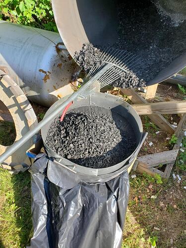

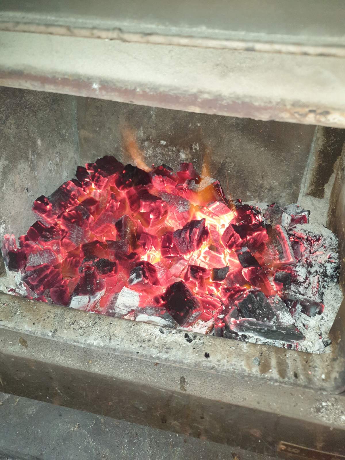

Bruce, How many pounds of charcoal does this system produce per load?
Bryan,
I don’t know about pounds, but about 40 gallons per load.
Now that is really harvesting the energy… you get the energy heating the boiler, and the charcoal to run your engine, well done.

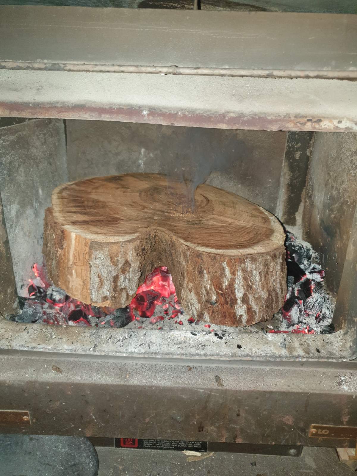

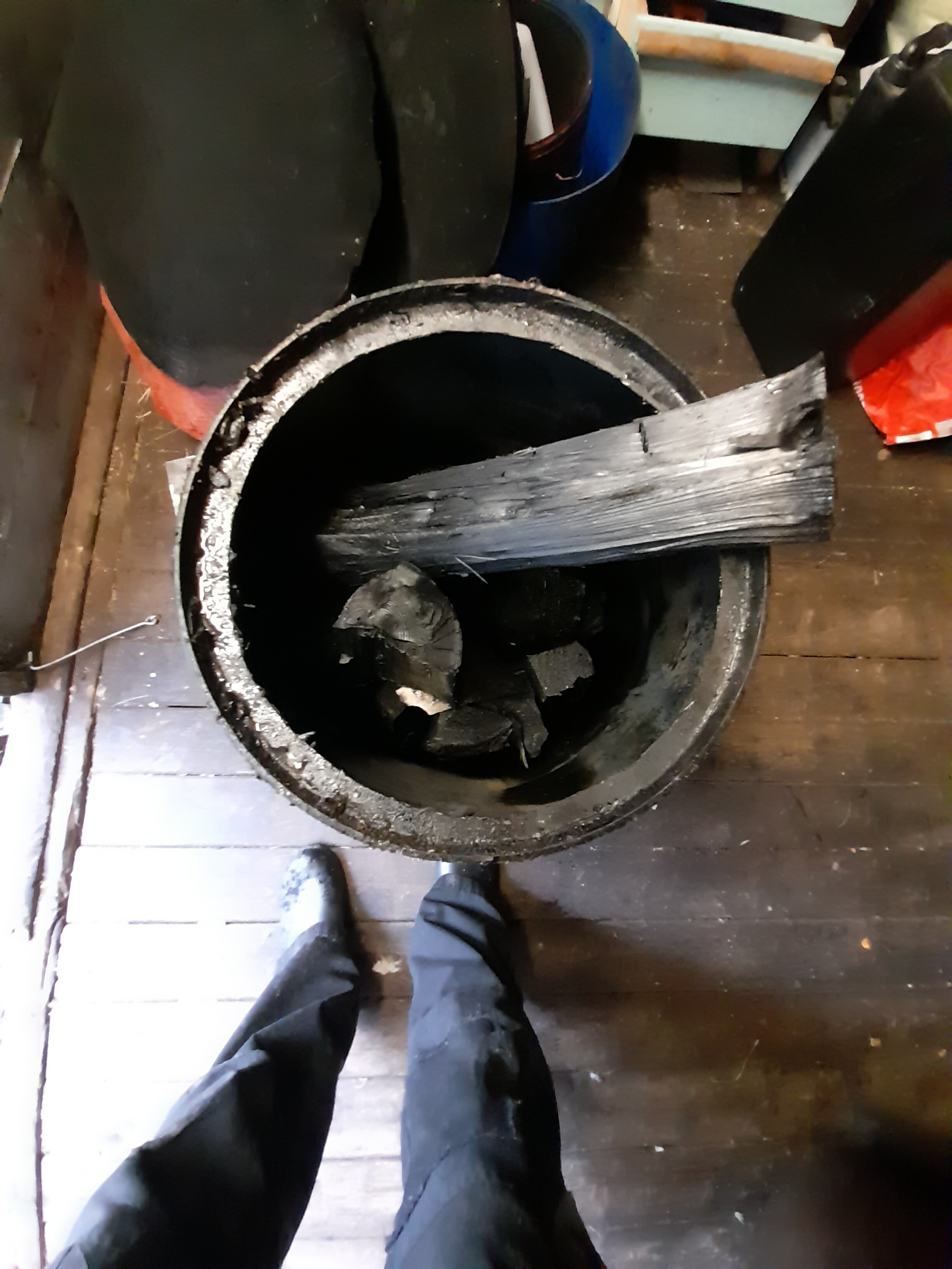

Tried to make charcoal, quite simple, but worked well.
