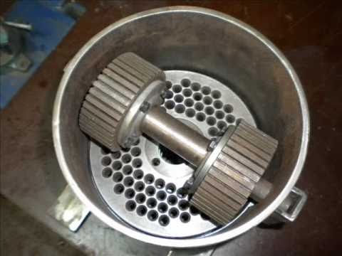

Matt, l know how a matrix disc pelletmill works, l hava seen meople DIY it, but what is a ramrod press? How does it operate?
Sawdust isnt free here, but its not so pricey either. I wuld love to have a press my self.
Im sure there is name for this type of mill, but I dont know what they would be called. But basically its just a hardened steal rod tha reciprocates in a diy its a bit slower of a process vs the disc type. Ill see if I cant find a video.
Well once again I think this may turn into a new topic for discussion. But I can certainly build this pellet mill. How thick do you think that plate needs to be. I know the good mills are hardened steel but his looks like he has a fairly thin die plate?
Not sure on the thickness, all l know is the holes are first conical then stright thain conical again. Once the plate wears out on one side it can be fliped around.
A company sells these matrix discs, at about 100$ a peace, but p dont remember the name of it anymore.
If you get to it, plese post your findings
The rolers need to have a rough surface to them and thats about it.

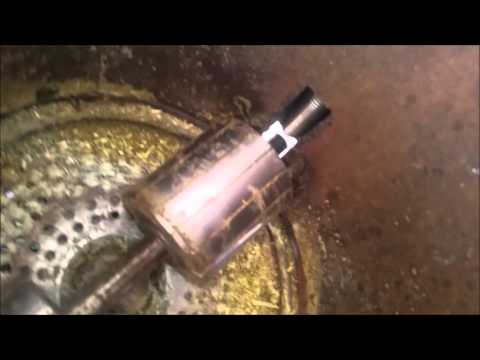

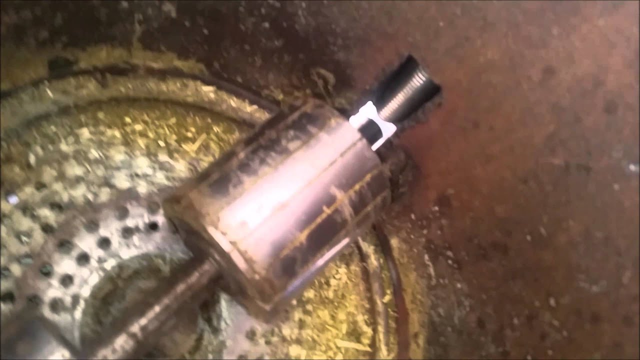

Yeah Ive been racking my brain and watching more videos and already come up with a design. For the roller you can use “gear belt pulleys” already grooved. For the disc I can order the stock and what Ill do is cut out a template on the plasma CNC to locate my hole pattern on the plate. Most others I found look like they have very thick plates, so im going to go with a 1" thick plate. Yeah I sean the good ones have a counter bore on the holes. To keep it cheap Im just going to use brass bushings with a grease system. If it really needs solid bearings Ill upgrade it later.
Here is a good DIY build.
For a slow rpm mill brass bushings with enough lubrications shuld work just fine.
I think l read ball bearings on the rolers have a quite short service life (150h?)
Yup I can see that, bearings do not fare well when shocked. I cant imagine that is a smooth ride inside there.
Good video! Pellets look wery nice!
I wonder thugh isnt a stationary matrix with rotateing rolers easyer to make?
I would think spinning the plate instead and having the rollers stationary on the shaft would be stronger. Setting up the rollers on a spinning shaft might be more challenging to make strong.
True.
I allso wonder if the feedstock needs to be aded slowly to the press or is it dumped in all at once and the roller takes all they can handle.
