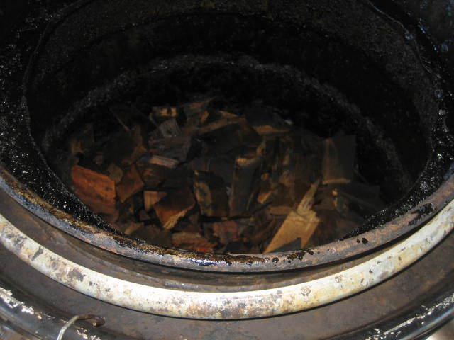

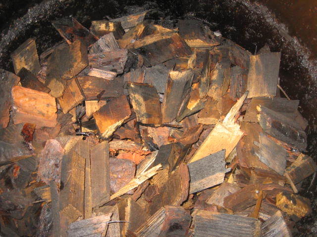

If I have a quantity of wood left in the gasifier at shut down it will radiate heat also for 2-3 hours and at next start up I will have collected condensation . Maybe up to a half gallon . The start up will be just as fast as the above . The only burden lighting with this quantity of wood is getting the fire down to the char bed. In this case I feel the heat left after shut down did not go to waste but aided in drying the fuel. ( note . the the very top layer of wood will be moist)
I took the below pictures yesterday as I was firing up . I think the hopper is 1/2 to 2/3 full. Very fast start up and plenty of power:relaxed:
