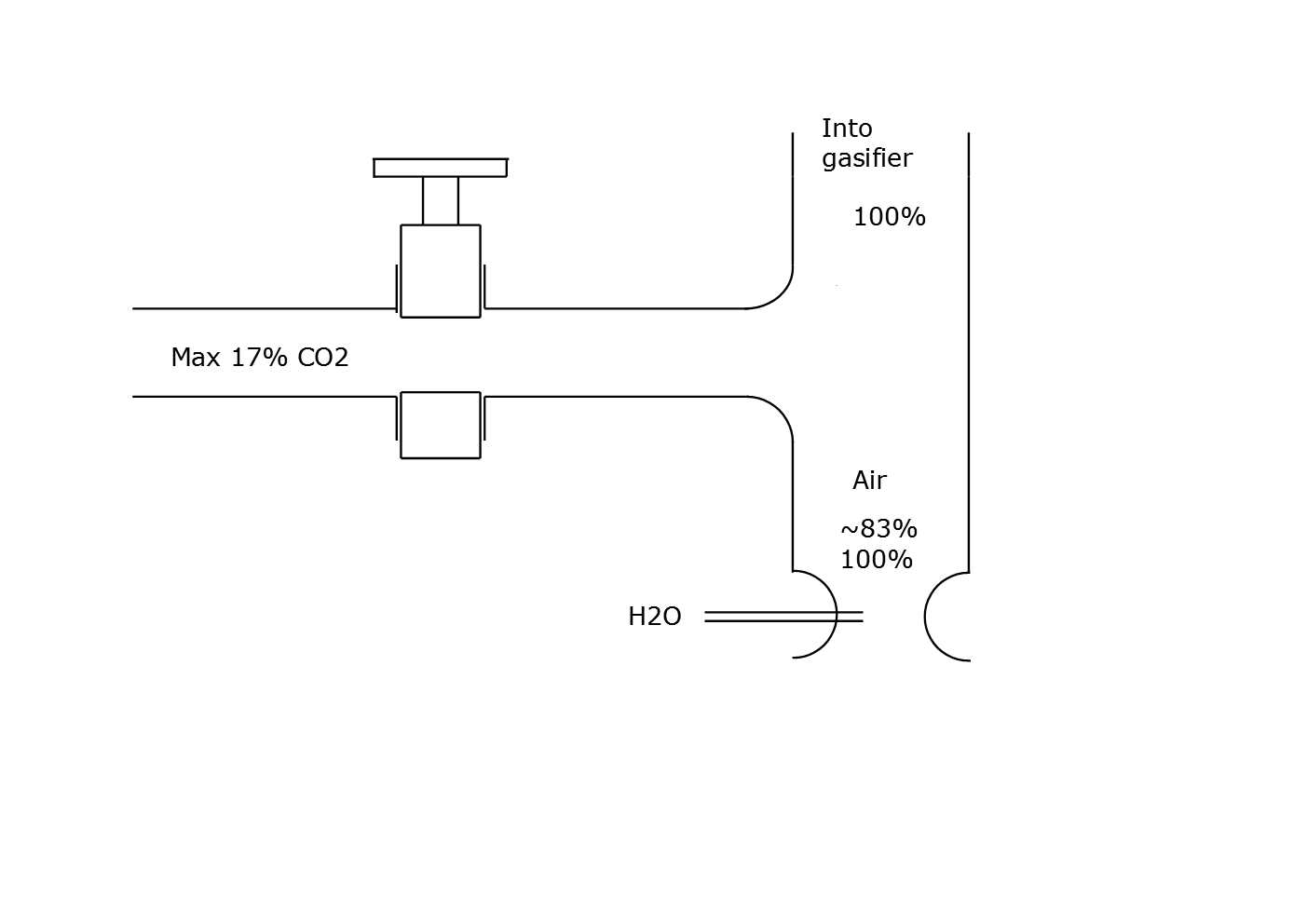

I was thinking to make a system lyke this
1 air intake
2 air valve
3 exhaust valve
4 water carburator
5 gasifier
l think a 50ccm moped carburator shuld do the job as i am only going to put a litle water in the air stream
Hope is makes sence to you the skech is just a fast drawn one :slightly_smiling:
Thank you for the drawing. Now I can go back and understand what Max is talking about TomC

Max; I hope no misunderstandings because I respect your ingenuity. I do have trouble “visualizing” your “verbal” descriptions. I try to sketch out what I understand you to be saying. Some time back I posted a drawing of what I thought you were telling us would make a good gasifying system for cold weather. I have another laying on the table next to me that says “Charcoal Gasifier Nozzle” per Max. And then there was the one I recently posted that you tell me you had nothing to do with. I would not work at these drawings if I didn’t have respect for the information you try to give us.TomC
