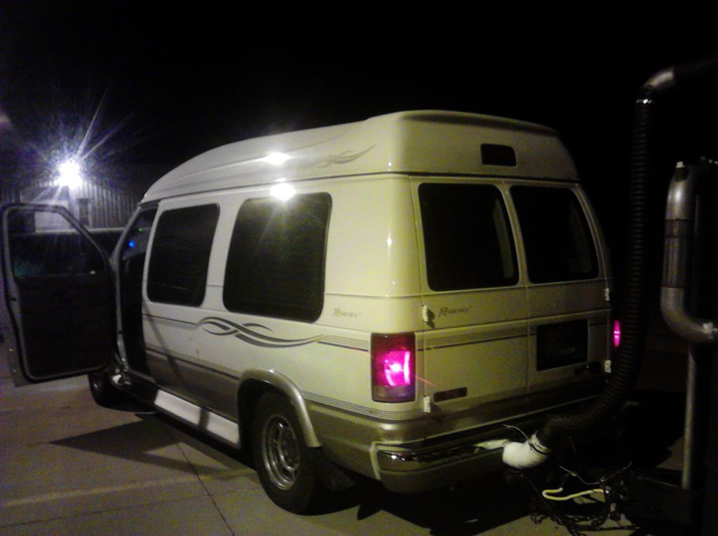

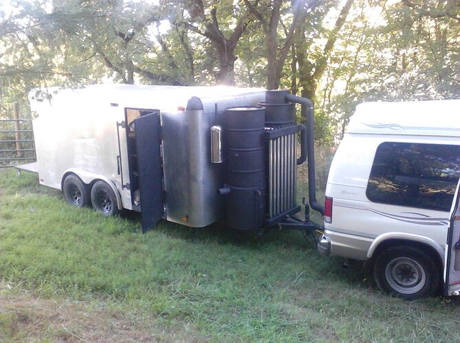

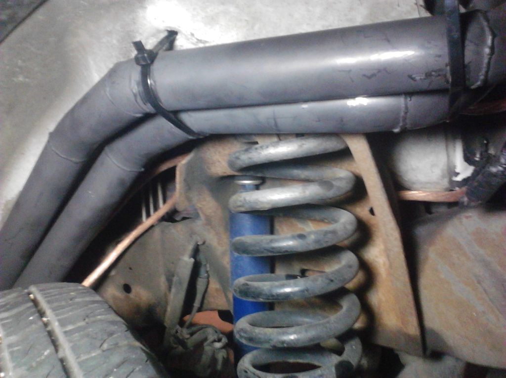

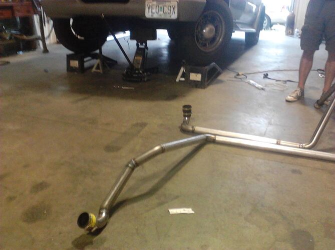

What kind of flexible ducting are you using to bring the gas down from your unit to the van?
Hi Arvid O, not sure the exact name of brand, but it’s a sturdy industrial type 4 inch flex hose, I think it was around a hundred bucks for ten feet.

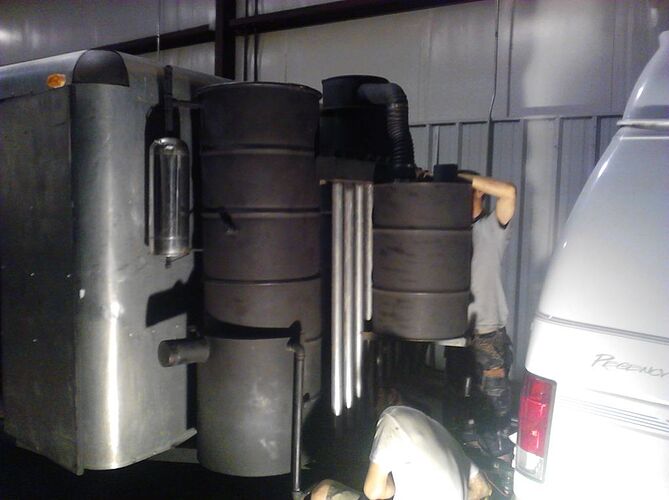

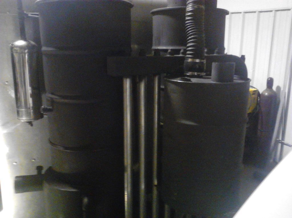

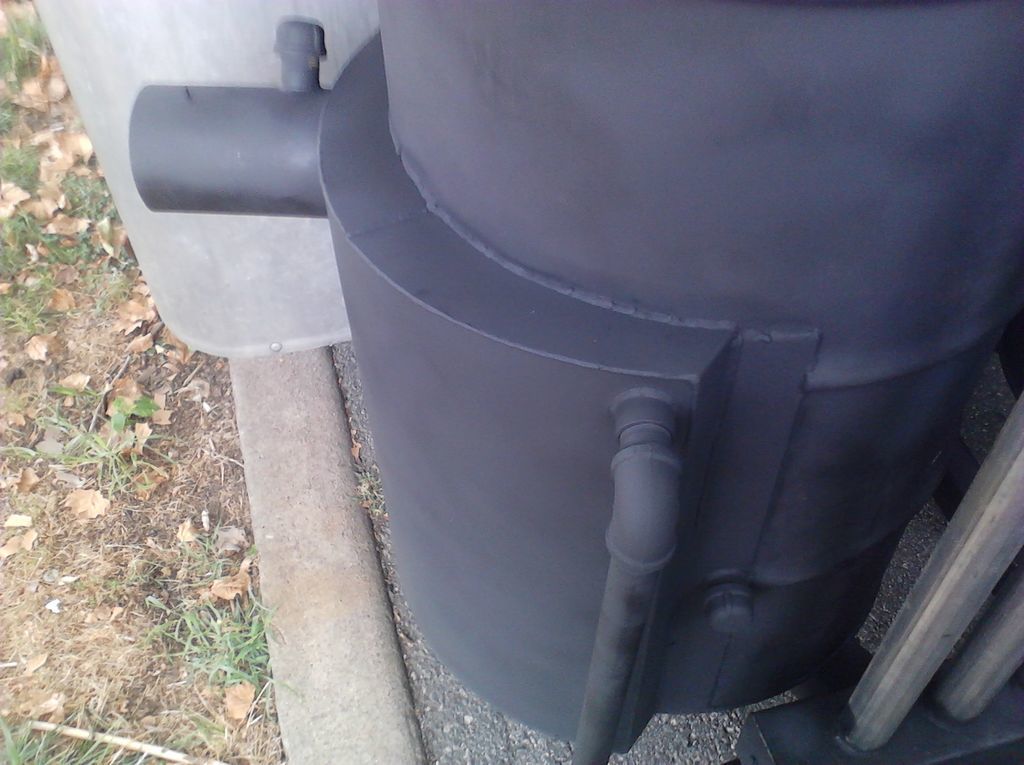

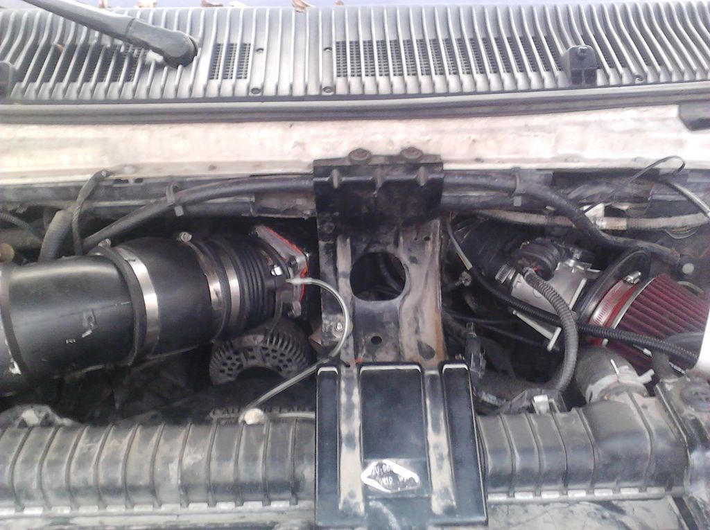

Here is a pic that shows the air heater/Pederic improvement, and exhaust input, Justin gets much higher mileage with the improvements along with lower heat losses. NO GLOWING, the system is running strong!

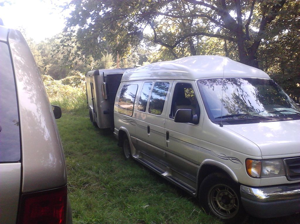

We went on a ride the other night left at 9:00 and returned and 4:30, long drive, was a lot of fun, added a pic of our return.

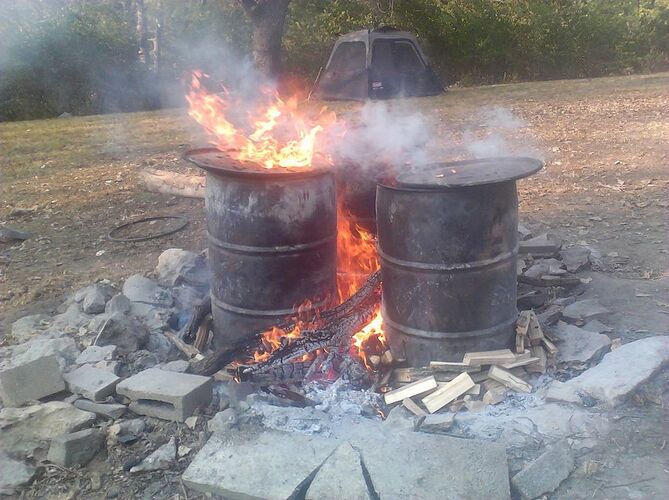

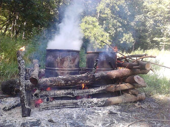

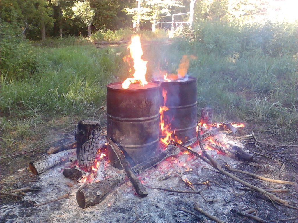

We have been busy here, making charcoal fuel today. We are getting ready for Justin’s trip to Maryland. A lot of Charcoal will be needed for this trip!
Hello,

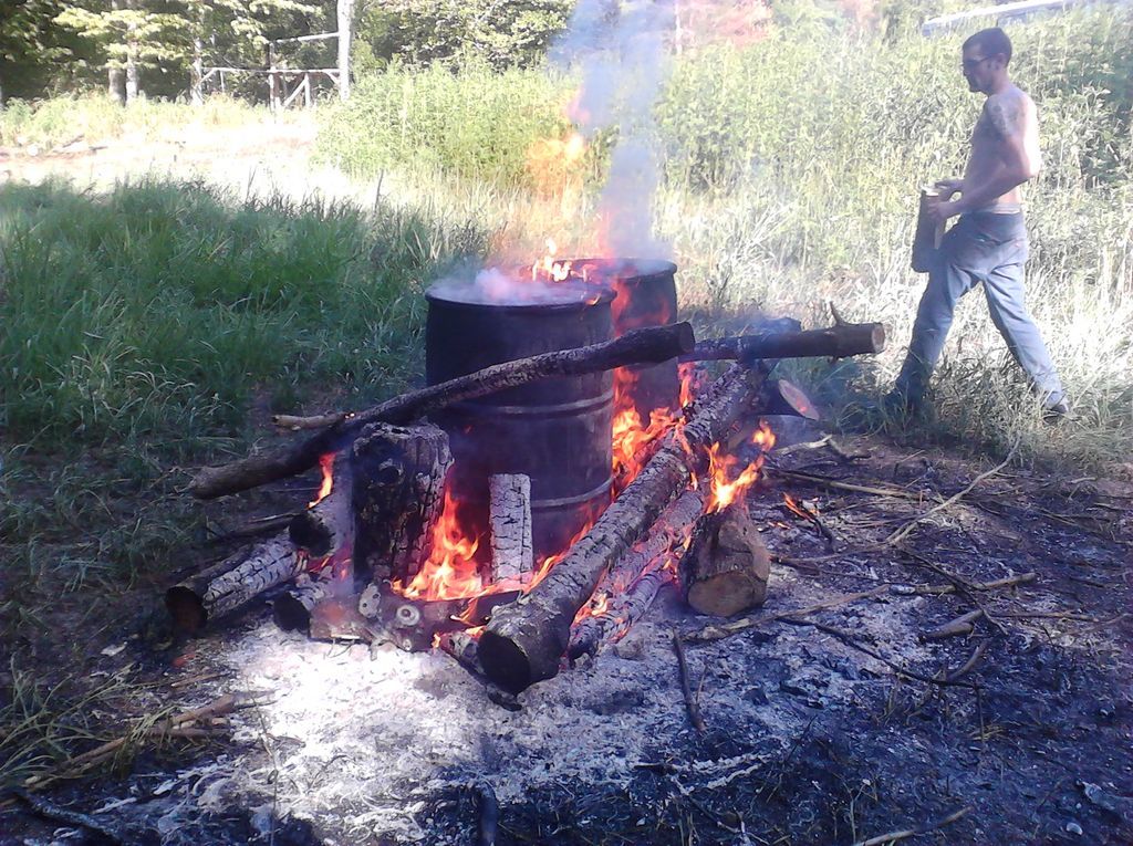

Did you have air holes in the barrels or just use the heat from the outside logs to turn the wood into charcoal?
What is the typical turn down of a barrel of wood for you?
Do you get 1/2 a barrel of charcoal to a barrel of wood?
How are you screening it or are you screening it?

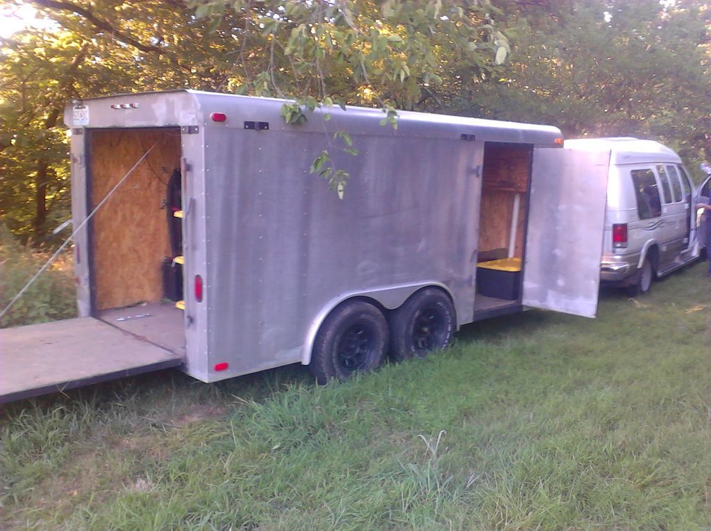

That is a nice trailer and impressive that the van can haul it.

Hi AnthonyM, Thanks for the comment
We distill the gases out the top and keep flame out of the inside of the barrel. It can vary how much is charcoal is made, normally it only cooks down 25% or so. We use it all, not choosey a bit.

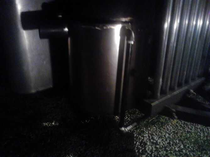

We added a large bubbler, filled with Veggie oil for extra soot filtration.You can hear it work. If you get close to it while its running, It sounds like a, well…
We took one more trip small trip to Columbia MO in the van before sending Justin on his way to Maryland US, He is going to work at a Renaissance Fair up there for the end of Summer. Nothing but camping, dressing like a pirate and yelling at kids to shoot crossbows. A great job, sounds like a fun time!

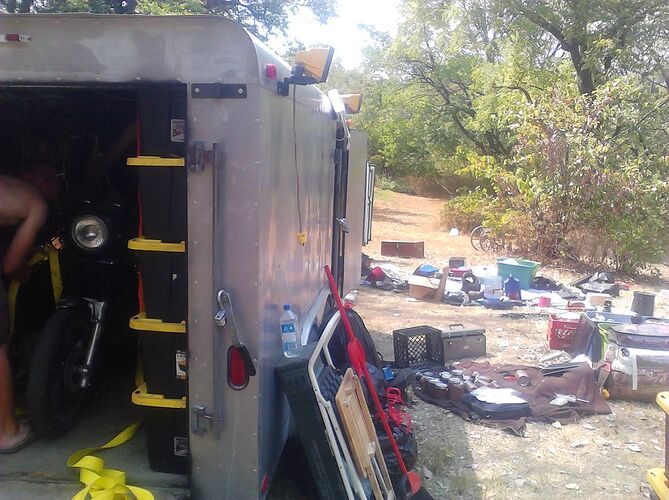

JustinA and his buddy ChrisT packed up all their gear in the trailer/van and headed out today. They took literally tons of stuff with them, practically his entire apartment.
I am amazed how powerful gasification is! After fine tuning his system, he cruses 70 mph on the flats and 60 plus up hills with ease. I cant tell hardly if any, difference between gasoline. His rig is heavy, Runs Smooth and strong!
This setup was designed for highway hauling.
He called me outside of St Louis tonight and said they were having a blast and going strong. Whew! Good luck Justin,

Good detailing and pictures. You will have to look into ChrisKY’s centrifugal oil cleaner to clean his bubbler oil. I also put up linked info to James Hookway’s charcoal making retort in Gary’s Charcoal corner. I think it would be portable and Urban capable.

This project is really fantastic.  I can’t believe the scale and power of this thing.  You changed the air input to something like the pederick plate.  Is it possible you could give more details?  Again awesome project.  I wish your buddy many happy miles on the road with this.
