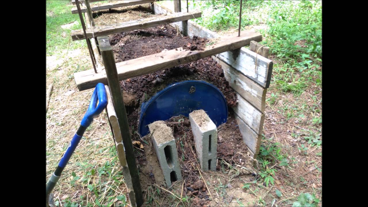

Key to making dense charcoal is heat the wood as slowly as possible. Heat it fast and the stean eacaping will produce a poppcorn effect.
I have watched a program on how some remote Japanese people on making their high quality charcoal used for heating and cooking. They cook it very slowly for hours in a open fire kiln. The charcoal comes out and tingles like glass. It is a art to make high quality charcoal.
very good point and observation.
Here’s one method, a bit more modern than other Japanese kilns. Iwasaki style. Intent is for blacksmithing charcoal.
The heat from the fire drafts through what becomes charcoal and out the opposite end. Not sure on the % full converted though.
