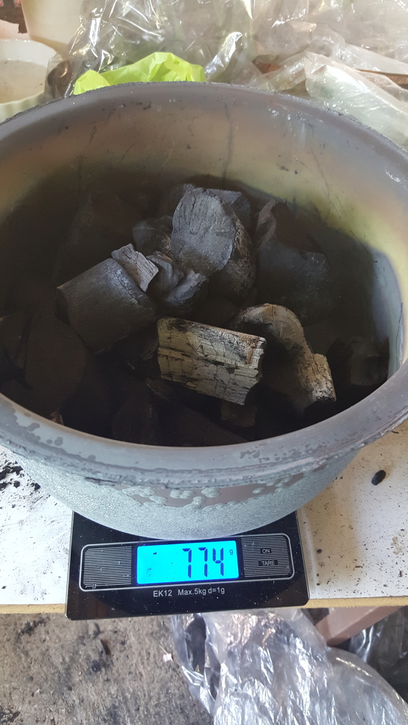

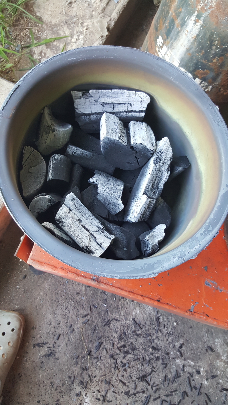

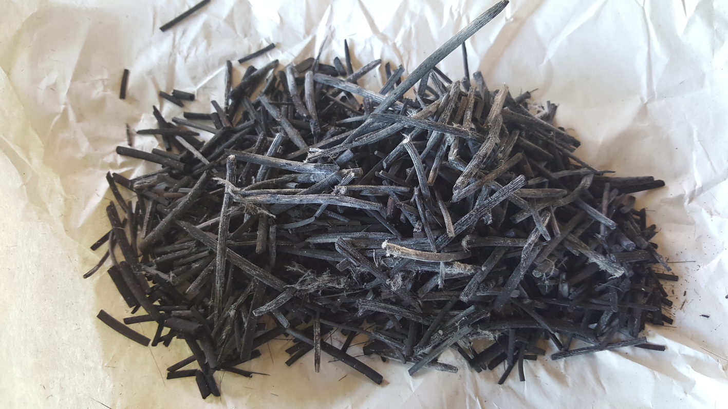

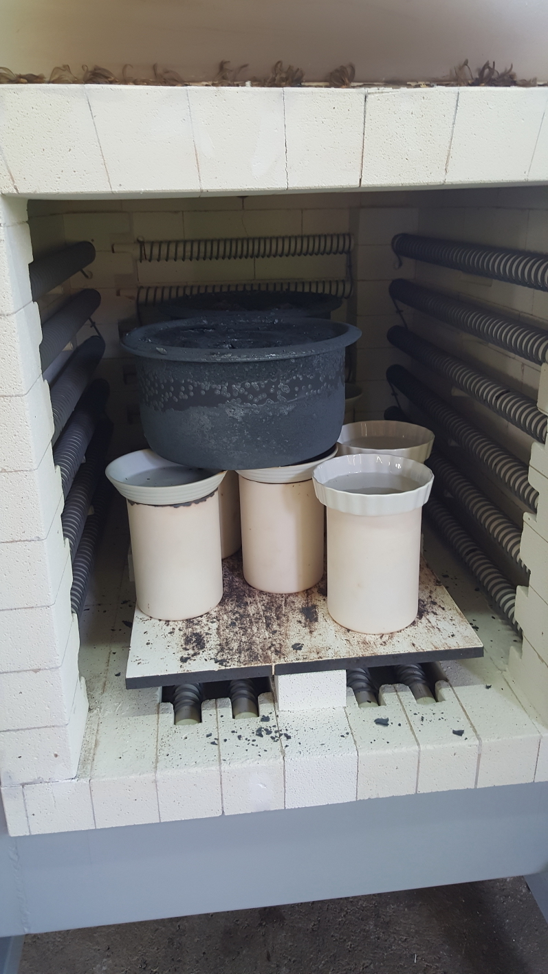

Latest test…

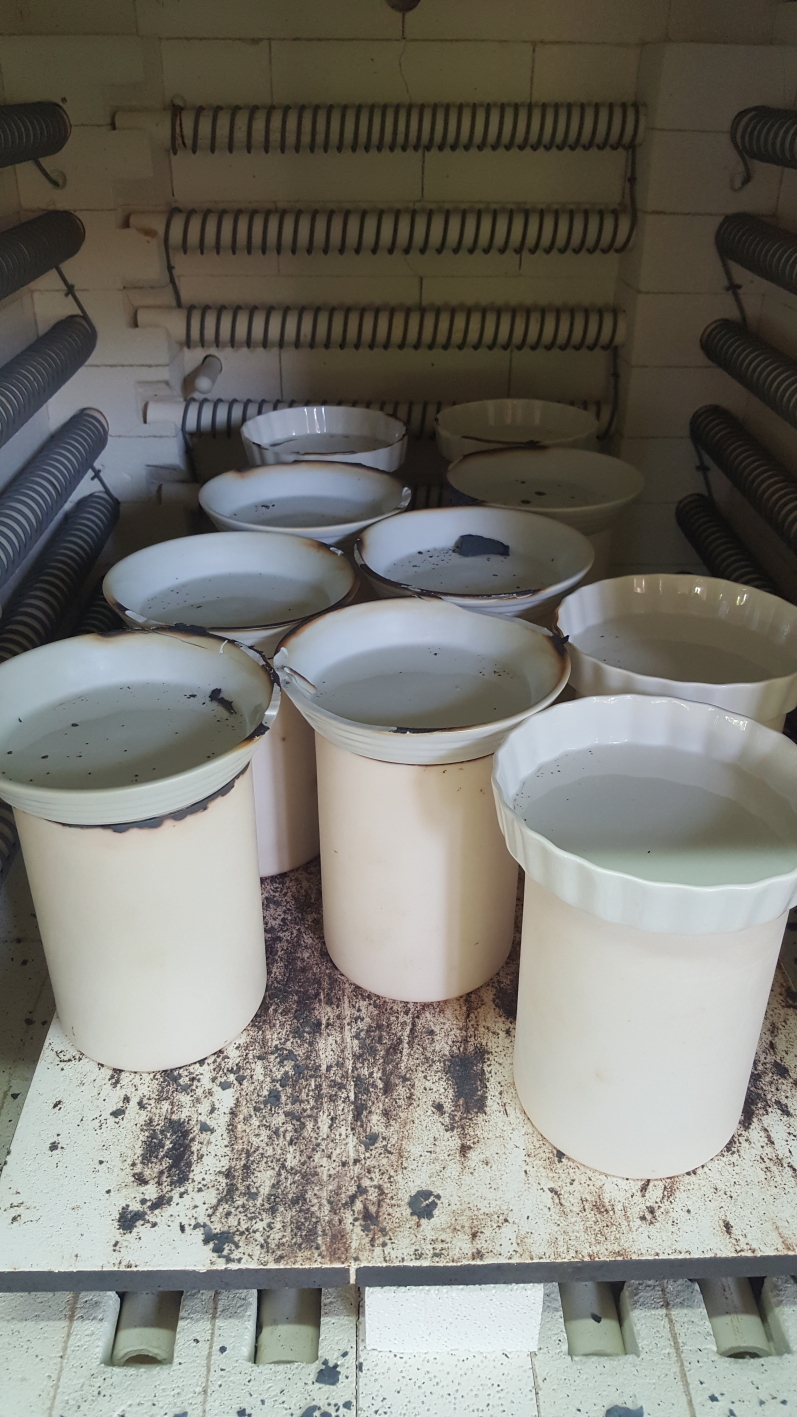

Samples exposed up to 1200°C
duration-sequence:
ambient to 650 degrees: 1 hour time frame ramp up
650 soaking time: 1 hour
650 to 1000 degrees: 1 hour ramp up
1000 soaking time: 3 hours
1000 to 1200 degrees: 1 hour ramp up
1200 degrees soaking time: 3 hours
cool down time 48 hours

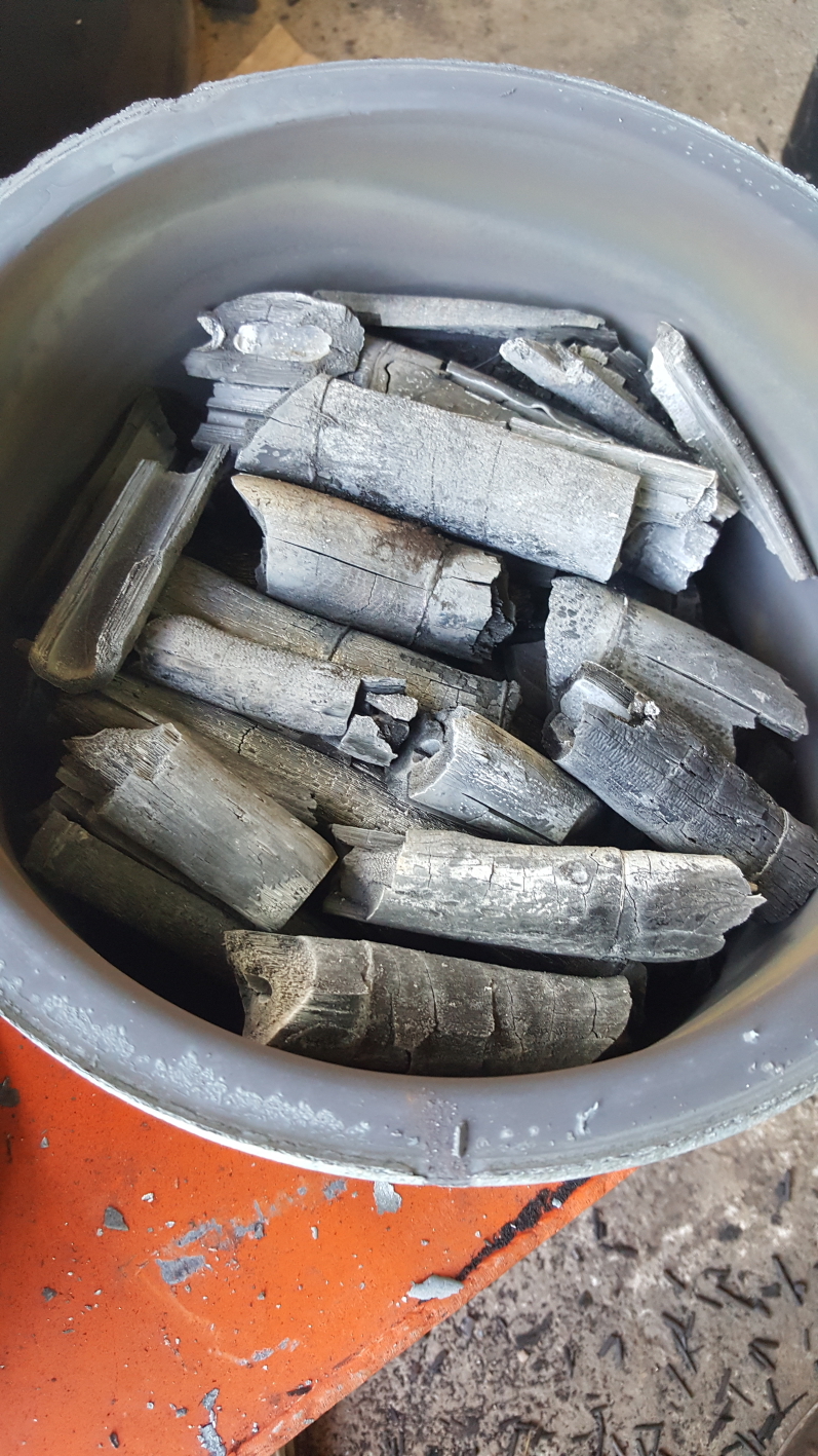

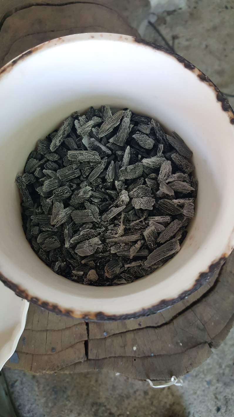

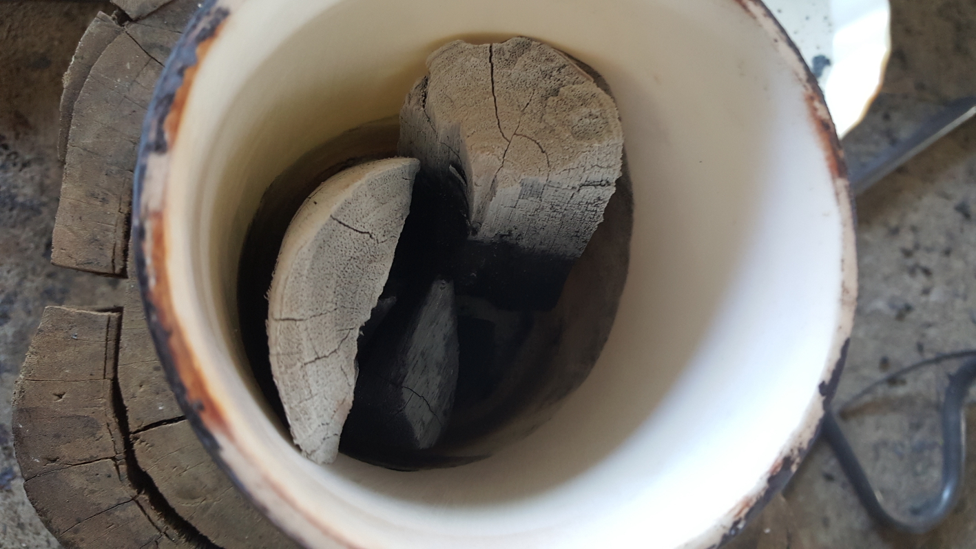

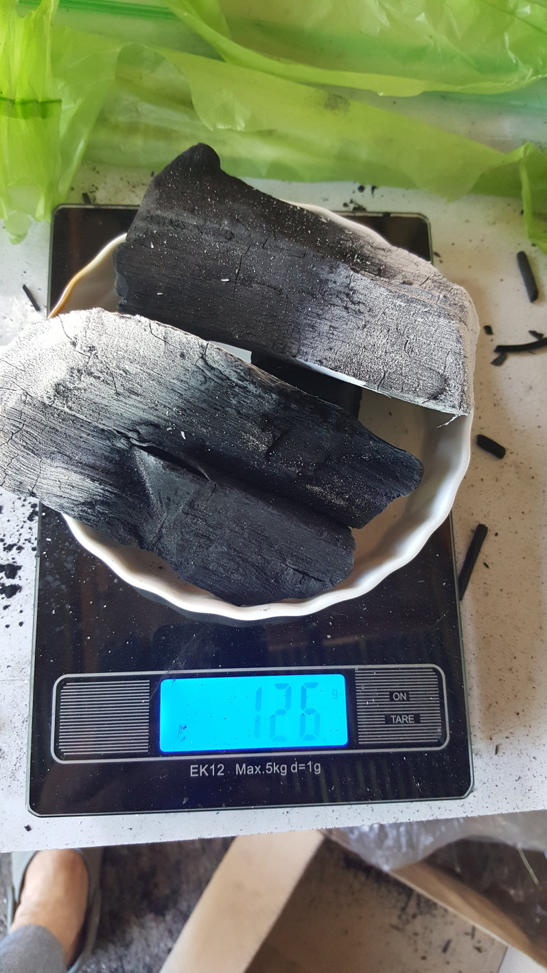

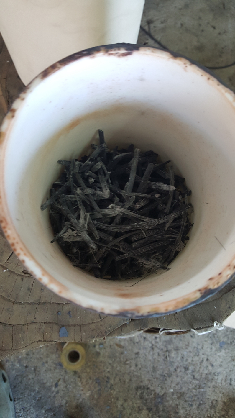

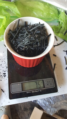

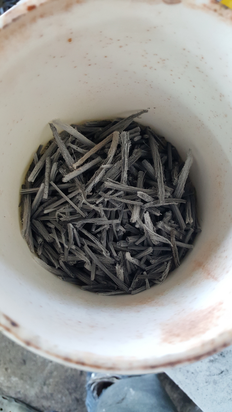

results: the good charcoal, same as before , lost about 14-15%
The bad charcoal, again, 35%
so, once there is no more oxygen present, only heat applied… nothing changes… ( remember this is not labtesting but ordinary workshop )

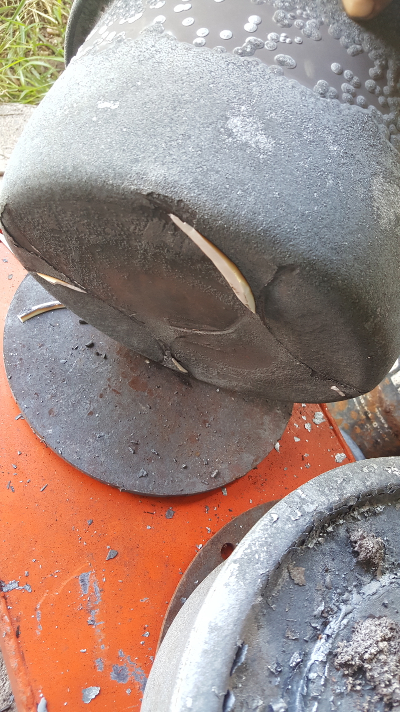

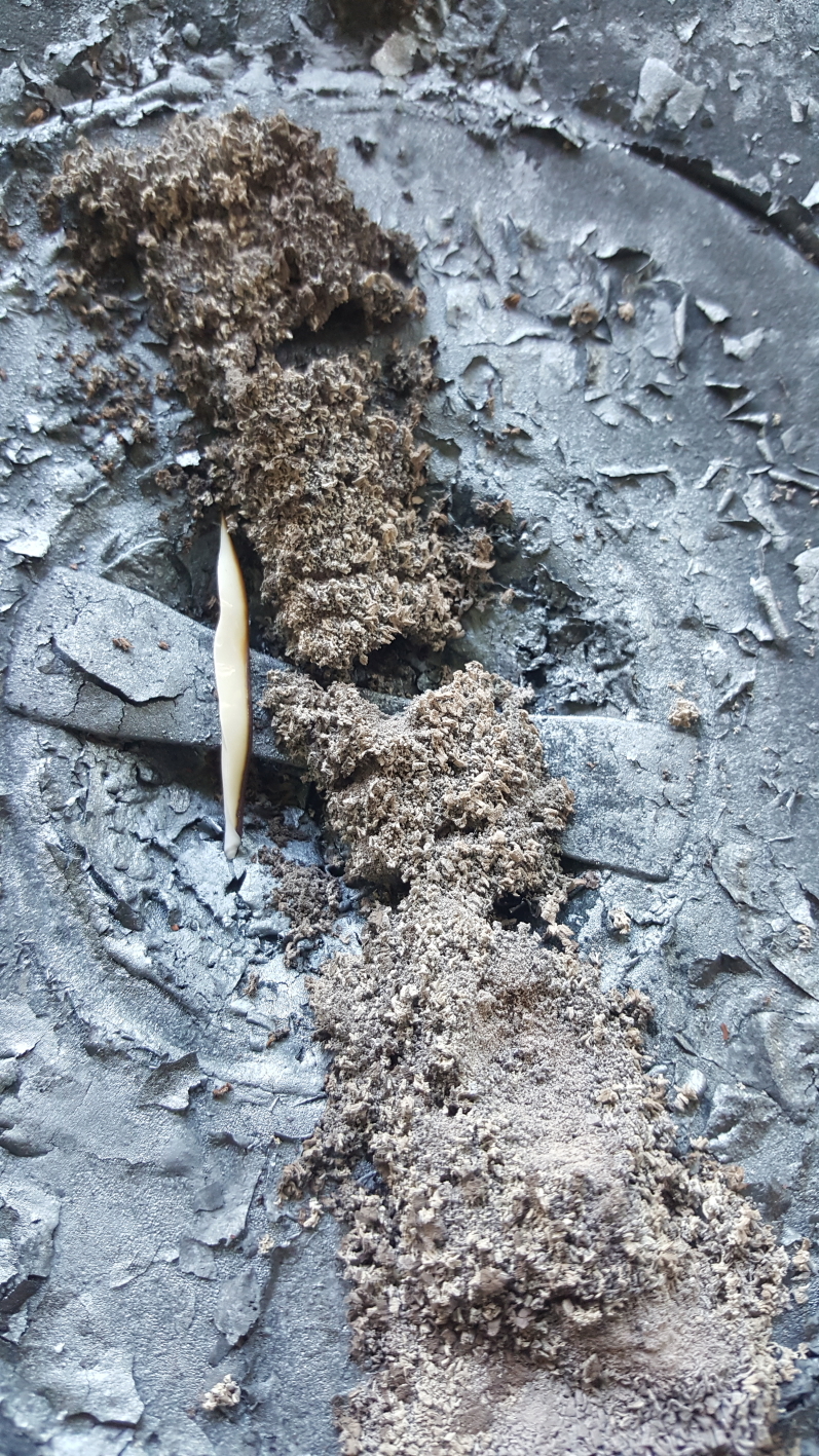

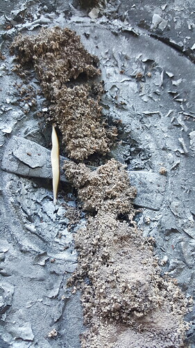

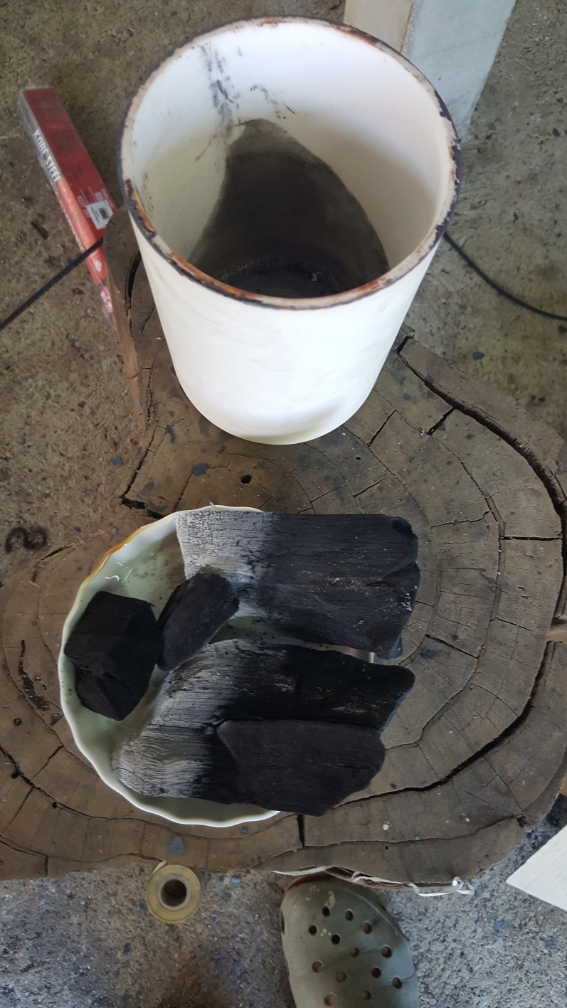

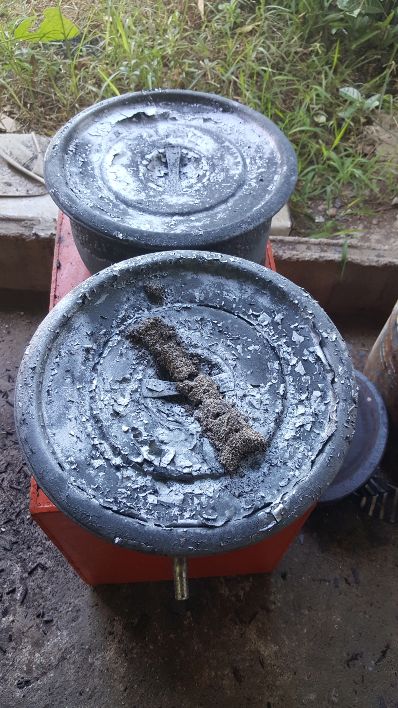

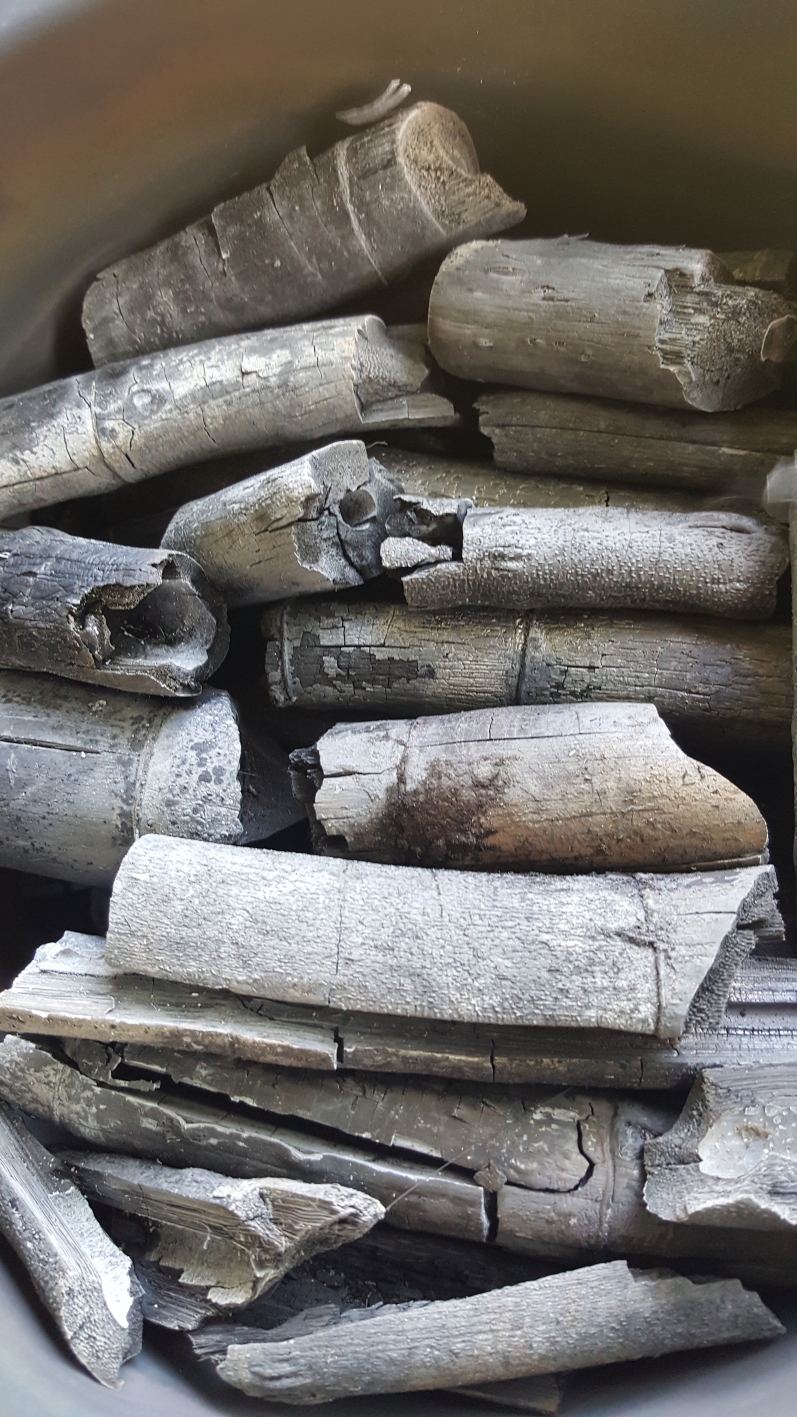

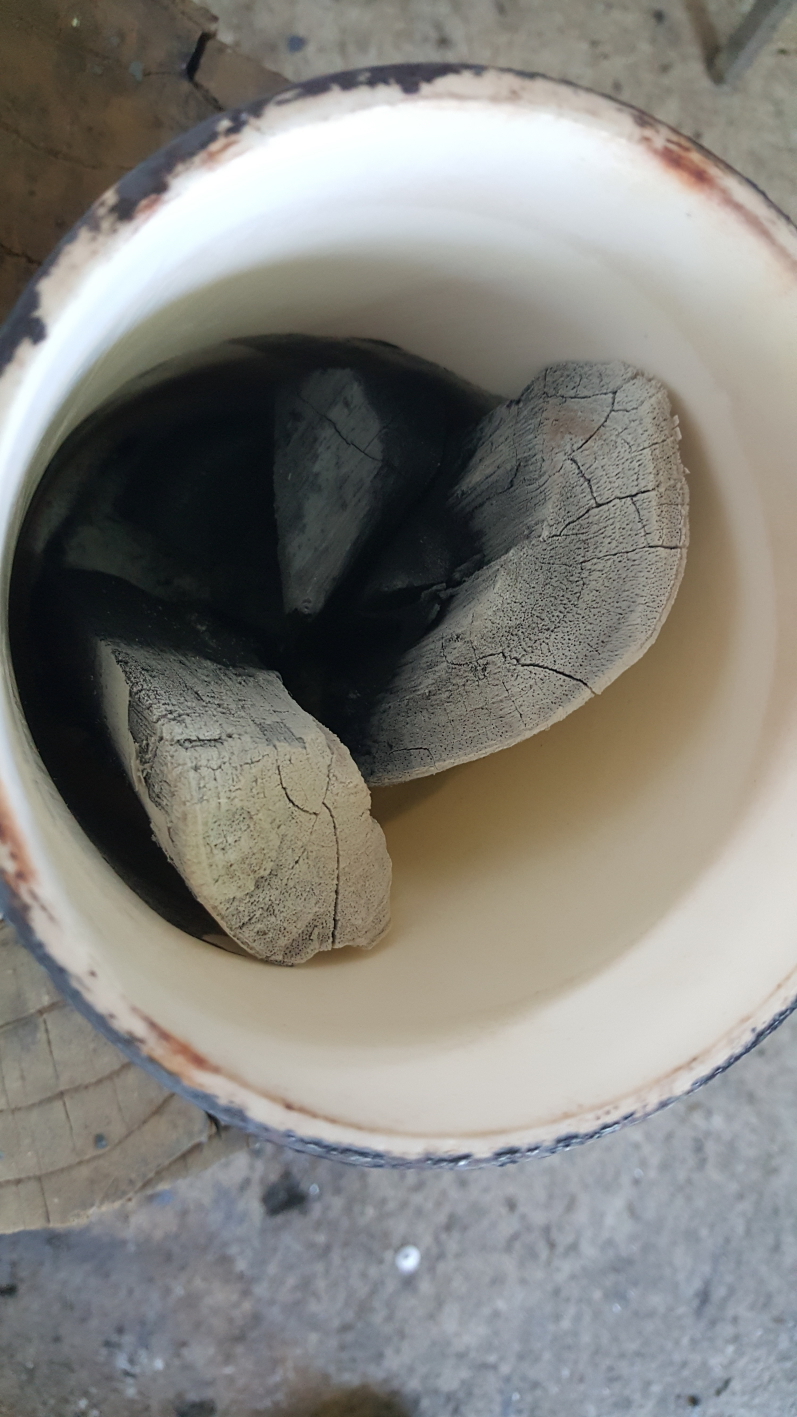

on the pictures you can see what happends where oxygen is present… ( turning white )
This picture is about one piece of rubberwood, i did put on top of the lid, to compare and to reduce the oxygen in the oven… even wen i flooded the oven with argon…
only ashes remain…
the white ash on the wood is only very superfacial, rubbed of easy and only little

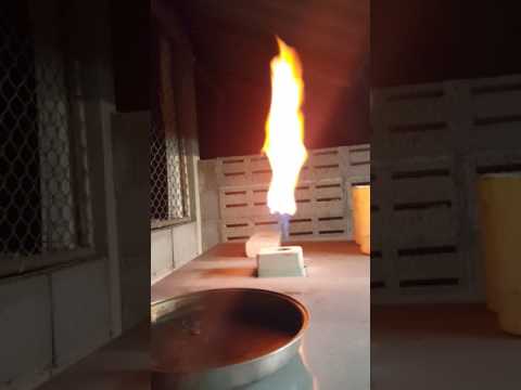

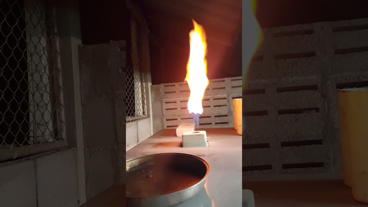

Testing the oven with pure CO2 as oxydiser
Look how the flare pops up… CO2 / Bamboo Charcoal and heat…
Tomorrow i will know how much Carbon is consumed with the Co2…
Charcoal consumed during this process: 30% from input material
But a nice blue flame if all the CO2 is converted into CO
More CO2 input then can be converted, results in a reddish coloration from the flame…
Ergo: imho, red coloration comes, in this case, from excess CO2

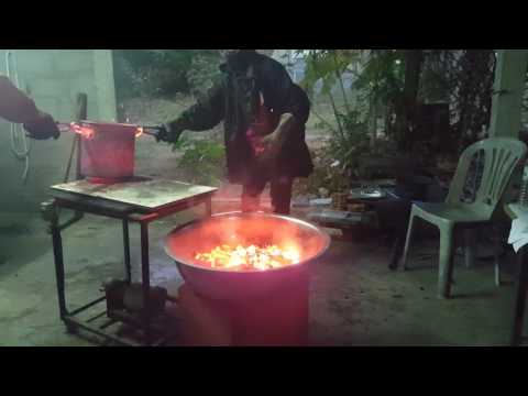

Opening the door of hell ?
Taking the glowing charcoal for a dive…
Carefull not to burn yourself…
Soaked the clothing , headscarf and gloves with water before opening the oven…
