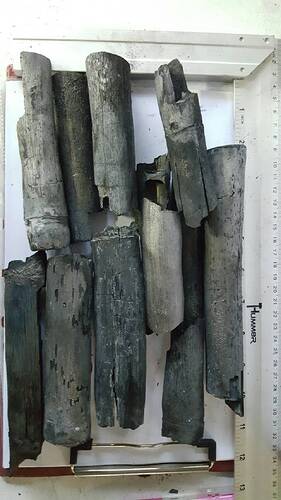

the charcoal before upgrading ( the stuf with 35%)

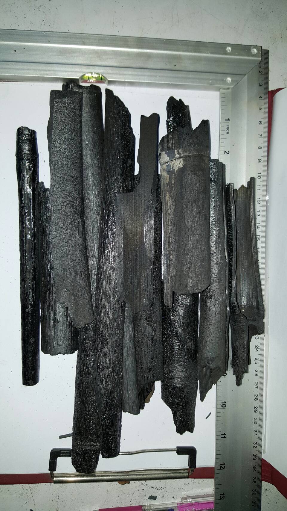

and after the upgrading process
cooled down in absence of oxygen for 24 hours
Do l see brown color in one of the peaces?
in the before or the after ?
Before. It looks like the stuff l throw in the next bach when l inspect my charcloal.
it was not brown, but even by the looks yes, badly made charcoal.
but i was able to upgrade it in the oven…
