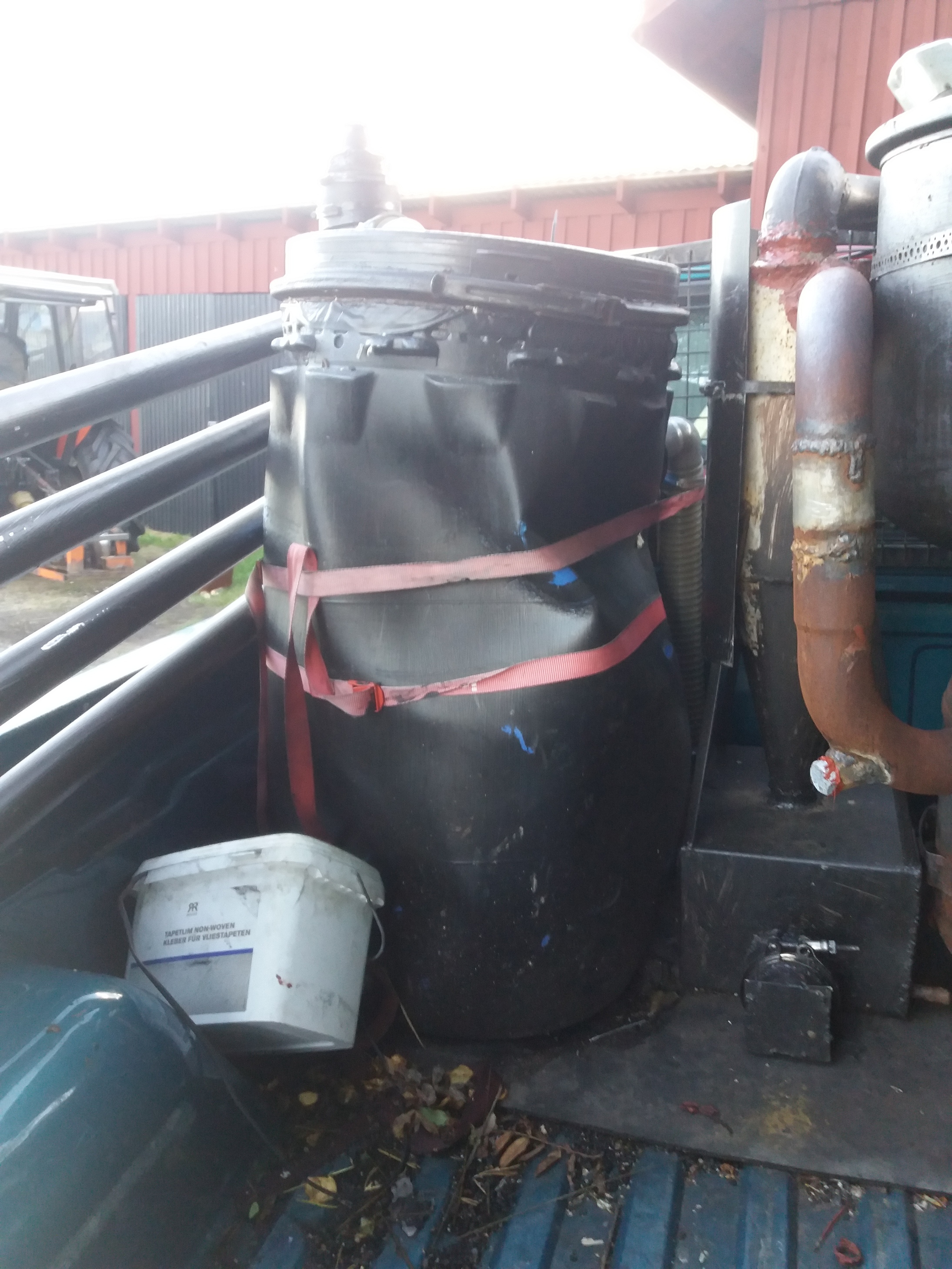

I have tried the vaccum tester tonight, I think it shows that there is a stop before the filter.
Or is it because I went up a several kilometers uphill?
Been there, done that
I try never to pull more than 30 inches.
Same
l once pulled it so hard even the rebar ring inside flatened ![]()
There are huge forces since fhe surface area is so great. And the shape is not ideal.
There is a company here that makes those kinds of rainwater vessels in many sizes and shapes. Real thick plastic and rigid design. In squere shapes too, to maximise bed space
I cut out some wood rings to put in side my plastic barrel to stop it from looking like yours. When you pull over 30 inches of vacuum something is going to give if it can.
Same here I’ve done it too. ![]()
I build them all out of steel or stainless steel any more, don’t have to worry about it then. I pull well over 30 all the time???

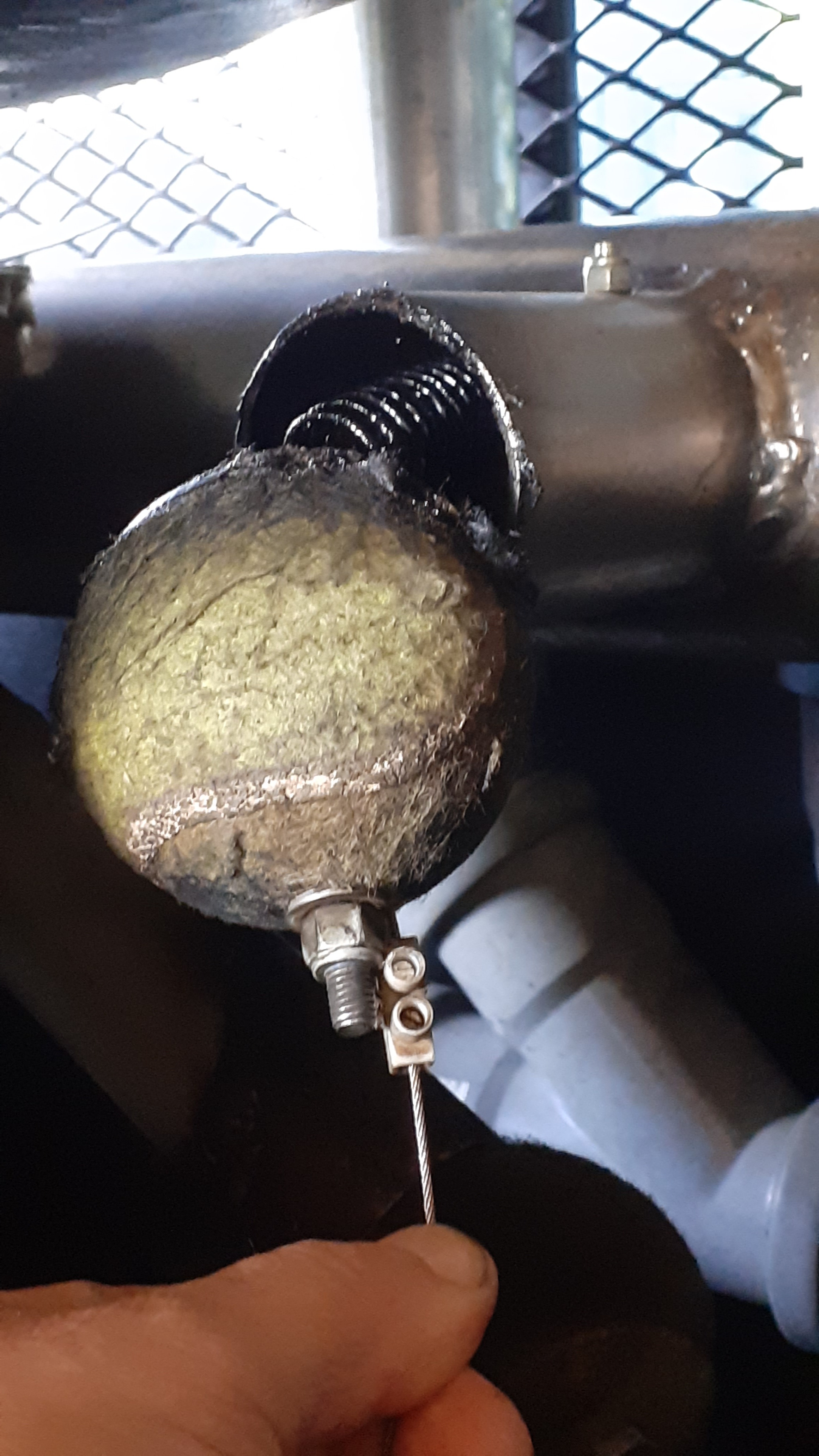

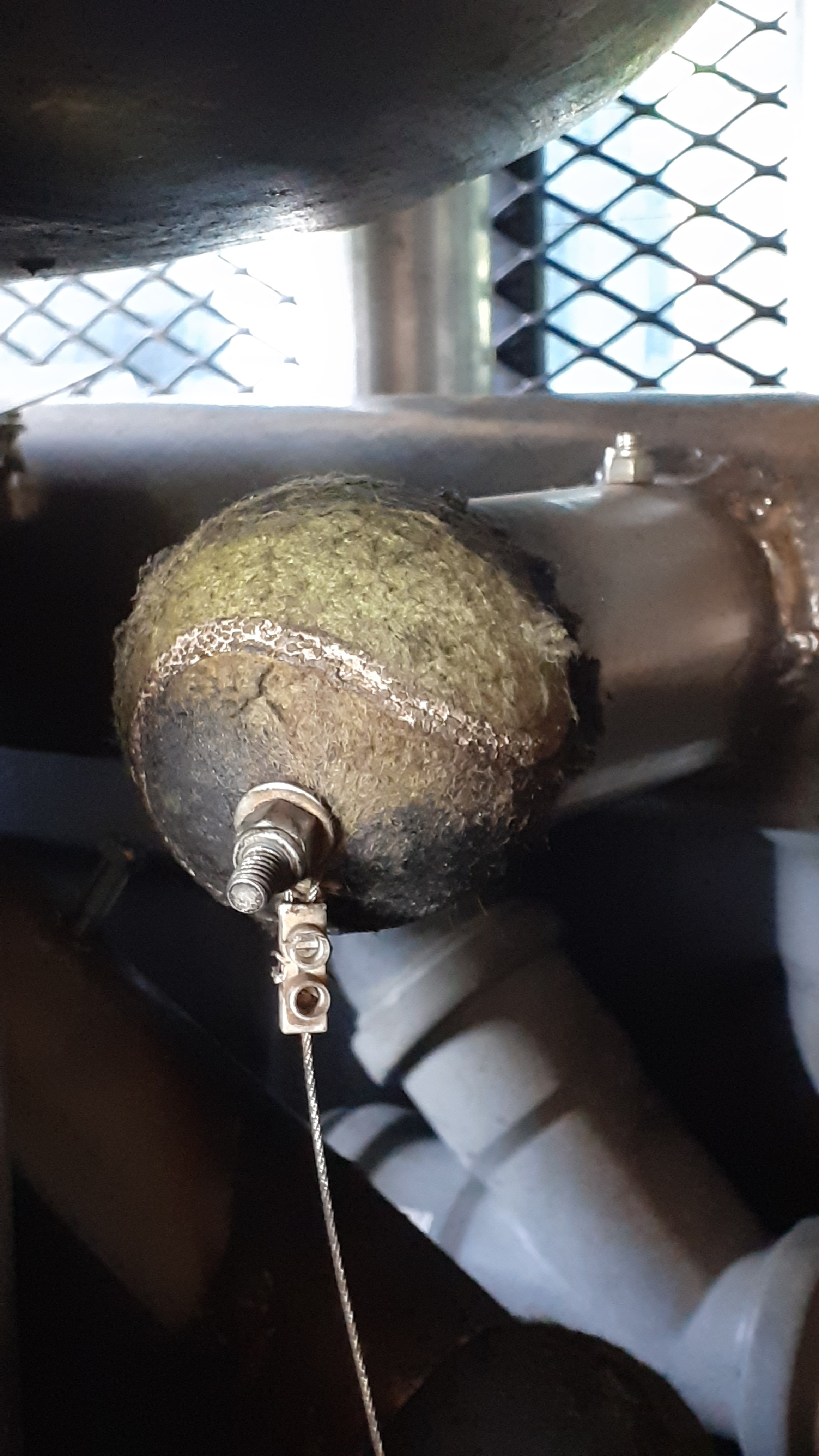

@JO_Olsson can you show how you did with the tennis ball, I do not get my tight.

It was a hose that made the barrel (filter) flat.

I know Wayne uses rubber connectors to make the tennis balls seal, but I never bothered.

@JO_Olsson , do you pull the ball out only on the edge, or how do you get it to go back?

Yes, the cable from inside the cab pulls the tennis ball to the side. With a little hardened tar on it, it lets go easier with some leveraging action.
The spring from inside the air intake pulls the tennis ball back in place as soon as I relieve the cable tension.
