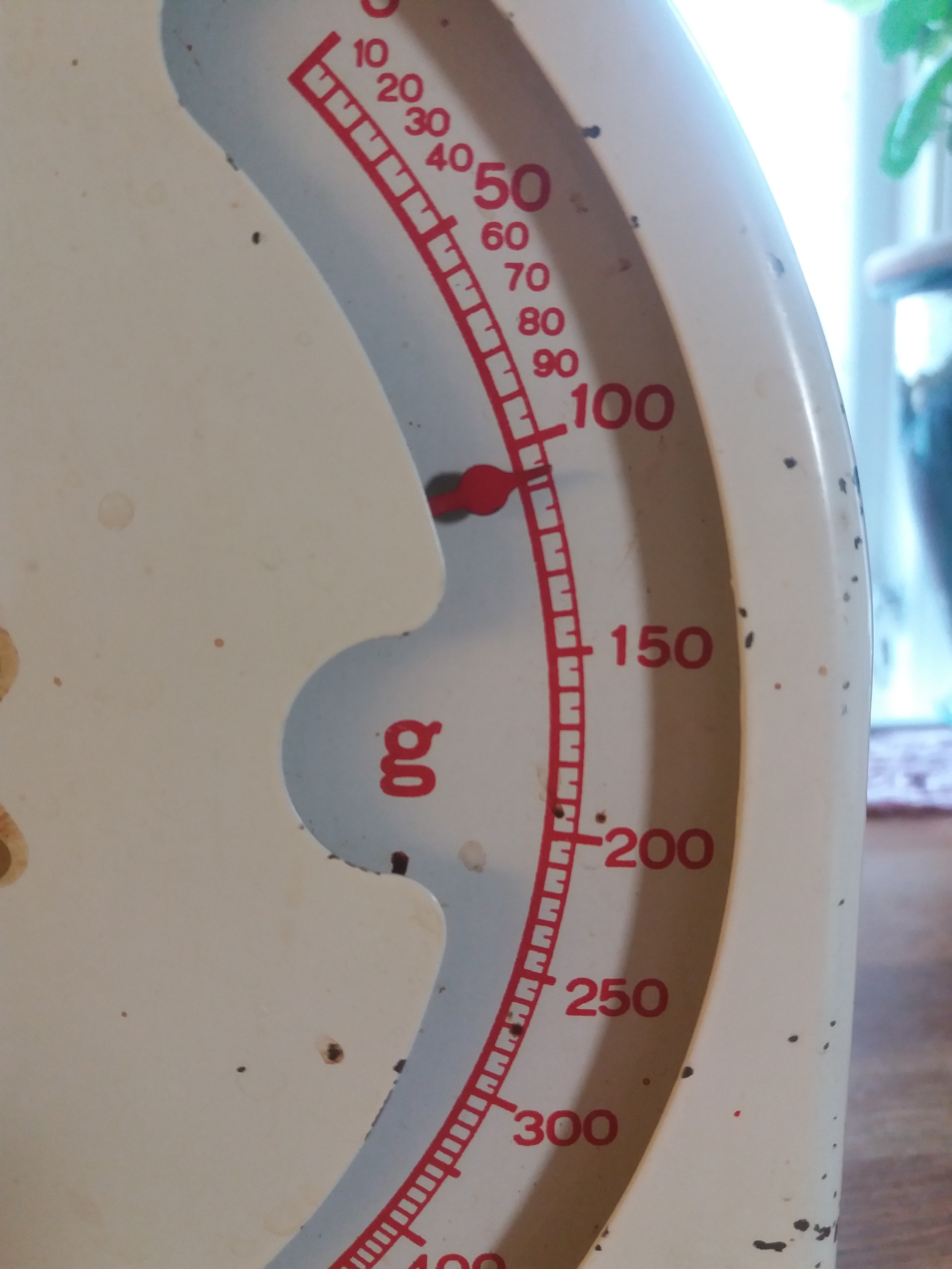

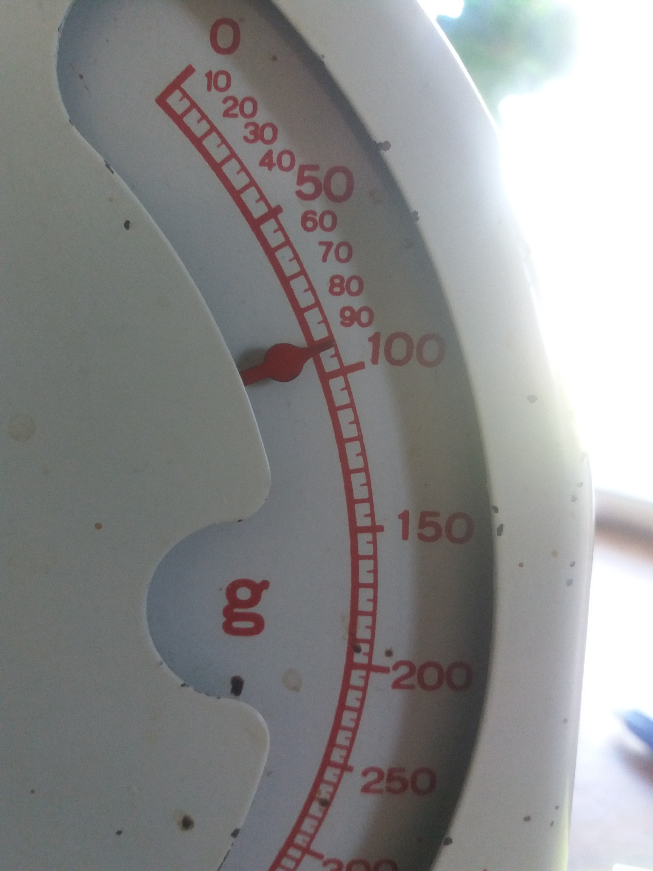

But anyway, tested some wood pieces that you suggested picture on the scales before and after in the oven about 1 hour 150 degrees c.
Mr. Steve; Your suggestion worked fabulously!! That needs to be framed and placed somewhere permanetly. I can’t tell you how many times I have gone back through actually 100’s of postings looking for something I thought I had read or said. Again, good job. TomC
Jan; Thank you for testing the moisture in your wood. I like the gram scale that you used.(pound scale have to large of dinominations) OK; you had 107 grams “wet” and 90 grams “dryed”. If I did it correctly, that shows about 16% moisture. That would be good. I like the 150c temperature (about 300 degreesF) just at about the start of pyrolasis. You cooked it for 1 hour. It may have gotten fully dried out in that time— or it may not. If not then your moisture rate is higher than 16%. I would suggest that you try again and this time with that handy dandy scale–every 1/2 hour take the block out and weight it then put it right back. When the weight reaches the point where the weights remain the same, you are now ready to calculate your moisture.

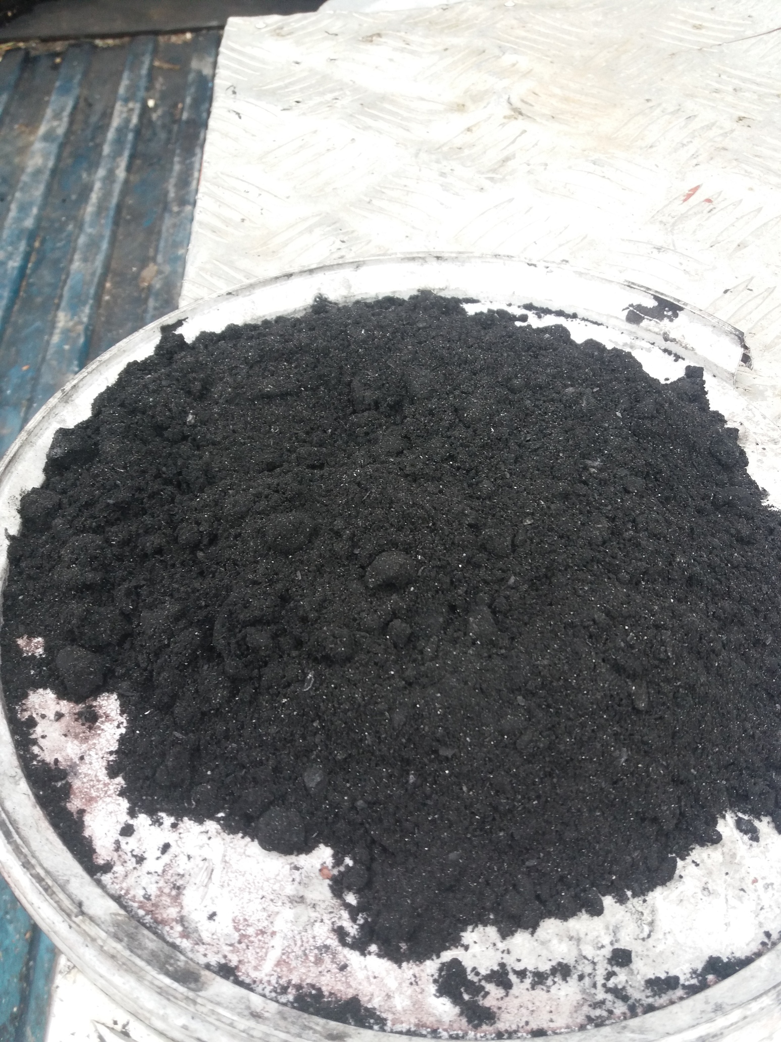

Now I have driven a few days since I cleaned the jumper and the cyclone, travel an average of about 30-40km a day on firewood.
I have driven as fast as 80kmh, and the car usually shifts at 2300rpm when it is cold.
This is what the ash looks like in the cyclone today, it seems like you are right @JO_Olsson , as long as there is space left in the ash hatch, there will only be dust in the cyclone.

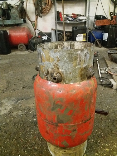

@TomC , I only have 5 nozzles, what you saw were the holes in the conan I tried before, have removed it, do not see that it does any good.

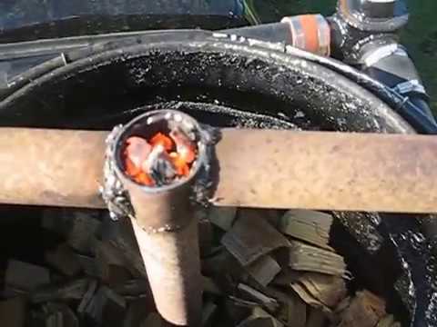

What do you do with the ignition when there is a lot of wood left in the container, I usually pick up some pieces so I can see the charcoal.
Good morning Jan .
Is this what you were asking about ?
Exactly that, but are you not afraid to bump fresh wood into the bottom and get tar in the engine?
NO , With my tube or punch rode I can feel and know I have plenty of char.
Before the woodgas goes to the motor I make sure there is no smoke in with the gas . No smoke No tar .

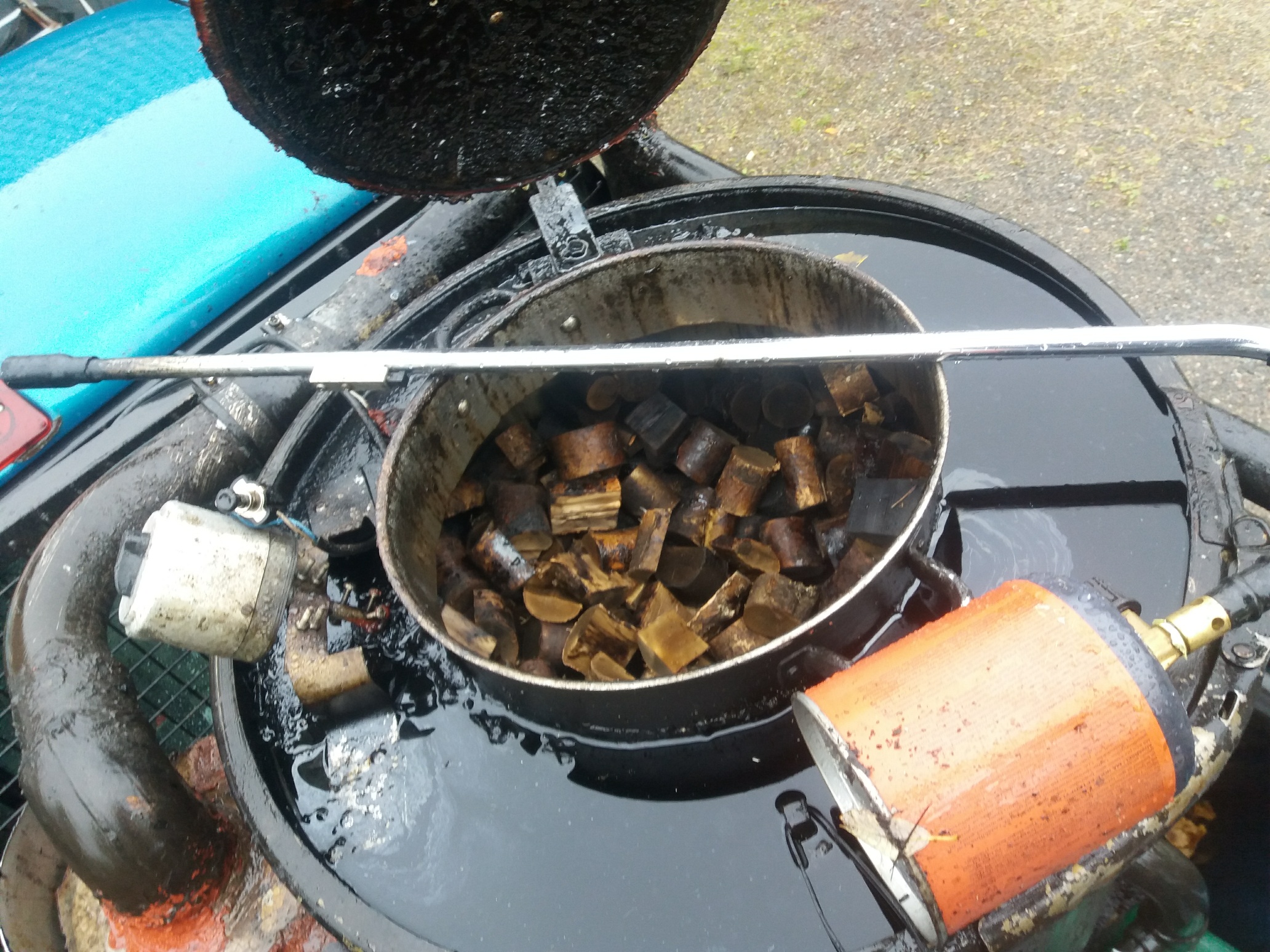

Our small Imbert hearts store a very small amount of charcoal. Any problem with uncharred wood, lack of heat and tar making will straighten out quickly as soon as the motor starts pulling on the gasifier.
However, running hard for a long period of time, consuming the fines and in addition a little bridging in the heart or suddenly slipping too much char will allow tary fumes to sneak by.
Also, once tar entered the system and get warmed up again it can start releasing fumes. Hard to tell then if a sticky throttle is because of the latest or an earlier ride.

The dimensions between the nozzles and the dimensions of the constriction are probably quite correct, and it is well in that cone that the coal is consumed, I would probably have a slightly larger constriction in my car, but I dare not do this yet.
