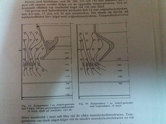

The experiments are done on a 6-cylinder side valve 3.67 liters comp 5.9.
The power taken out on the rear wheels. They tested at 35 kmh and at 75 kmh, got almost no difference in temperature under the pipe, they also tested without any carbon under the grate and got no difference in power
But for that it does not have to be right, have seen that only changing a parameter can change conditions a lot.

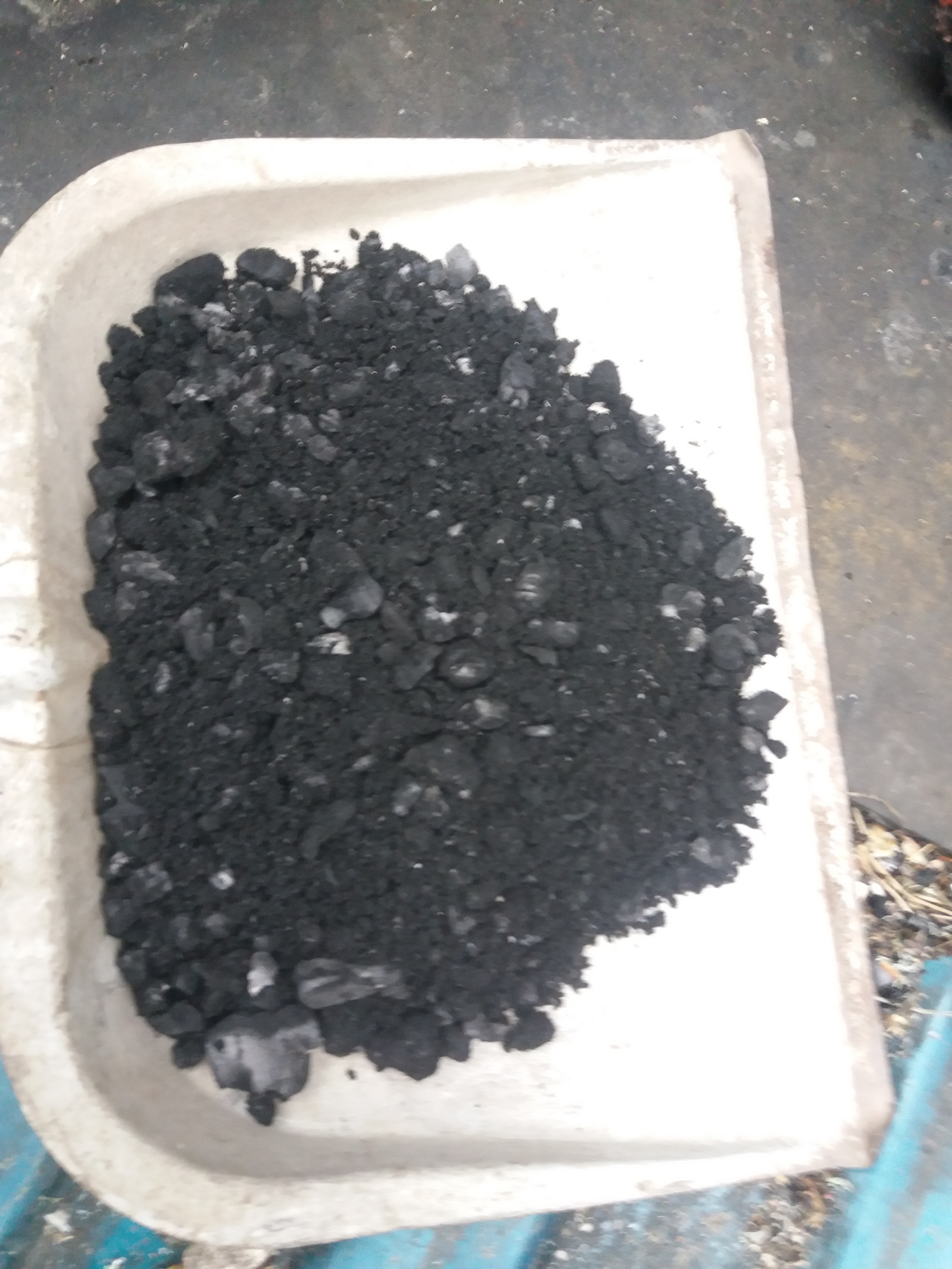

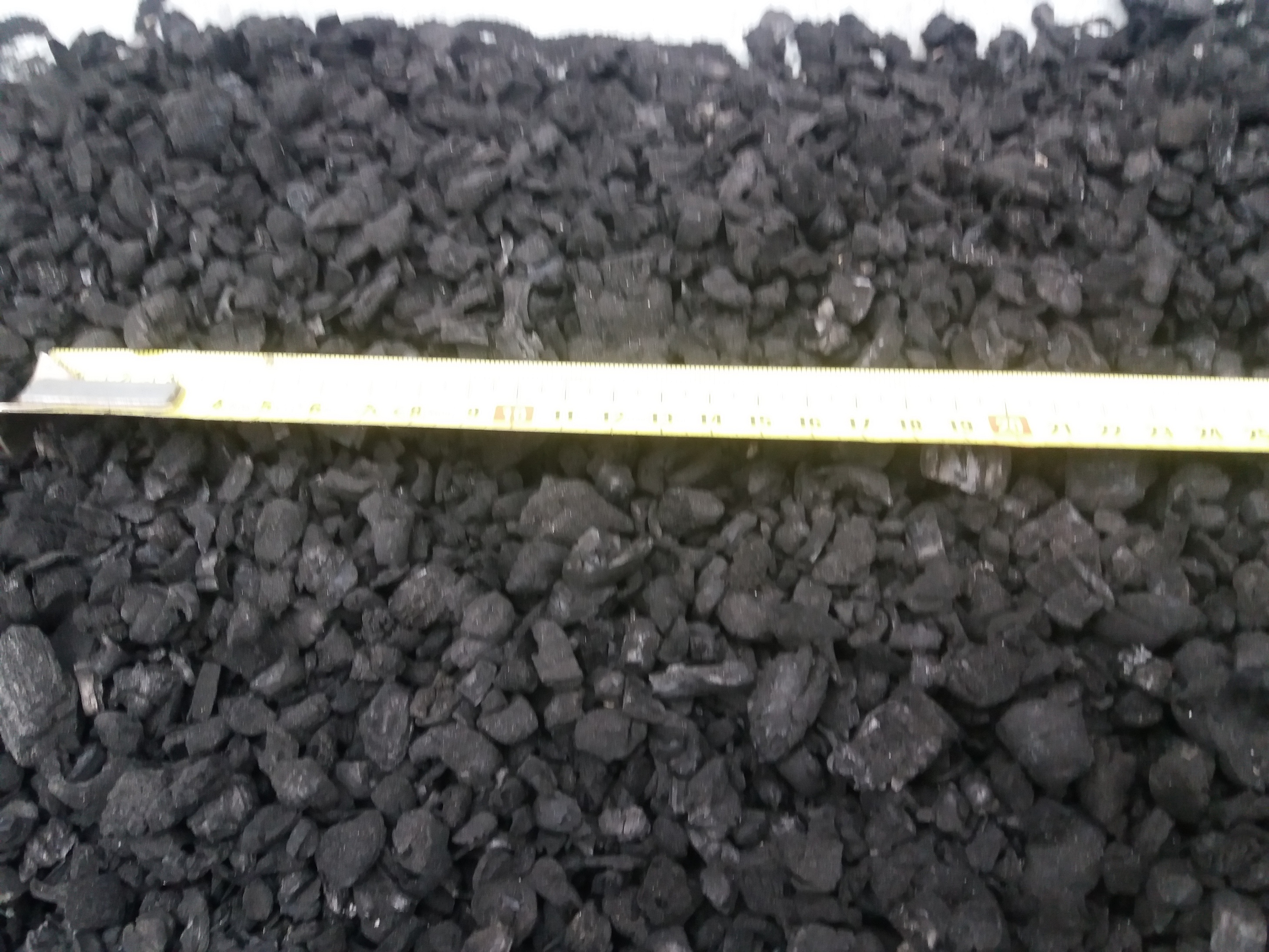

First picture of the carbon in the cyclone after a few days.

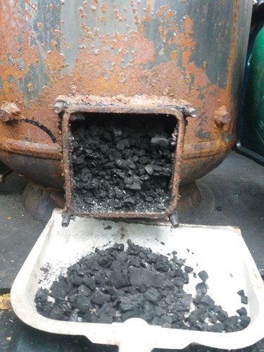

Others on the ashtray, completely drunk, did not clean it last.

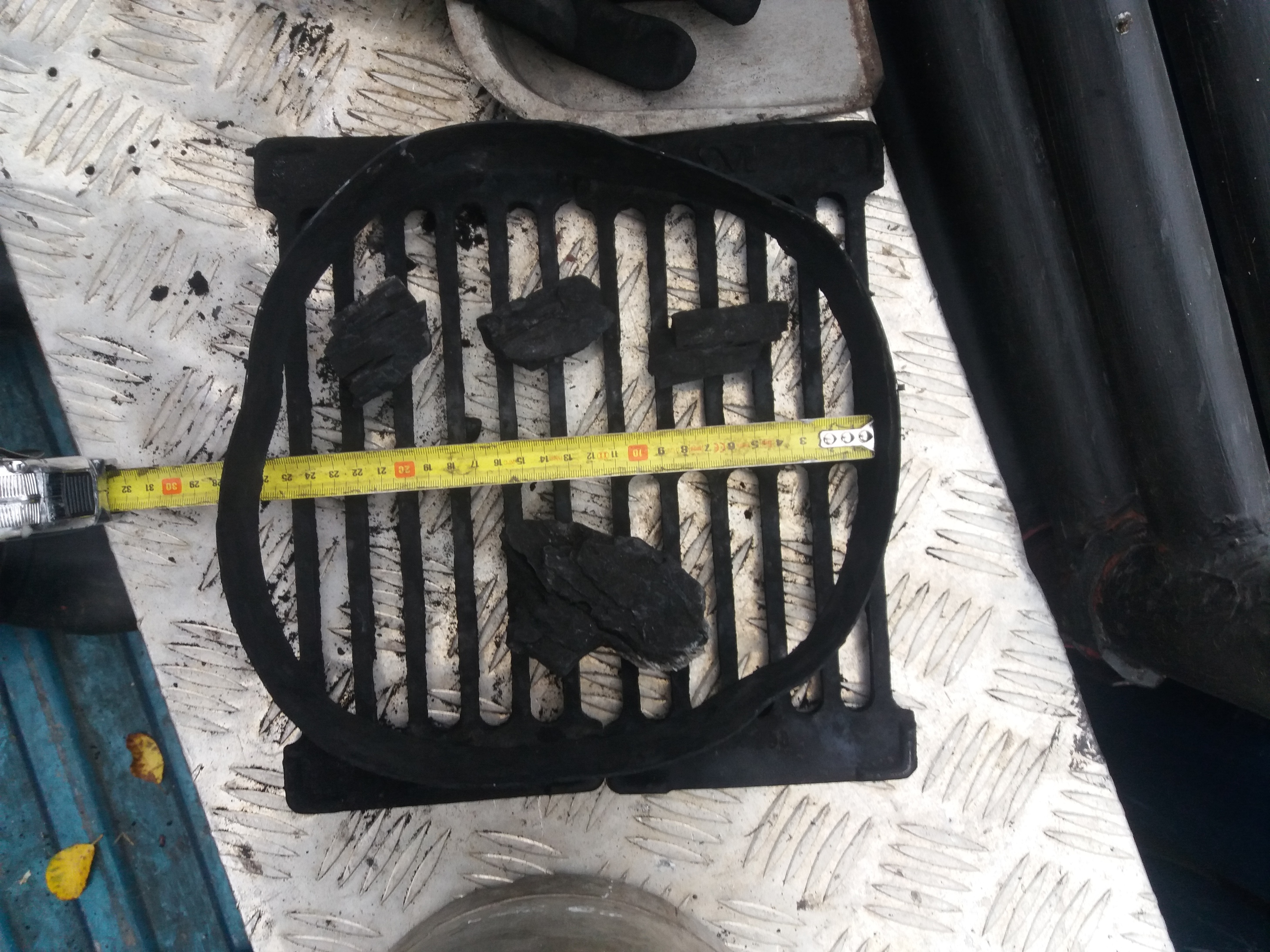

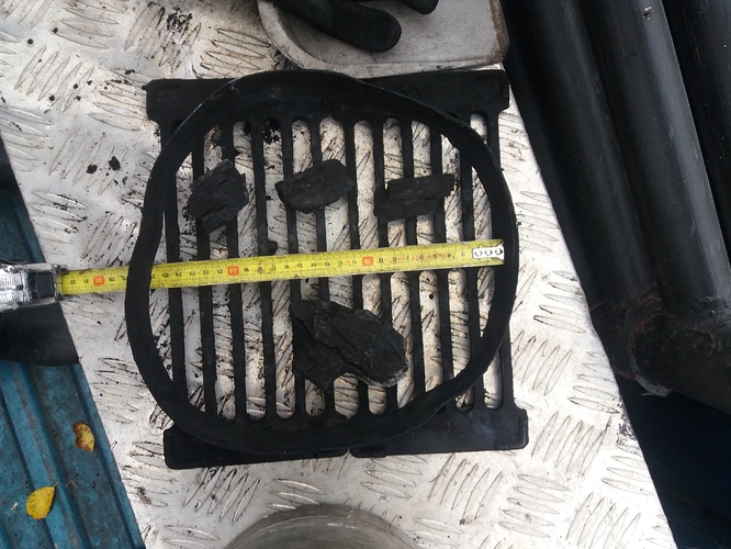

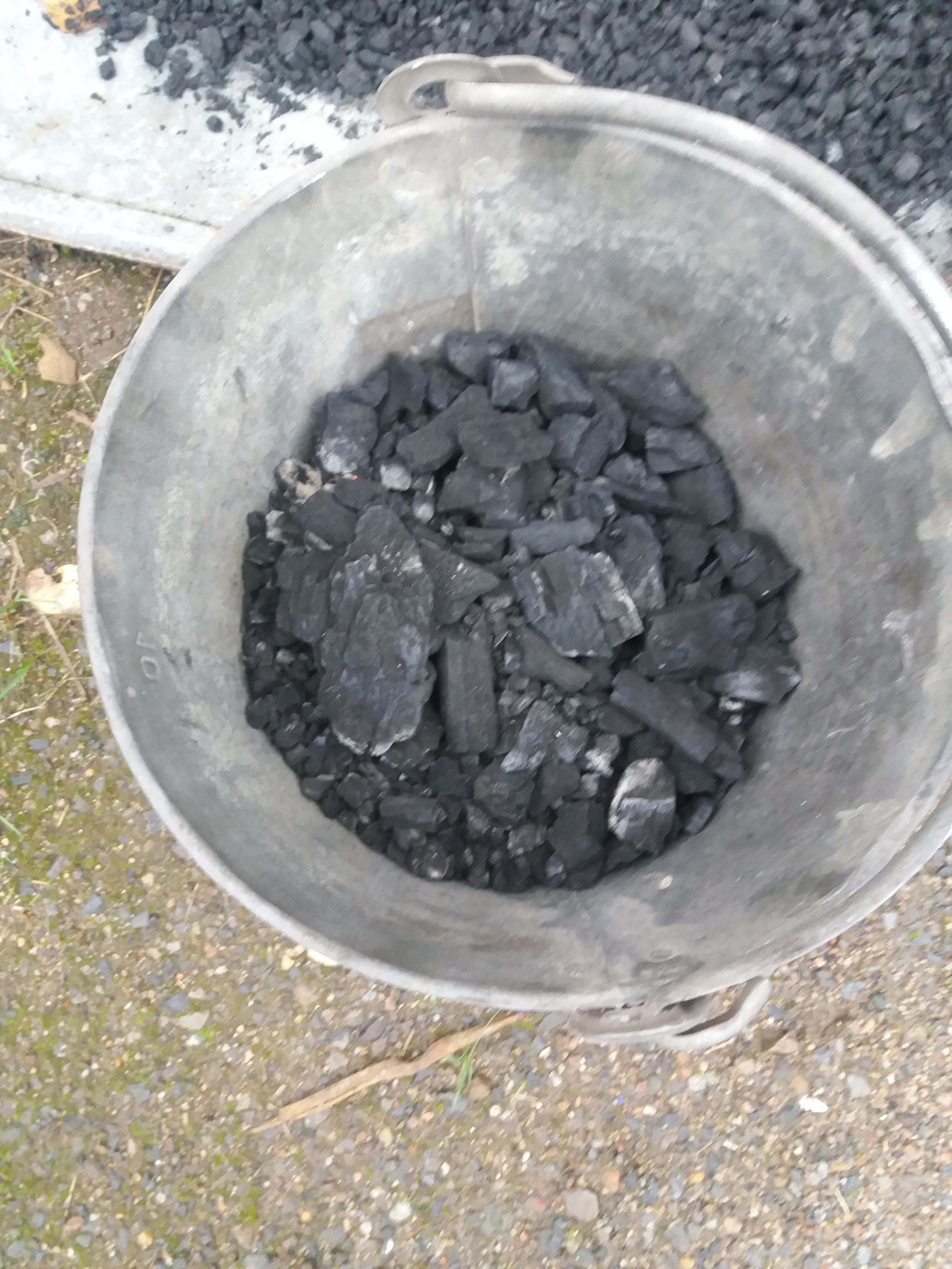

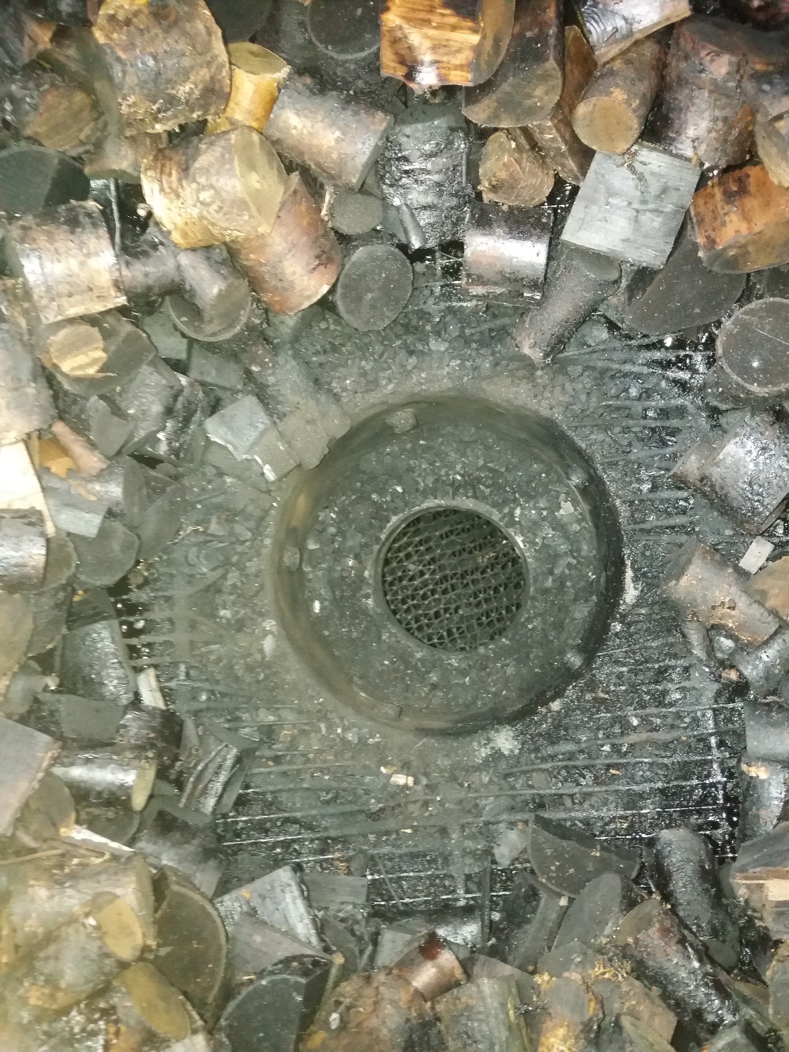

Third on how the coal looked just under restriction, the big piece of coal I put there last, about 4 weeks ago. Why has it not disappeared?
Now I have a pipe that goes up a bit on the outside fire pipe and put a net on top of the grate there so that the coal will remain better.
Does it say anywhere how close to full power during those tests? 75 km/h can be either light or hard work.
What surprices me the most is the temp diff, center vs close to the wall. That would suggest a restriction close to the grate would be beneficial, to concentrate the heat (WK-style).
It’s obvious now your grate is slipping too much char. Maybe you could just put a few bars across, on top of the existing ones, for testing.
Probably because the majority of the hot gasses sneak out to the sides above the grate. That’s perfectly OK, but suggests you could tighten the grate quite a bit without doing any harm.

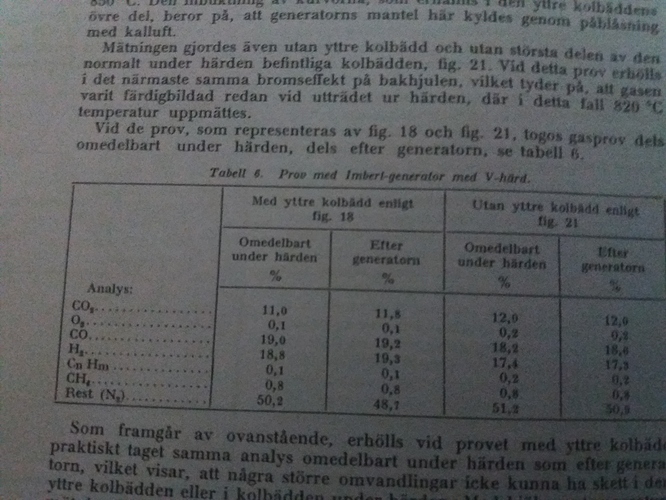

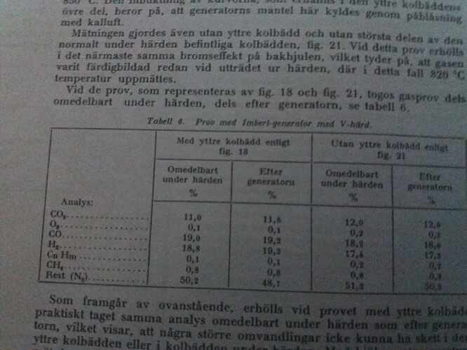

@TomC showed me that it is in the library here on the forum, Gengas: The Swedish Classic On Wood Fueled Vehicles page 40.
Thanks Tom C, it seems like the car is running a little better, has driven 2 times now, last time it went at least at 95kmh, think it seems stronger too.
Would think I have to redo the grate, it will probably be tight pretty soon with the net I put in.

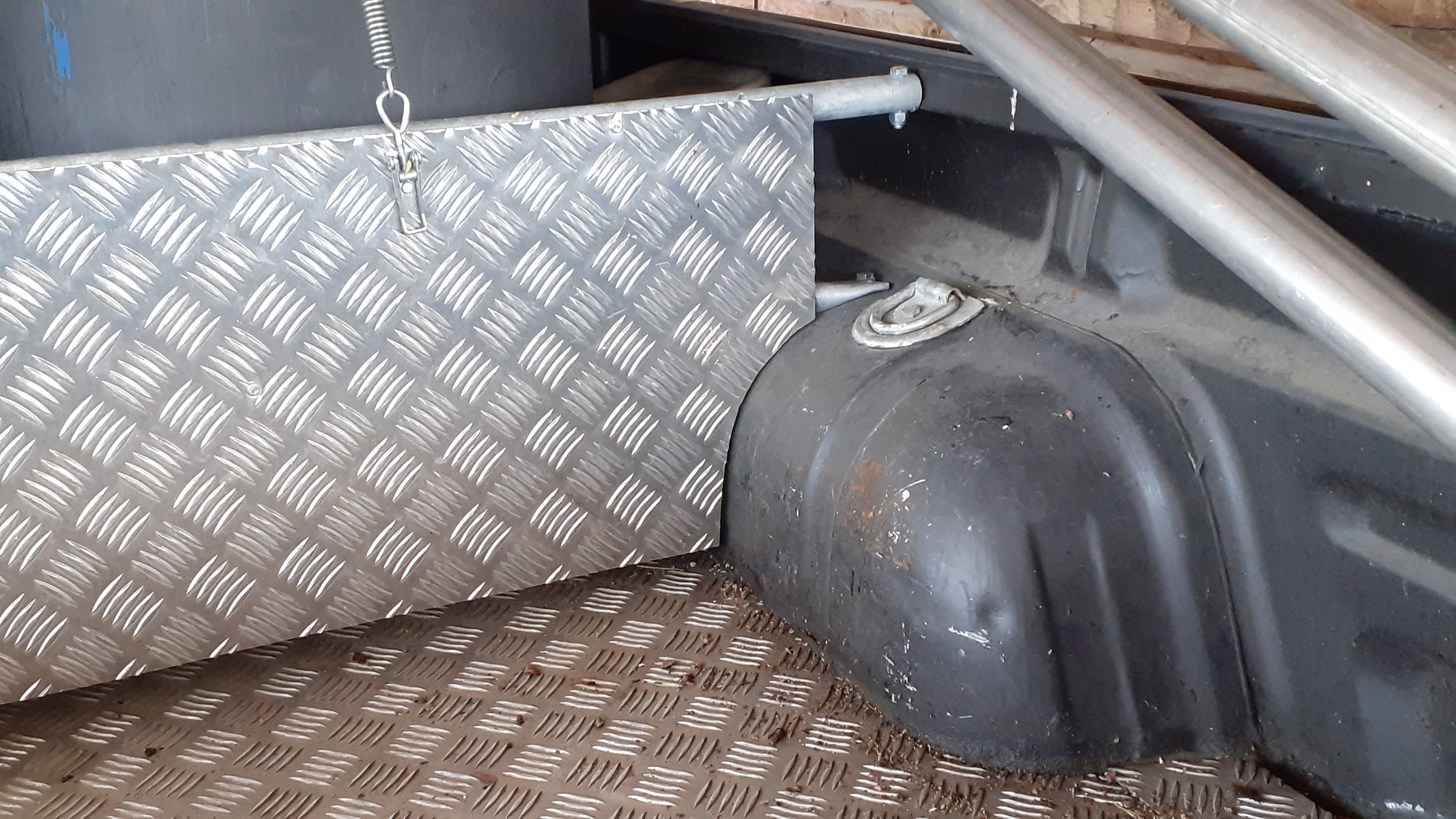

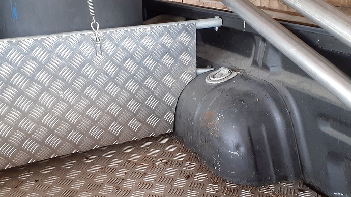

@JO_Olsson, the plate between the flatbed and the unit, must it be tight for inspection?
Jan, I believe a 2" inch pipe is able to pull more than enough vacuum on our size gasifiers. I read an old thread only days ago where Wayne experimented shutting off one of his two pipes on the Dakota. There wasn’t a noticeable vacuum loss until the very upper end of the V8’s breathing ability.
No, I was told just to prevent any cargo sliding into the gasifier. My devider has an inch of clearance towards the bed to be able to brush or flush back any debrie from the gasifier area. Also, the plate wasn’t wide enough to reach across.
Thank you, then I order 2 ", where did you get the aluminum plate?
BorlÀnge HandelsstÄl. That plate cost me more than the rest of the build :sleepy:

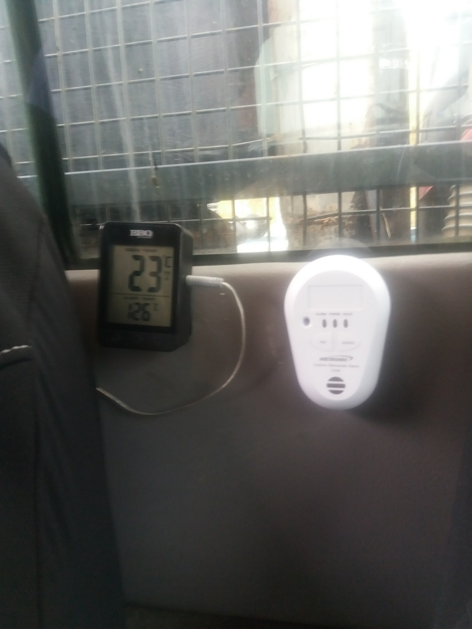

Bought a carbon monoxide detector, feels very good to have in the car.
