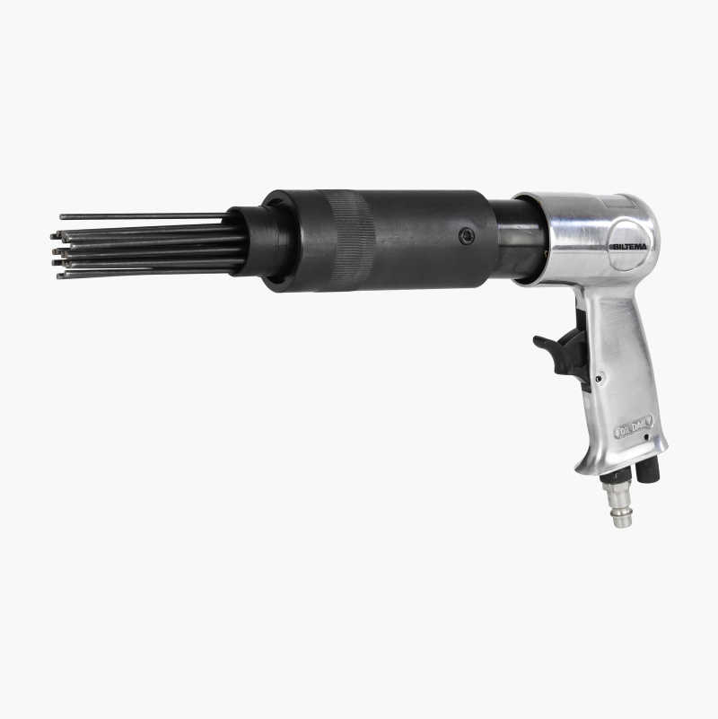

Ok, do you use one like this?
Is it to clean or to try to loosen the screws?
Both
it cleans them up nicely, removes all flake rust, the “hits” and vibrations also helps break the rust in the threads.
After some “massage” the bolts often come loose the normal way.
Thanks Göran, I’ve never tried that, would be very good if I don’t have to drill out the screws.
