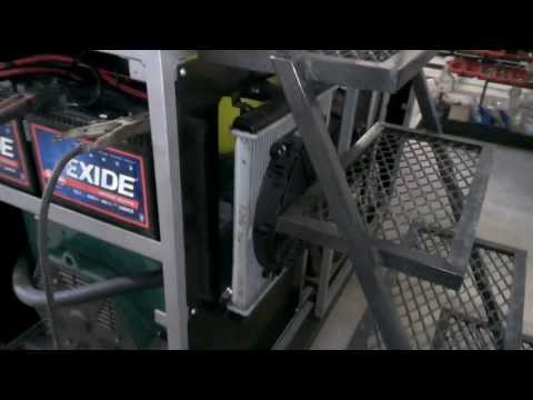

This German guy is doing a lot of automation in the redneck way many of us like

Interesting way he keeps those stringy wood chips from bridging. Iāll have to file that idea away.
Andy, if you look closely that āstompā touches a micro switch when the fuel level goes low. Tells the auger to start turning.
lol we did something like that on early machines. Now we use magnetic proximity switch, this is the actual reason the hopper is SS now, so the magnet does not stick to the wall of the hopper. So this kills two birds with one stone as the hopper is one of the components that really should be SS to combat corrosion anyways.
If you fast forward to the 5 min mark you will see the cylinder level checker. It had a switch at the end of its travel. If it could extend all the way it would trigger this switch and fire the auger motor timer. If it had fuel then it could not fully extend and then would retract and nothing would happen. Worked quite well but was way to elaborate and was subject to tars and gunk, gumming it up. Live and learn, the new sensor works quite well and the prox is outside the hopper so it can not get damaged by that harsh environment.
