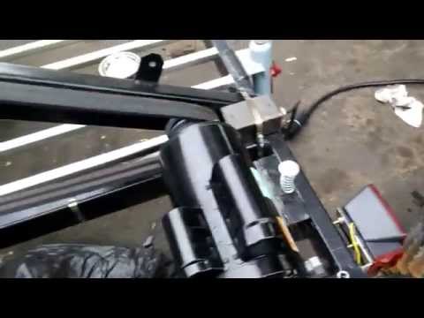

Lights installed. Ready to ride!
You can see a few other things in that picture; the new 30a locking plug is installed, full wiring is completed, and the motor mount is now spring loaded.
New motor is coming tomorrow, will install and reassemble the rest of the chunker.
