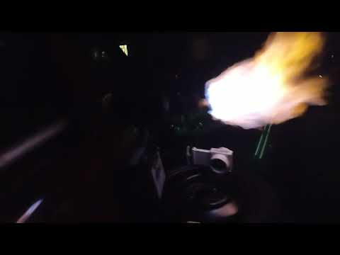

Here’s a night time flare after checking for leaks.
I hope the 45 degree elbow will mute that glow a little.
Yes that is really bright flame hole. You will need to build a shield tube over it so when the flame comes out the intake it will hide the flame. As soon as you squrited water into the intake it started to make more Hydrogen. Cool it down with water drip.
I’m going to make a flame arrestor that will nest inside the pipe, just held in with tension so I can pull it back out for lighting or clearing the nozzle. As soon as I shut off the bilge blowers there was about a 6 inch flame streaming out of the air intake of the nozzle. If the rake angle of this truck wouldn’t mess with it I’d consider a flapper valve to let it shut closed when I shut down, but since it’s leaning with the bed slightly forward the valve would never close all the way. Oh well, At least that means the fuel will bias in front of the nozzle ever so slightly.
Charcoal fuel will always be used up on the side of the nozzle coming into the gasifier. I had my gasifier hopper tipped so it would feed more on the nozzle side. I do not have this problem with my double flute nozzles.
Cody, the content shows how a professional approaches gas production
Haha, Cody that’s the fastest lightup I’ve ever seen ![]()
I’m sure it’ll eventually take longer, that was freshly ground fuel and totally dry.
