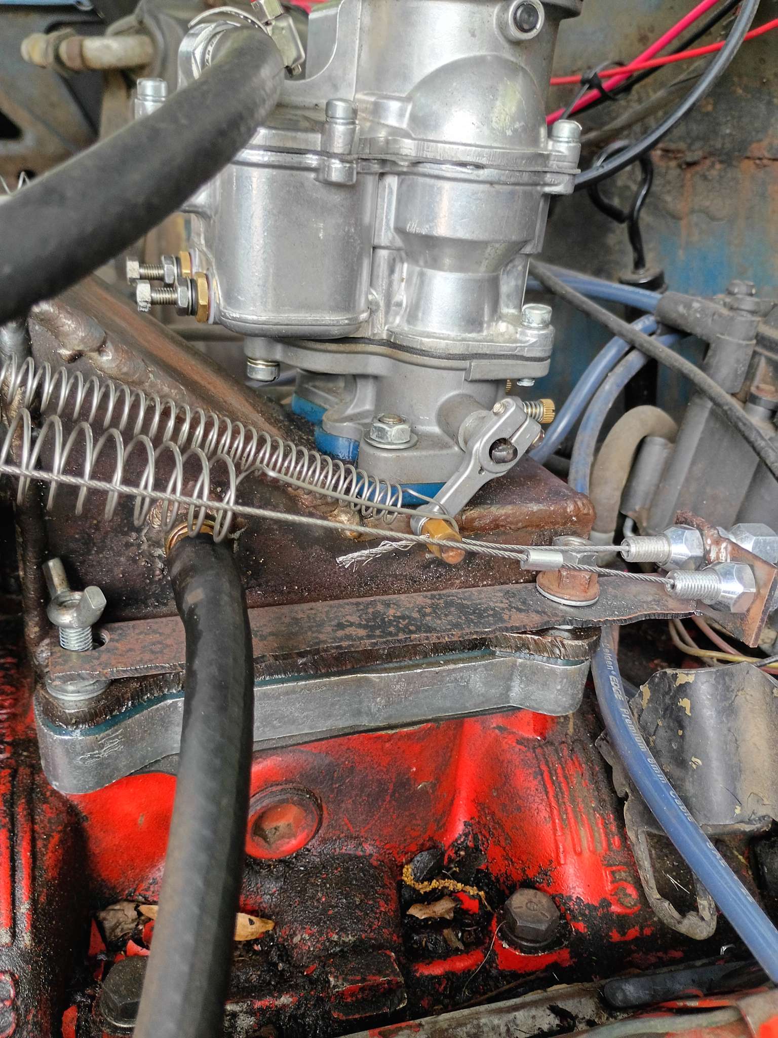

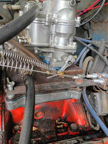

I need to figure out what’s making this throttle sticky and requires two return springs.
Does it stick in wide open (which is not fun)? Or over the whole movement?
Sometimes the butterfly disc “scrapes” the inside of carb throat, could often be fixed by placing some washers between butterfly shaft and throttle lever for example, and adjusting in the way that throttle cable or linkage pulls straight on lever, not even a little sideways.

It doesn’t really stick at wide open. It’s more like it doesn’t go to a consistent idle.
I think I may have gotten blue loctite on the throttle shaft when I put on that adapter arm for the cable.
That could be it.
I’ve also noticed many new, out of the box, carburetors are a little hard to get the last bit back to idle, i guess it will “work itself into order” after a while.
I put a new Edelbrock in a Cadillac at work the other week, and it stayed on a irritating high idle every time i let go of the pedal.
It needed 3 return springs to solve it. Best had been some kind of “progressive” spring that lets go the more one gives throttle.
Most aftermarket carbs I see being put on have this same issue in my experience sometimes it’s the carb needs some wear in time, other times it’s the throttle cable coming to the linkage at a odd angle, not the factory geometry. Very prevalent issue with Webber carbs on Toyotas, the factory throttle linkage can be adapted to the carb with a kit and the issues is resolved. Many aftermarket throttle brackets for v8 applications are just generic enough to work but have the same issue. Cody with your carb located higher and back I suspect it’s a geometry issue the cable doesn’t want to return not the carb. Simple test take the cable off and slap the throttle and see if it returns, then ease into and out of the throttle and see if it returns by hand. If it does both times, then suspect the cable angle

It probably is the angle, I tried to get it as straight of a throw as possible, I’ll just have to live with two return springs.

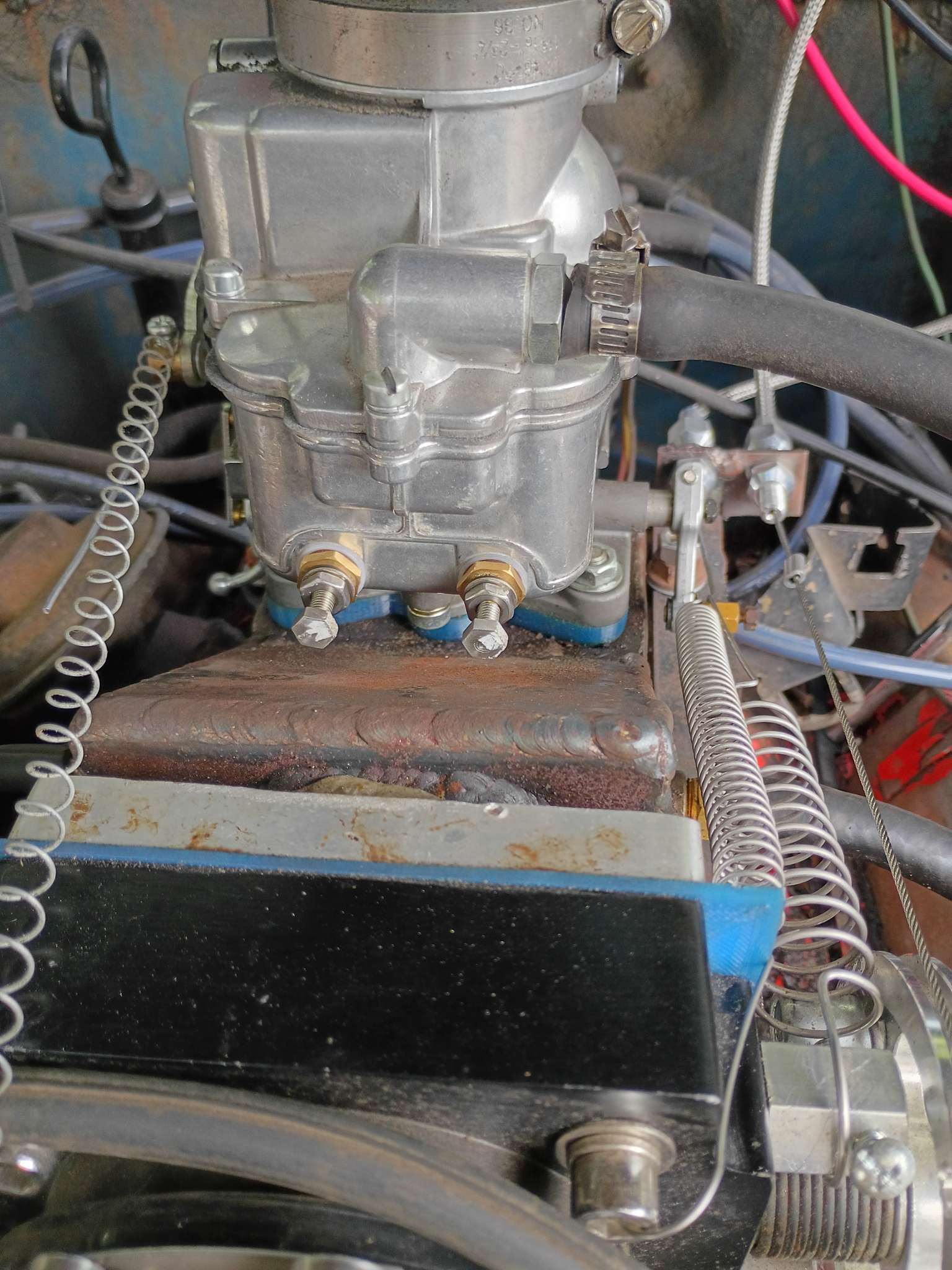

I relocated my second return spring, the adapter arm has a little hole for it but it doesn’t work by itself in that spot.
The bigger spring is hooked closer to where the cable is attached and the little spring is closer to the shaft. This lightened my pedal and it still returns to the same idle.

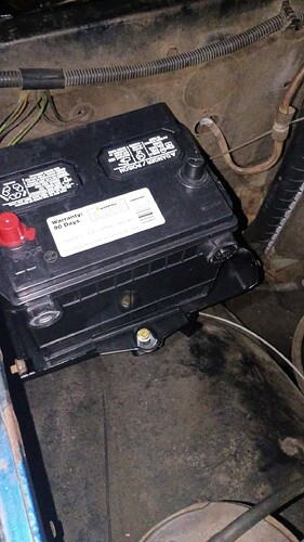

I also ordered an auxiliary battery tray for the truck to do a dual battery setup and give me more reserve for startups. I had to replace my battery just this week and we got a bonus so I bought two identical batteries. Group 75 or 78, I forget which exactly but they’re the same size to each other. 650 CCA, 80 some odd minutes of reserve. It helps that both of these batteries are the el cheapo types that have both top and side posts, I can connect the batteries together with the side post terminals.

Got the auxiliary battery tray installed, 3 out of the 5 bolts are actual bolts. The two in the radiator support are 1/4" self tappers. Also added a cheapo saddle blanket seat cover, the original was actually decent besides the vinyl starting to harden. It’s good enough for the girls we go out with.
