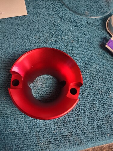

Finally got the air cleaner adapter for the 420cc Predator that is used for the 9000w generator from Harbor Freight. It adds an air horn that allows you to hose clamp on a pod filter, which will let me hook up an air mixer to the engine. Very gentle taper down to the carb bore size.
Here’s the Amazon link to the specific one I got, they also make them in the size of the 212cc Predator(Honda 196cc) and the Predator 670cc.
GREHUA Upgrade Air Filter Adapter… Amazon.com: GREHUA Adapter Compatible with Predator 301cc 420cc 13hp 15hp GX340 GX390 OHV Engine Stage 1 Mini Bike Go Kart Golf Cart Lawnmower Pressure Washer Generator : Patio, Lawn & Garden

I’m planning to mount the entire unit on its own wheeled buggy, separate from the generator but just as mobile hopefully. I can most likely recycle my ammo box filter for this build, worked great with a 2 liter engine should be no problems with a 420cc engine.
By the way, I will be adding a nipple to the air mixer so the valve cover breather still gets sucked into the engine. I don’t want to mess with any of the designed system, a lot of minibike guys just use an air filter but I feel like that hurts more than helps and they just want a quick solution. Any vacuum lines running to the current box will be rerouted to the air mixer assembly. Main goal is to still be able to seamlessly go from gasoline to producer gas via the fuel tank petcock and some adjustment of the mixer. The occasional use of gasoline will help clean the valves of soots if any get through.

I just stuff a piece off of those green scrubby pads in the hose. No need to complicate its just a crank case vent to keep presure from blowing all the seals out. Keep the weight off those bolts Ive broke quite of a few and those bolts generally snap off flush with the block. And how they manage to cram a full bottle of green lock tight into those small holes is beyond me. :fire:
Yeah I was planning to make a brace for the PVC pipe that will plumb into it clamped to the frame of the generator. Either that or high temp hose. Mixer will definitely be not near the carburetor to keep the majority of the weight off of it. Going to make the air adjusting valve myself, I’m thinking a spring loaded butterfly with a thumbscrew for a hard setting once it’s dialed in, I figure engine vibration would otherwise rattle it out of adjustment.
