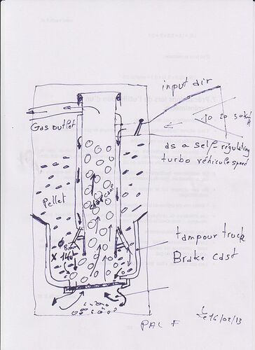

wood pellets work thanks to a metal cone which acts as a turbo and autoregulatory function of the vehicle speed of the injection of air gasifier brandt you can see above the little door where I work on the photo the pellet volume consumes three times less than the pieces of wood and traditionnnel this process I have automatic ash removal system that prevents mechanical ventilation also between the fuel in the lower part of the gasifier which facilitates the passage gas zone pyrolyze.

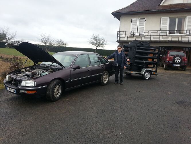

Fourth output opel senator 106 KM / H

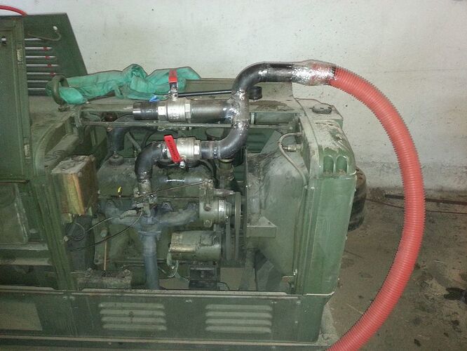

Production of electricity and heat exchanger plate on échapement gasifier with the Opel Senator by a generator on a military peugeot 403
Congratulations Francois. Looks like a good run to me. I wish I had level ground.
Thanks for posting the video but please include the smile next time , I know it was there.

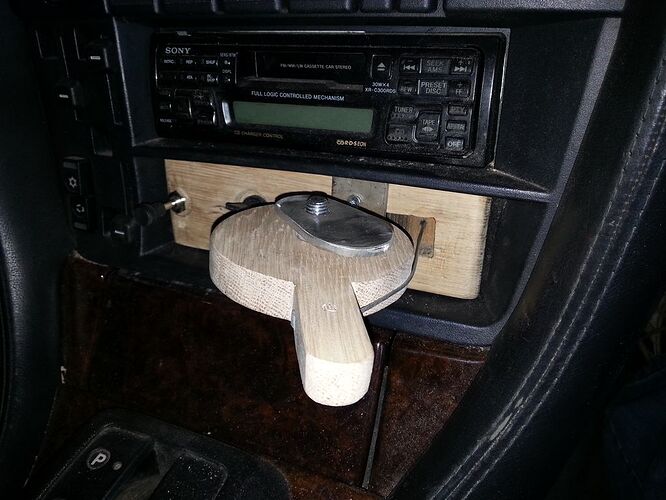

Photo adjustable air damper,
inquiry
above 3000 engine rpm
the engine is flooded, what solution you adapt to change the ignition advance on electronic Delko finally able to use the gas above 3000 tour.
Cordially.

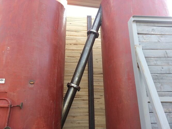

attached a photo of Pope Jean Faucher gasifier, which I am proud of my achievement to discover him.
link between the gasifier and the first silo designed with cooler
http://jamclasses.drbanjo.com/static/dimages/liaison%20gazo.JPG

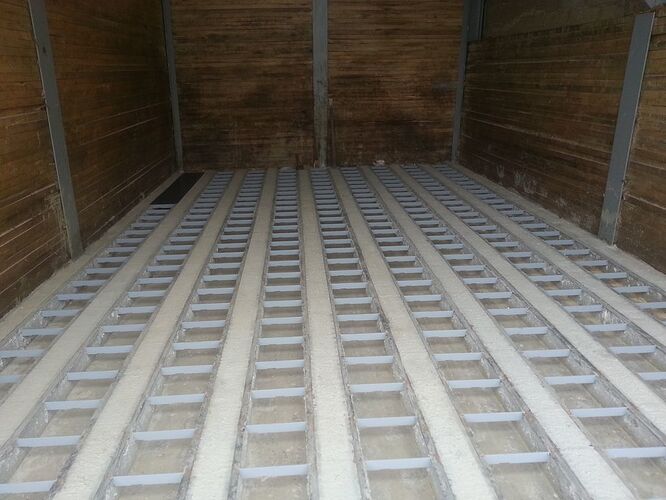

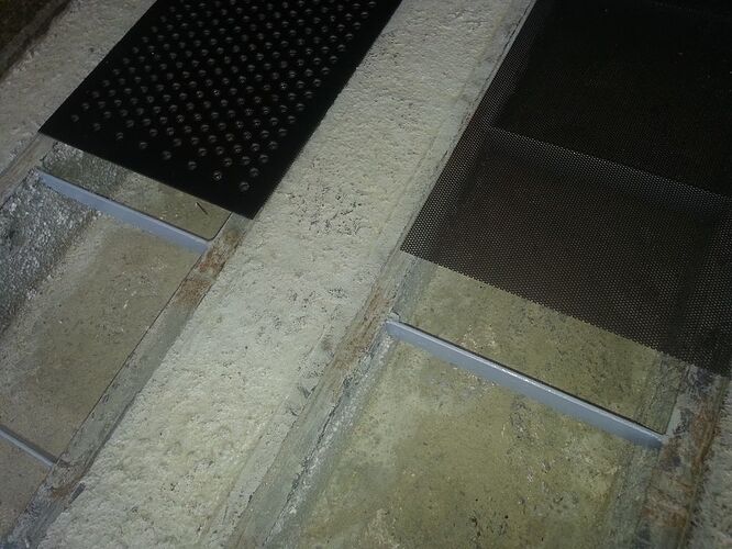

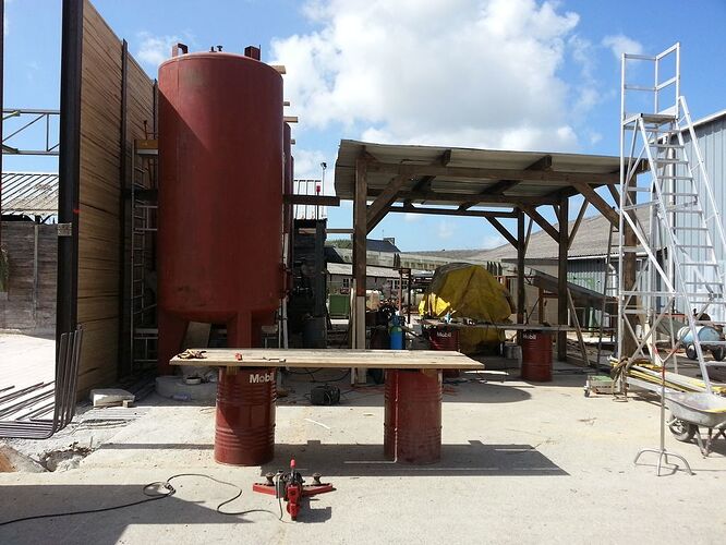

photo of a wood drying slab

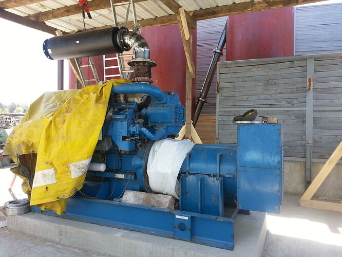

recuperation of exhaust leaving the gasifier cummins and gas using a large fan (30 000 m3 of air per hour), hot air passes Travert both gin and dry the plate timber on top of 3 ml.
