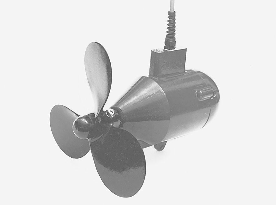

https://nooutage.com/aquair-uw.htm
I have the stream usable for 9-10 months out of the year.
Appears to be a DC electric trolling motor reversed.
A different manufacture says their same type of unit needs a minimum 4 foot depth installed to make the power. I only have that maybe 4-5 months.

Anyhow that manual download is very needs-to-be informative, yes to do a trolling motor adapt. Their UK developed $1,000 base system was made for corrosive ocean and tidal basin usage’s, too.
The for-military system I’d linked to previously, was painted and instructed for man packable remote conditions, to be installed very, very discreetly. For recharging communications equipment’s.

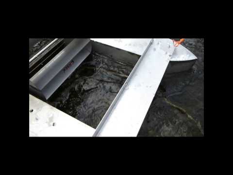

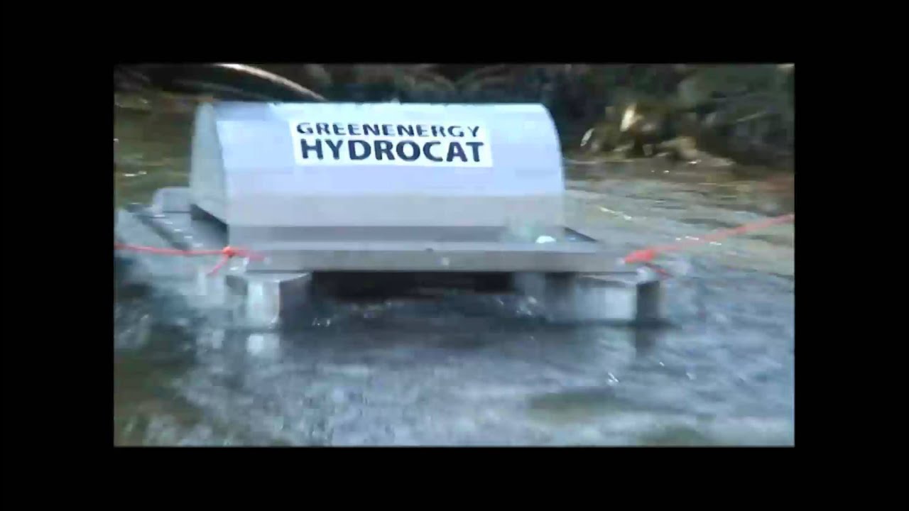

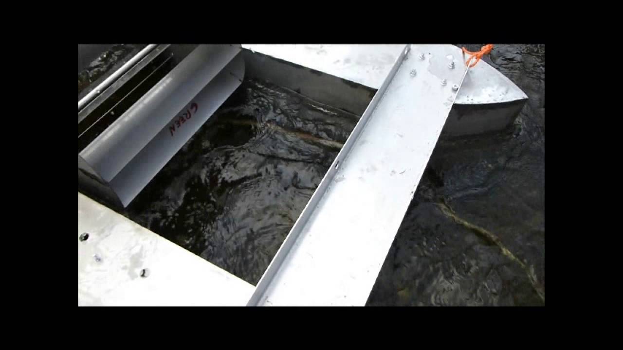

Anyhoo, yes, you can use a brush dc motor from a treadmill as a generator. However, in your case I would try to use an automotive alternator: 1) they are made to run slower 2) they are ruggedized to the point where salt spray will go right through them without doing any harm.
Thatwas the issue I was running into is most alternators want to see at least 2000 rpm to start making amps, and there is no way to do that direct drive on that float. I was looking at stealing the gear system off a bicycle to get it up to the correct rpm, but was looking at other options so bike chain didn’t have issue with rusting or gears not shifting and the like
The hydrocat doesn’t use direct drive. They have a 2-step gearbox which you can see at 1:11 in this video hidden where the hub is. Since it is a boat, you may need to register it as a watercraft. They appear to be about the size of a paddleboat, so hiding it as a stump or rocks probably won’t work unless you downsize it. but you could ‘dock it’ against the shore without being to conspicuous especially if you put a seat on it, because ultimately you can reverse the motor and it would power the boat.
treadmill motors max at like 90v and 18 amps. They typically are belt driven so reversing the pulleys and using a belt might be closer to what you want. But really if you can use a belt around the outer diameter of the paddle, you will get a bigger gear ratio.
I should also mention, I don’t think they are getting very much power from it. I suspect one treadmill motor is about all it can handle.
