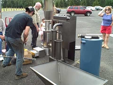

An old video that was sent to me today. Old, and the youtube channel not had any activity for over 10 years so watch before it unsponsored, goes down unveiwable.
Note the actual SS tall skinny gasifier. This one is my personal unit now since 2012.
I was not at this particular BBQ-Picnic-Demonstration. You will not see me there.
This gasifier unit was Grandfather to the later commercial production all-SS Victory model, Victory XL and Hotwatt units.
This developer unit; set up this time, I think, was to use raw hardwood to make over-augured out charcoal(with the ash), with the reduced offgases as engine grade fuel gases.
Note the tubes sock baghouse filter.
