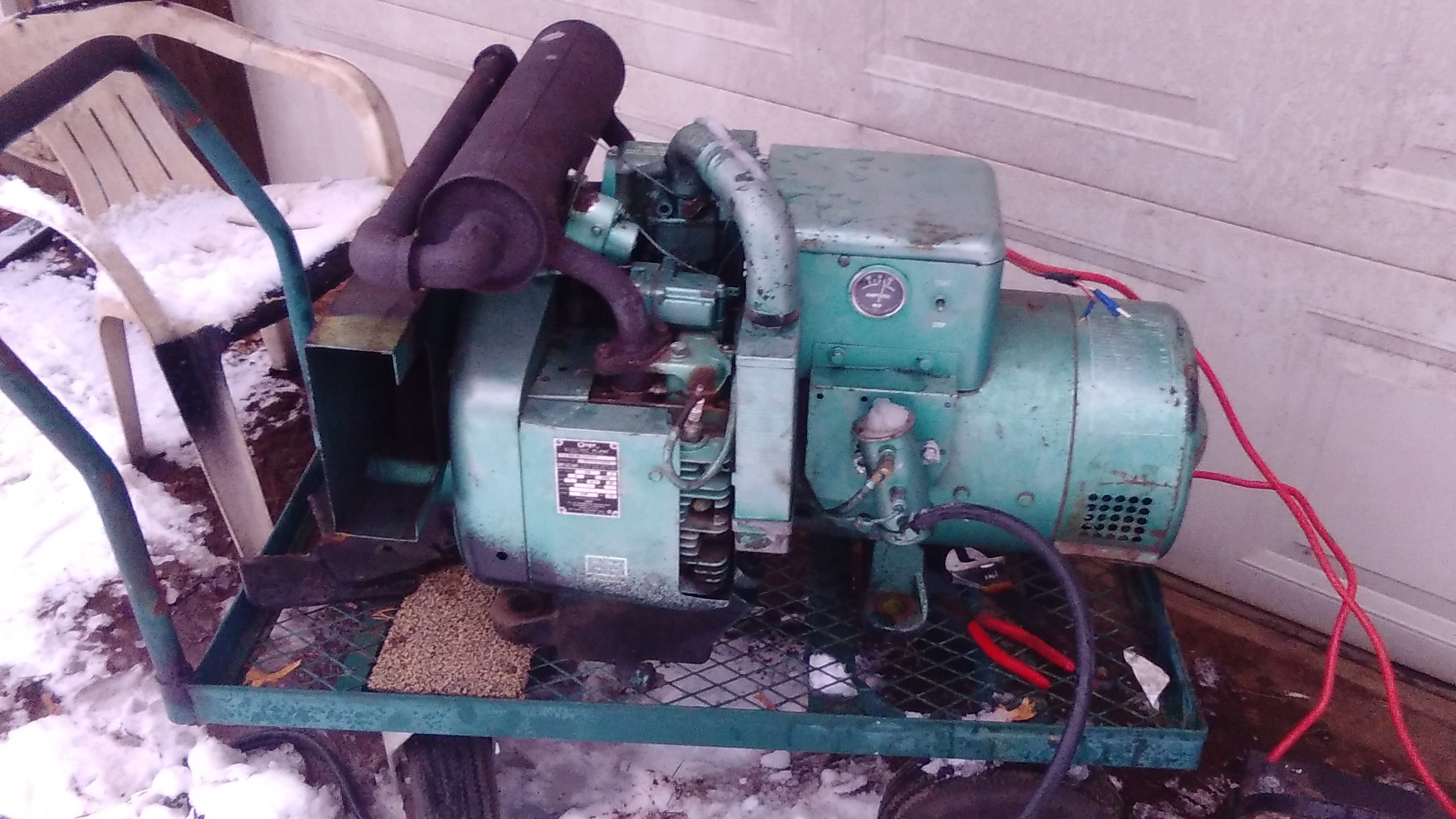

Thanks for the heads op on these Onnan,s wood gassing well Steve I will have to try it. Apparently I was only running at half power today Feeding my breaker panel with a single 20 breaker. I was afraid with such small intake passages the might not wood gas well. !/2 the RPMâs is a good thing.
Benâs old Lincoln makes mine look like the antique it is.  I dug some snow away from mine so it could thaw out of the ice yesterday. but it snowed rather than thawed today. I think this will be first to choke down the smoke. What I wouldnât give for the liquid cooled Miller. Some day. I gotta get Benâs book.

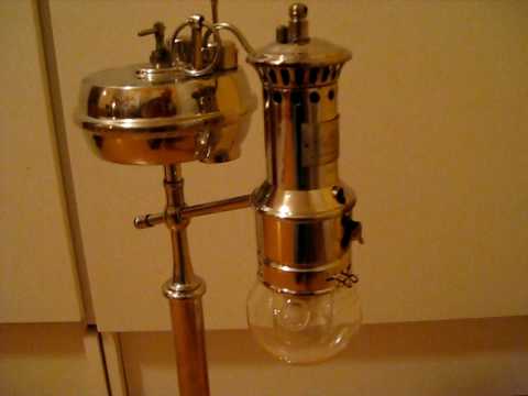

For Jan:

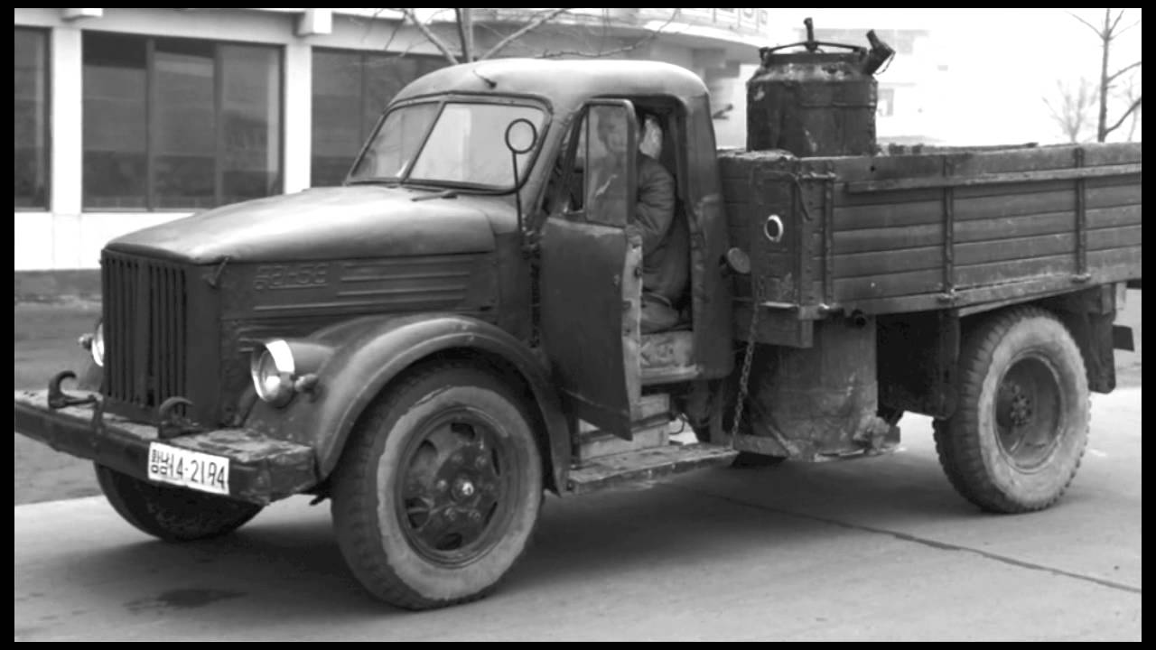

From the producer gas era when benzine was in short supply the alternative for lighting at night.
I have never seen anything like this made for North America or western Europe ( or eastern for the that matter )
Thatâs pretty cool⌠Seems like itâs a bit of a deathtrap, but pretty cool!

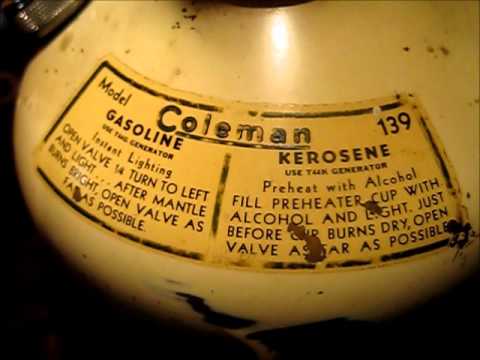

At the same time on our side of the pond we were buying gasoline power table lamps.
This brings up a very interesting question.
Would it be more fuel efficient to burn the fuel in a mantle lamp than try and charge a battery for an LED light?
BTW I suspect that in the hands of a responsible adult one could safely use a liquid fueled pressure lamp with at least a wide a safety margin as a handle or wick lamp.
Now if we are on the subject of lighting dare I consider the idea of producer fueled gas lights?
There was a time when gas actually made at a central gas works and plumbed into peoples homes.
Seems reasonable enough one could do the same with a producer gas plant if they built a small gasometer to store their own fuel
Well given the fact that the earliest use of producer gas was for home lighting, we know it would work. BUT, Knowing that a major constituent of it is CO, I would be more than a little reluctant to pipe it into my home.
Now using it in a mantle lamp is an interesting idea!  They give great light compared to a flame. I wonder if the woodgas would foul up the mantle?
I have not watched the videos but I have read that it was more efficient to generate electric and light a bulb.
Producer gas was never used in homes but illumination gas was, etc. More difficult to make.
I have an Aladdin lamp that uses both a wick and a mantle. Donât use them unless you are sitting right there to keep an eye on them. As they warm up, they burn better. If you have cranked them too high too early, youâre in trouble. Amanda over at aladdin-us.com is super nice and has some great Amish hand made jams too!
