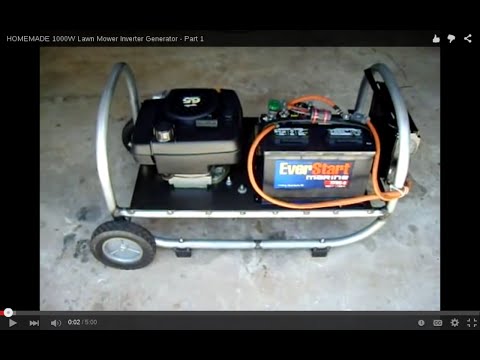

I am searching for video’s of DYI guys able to do this with common lawn mower engines, car/truck alternators, battries and off-the-shelf inverters. Safe electronic powering for penny’s on the dollar.
OK now. So my experience say I can at best with off the shelf engine generators make from 3kw/hrs to 11 kW/hrs of electrical energy from one US gallon of gasoline.
Now how to do this without spending out high dollars for the hardware.
How to do this in a “Petroleum Emergency” AFTER the Grid power is down. The Internet suppliers are all gone no-power bye-bye. The brick and mortar stores all been looted.

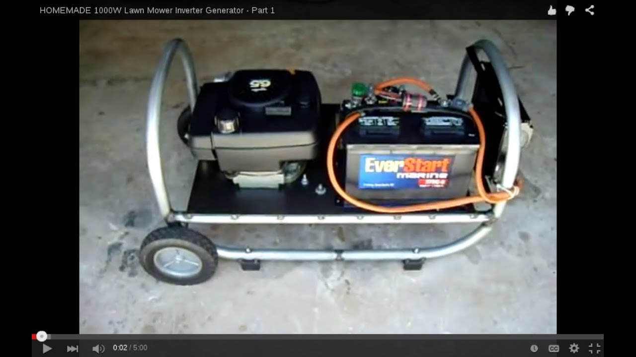

Great build example because it could all be done without any power tools at all.
Could be done with the mounting framework ALL out of wood (how I do these!)
Farther down I will list out how to double this guys stated 2kW/hrs per gallon.
Beginning of the video you can see this guy really does know the best engines and gen heads to get the the best fuel-use results. THIS video he is showing how to do with only lay-about pieces. Hurrah!
Much better build quality. So good as all-metal that he then got to diagnosis out functional problems his all-metal “quality” had created.
You must listen to the audio to really understand that “wood does it better”. Ha! He did put in a needed backside belt slack tensioner. Riding lawn mowers have these as take-off parts on the engine to axle belt drive.
Even at a 1000 watts electrical though he is wasting gasoline. So . . . maybe . . . 3kW/hrs per gallon.
Now here is a system example that with just two-three changes could make 4-6 kW/Hrs per gallon running efficiency.

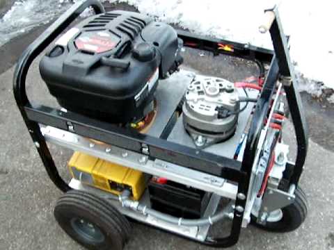

My way.
ONE: Always use a newer model lawn mower overhead valve or overhead cam engine out of a power wheeled application. Common here now. 15-20% better efficiency than any “flathead” “side valve” version.
TWO: Always use A PAIR of dual internal fan alternators; opposed mounted. These are common on mid-1980’s and later Chysler/Dodge/Jeeps and Japanese vehicles. Fords after the early 90’s. GM after the mid-90’s. These are 60-70% efficiency units. The old external fan units in these videos are only 40% efficient units.
THREE; using the larger 190-230cc sized engine then able to adjust down the running engine base speed of 2600-2800 RPM. This puts you in the best engine torque/fuel use RPM. Still enough RPM for enough cooling air flow and oil lube splashing.
YES. Use his two batteries. Set up the mounting size trays for truck Group 31 batteries. Then able to mount in almost any common auto/truck/marine batteries.
But now with the two opposed mounted alternators each going to it’s own separate 750-1000 watt inverter and battery.
This will evenly side load the lower engine crankshaft bearing.
This will power load down the engine for best fuel use results.
Give you US/CANADA four usable plug outlets.
OR: one side AC power - the other side deep draw 12VDC live generated power. Each alternator then able to charge back it’s own battery the best from these uneven power take-outs.
Give two parallel separate systems for redundancy.
Anything on one side goes down: pulleys, belt, alternator/regulator, inverter, battery and you still have 1/2 total system power. Use the same-same parts on each side building up and then you have have on-board spares for always having at least 1/2 system generating power.

Could someone please explain/draw how the “opposed mounted” works here?
Is this having a 2-belt pulley on the engine shaft; one belt going to an alternator on the “right”; one belt going to an alternator on the “left” (making an 8 shape) with everything “facing the same way” (ie all the pulleys face “forward”)?
