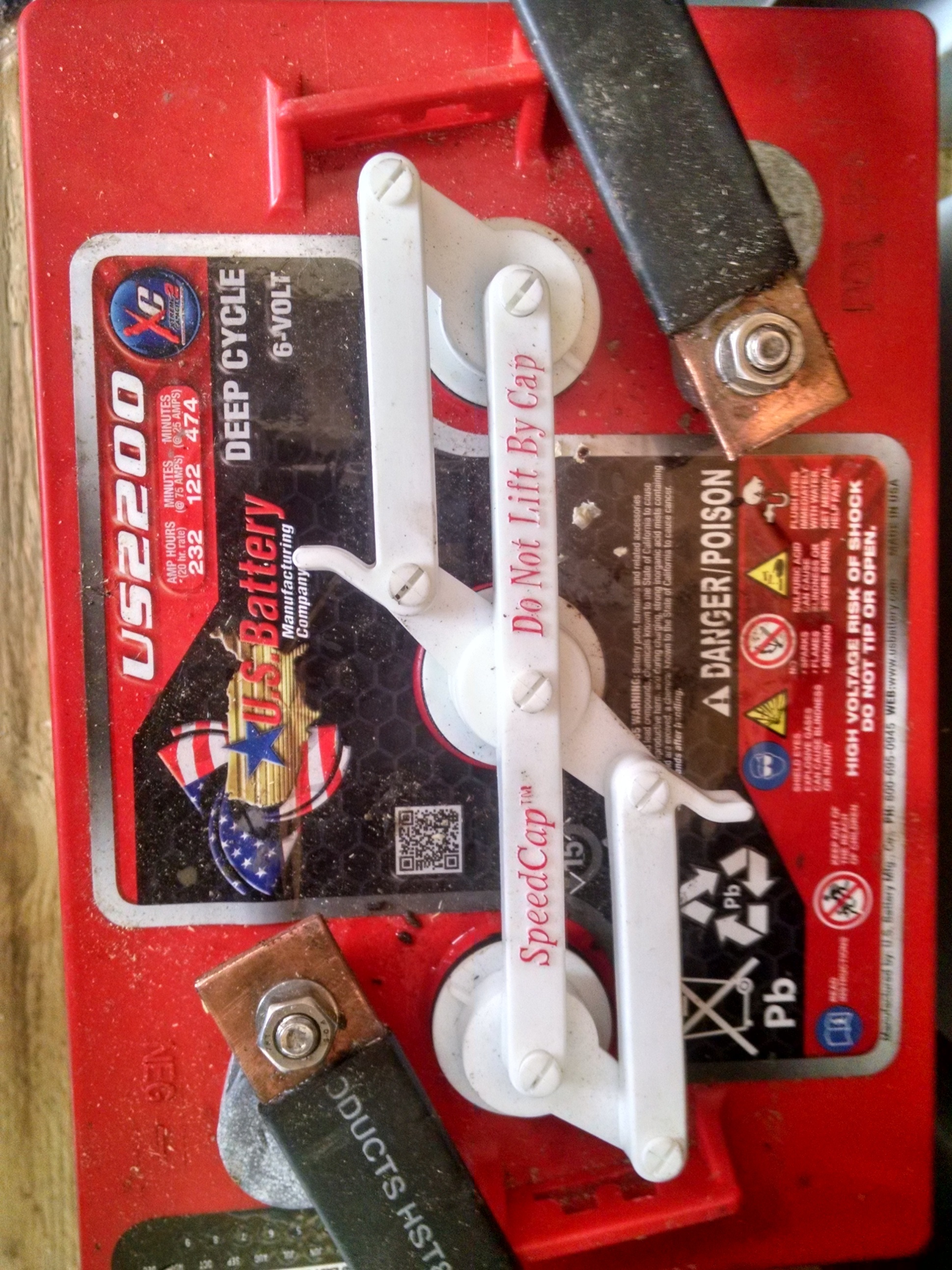

I bought a 10K Perkins diesel for this winter. A friend came over to help get it running. I nervously rewired my inverter to accept 240 Volt input Saturday with the help of a video conversation with a friend 200 miles away. What took 6-7 hours with the Ryobi to charge my battery bank, now takes 2- 2 1/2 hours. I left the 120 Volt input hook up intact because I want to charge the battery bank on wood gas next year.
What does all this mean? I donāt know because I have been a robot feeding a generator with gasoline. I give myself some credit because Iām not just flipping switches and paying a bill at the end of the month as I did my whole adult life prior. This last year taught us, any electricity wasted directly results in the frequency of filling up gas cans, then filling up the generator and getting the generator to start no matter what weather at least twice a day with no sun. I do have a 1K solar system and I smile every time the sun shines. I feel guilty because I still canāt tell you how much electricity I use. I can tell you how much energy it takes to go through the motions. That energy has been reduced to just pushing a button and now the generator starts itself.
I think itās now important for me to have an understanding of what it exactly means with real Wattage numbers. I have 8- 6 Volt batteries that are marked 232 Amp hours (20 hr rate).<----I donāt know what that means. If I am charging these twice a day and the inverter shuts the system down at 50%, how does that tell me what I use? Sorry for my ignorance but I think it may be important to know. This is a 24 volt system convert to only 120 Volts. When I need to weld, I have a different 13K generator from Northern Tool that has a home outside my new shop.
hi Bill, the short answer is 232 amps X 6 volts X 8 batteries = 11.136 possible kw if you take 20 hours to use that much⦠in reality its half that for 50% discharge if you want your batteries to last. your inverter is probably not shutting off when the batteries are half empty just when the voltage on the bank drops too low. Short of buying a battery meter and reading it in dc a kill a watt for figuring out how much your inverter changer is using and a whole house for how much you are using is the only way to go⦠No more or Ill clog up Steveās thread with my opinions⦠PM me if you want to chat about itā¦

Lead acid, and other battery banks are tricky to math out BillS, as this will change with the batteries temperatures.
