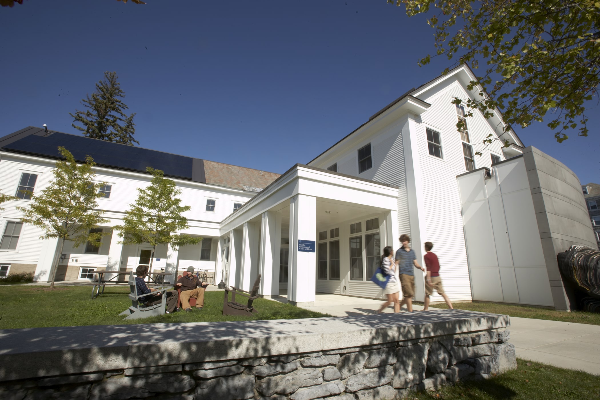

I don’t want to overwhelm people with information, but here’s a sampling of how these ideas are being commercialized.
http://www.renewableenergyworld.com/articles/2013/11/is-shrub-willow-a-viable-biomass-feedstock-in-the-us.html
