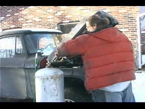

Just wondering if anyone has seen the youtube of the Guy with older Dodge is running his truck on Compressed woodgas?..I am still trying to find more info.
here is the link.

For your more info on modern usage of compressed motor fuel gases try this:
http://www.allpar.com/model/m/CNG-van.html
Talks about and pictures first Chrysler 1991 full size vans and then 1994 minivan factory CNG fueled put in production sold vehicles. Anybody wanting to compressed wood gas experiment should be looking for the DOT approved cylinders and equipment out of these. I certified trained for these. The mini-vans had forged aluminum/glass fiber composite cylinders to save weight.
If he would have used his effort on one these minivans he could have gone maybe 30-50 miles at full rated tank pressure.
He is not stupid stating that woodgas at 105 btu per cubic foot is only 1/10 the energy density of natural gas. This work as long as it is directly using woodgas to IC engine fuel I think is on topic.
Hmm. Yes I have once compressed stored woodgas for another fellows project to 20 bars - just shy of 300 PSI.
I did not like the equipment used, or the direction for the gas usage. The Energy balance of doing this absolutely sucks so I got âbusyâ elsewhere.
Hope this helps you along.

Hi DoucieR
In the mini-van example in the article I linked to a normal 18-22 US gallon capacity of gasoline fuel on board was then with more wieght in compressed tankage, brackets and armored fuel lines rated at an 8.5 US gallon gasoline equivalent in operating time on the CHG fuel. In cubic feet of fuel gases stored refined standardized methane to an average woodgas my napkin math says it would have a 1 to 1 1/2 US gallons of gasoline equivalent with the comperssed woodgas fuel on board.
This is half the Energy Pit equation. Other half of the Pit is it will take you just as much energy input in compressing the woodgas to 3000 PSI (~210 bar) as it took to compress fill with methane. Methane fuel costs were favorable overall to gasoline only in areas able to use discounted nightime off peak electricity to do the compressing.
This is Dennisâs topic question. I will say in a well designed, fueled and operated woodgasifier you will not have any tars at this point. They will have been internally gasifier heat converted to woodfuel gases.
The 2-3 fellows I know who have played with highly compressed woodgases are using three and four stage, and sometimes five stage washing, dehumidifing (drying) and filtrations systems to not have uncontrollable soots and condensates showing up at the compression storage stage and ruining their equipment. These extra steps requiring a lot more energy gobbling motors, complexity, expense and maintenance clean out steps then just a single stage âhayâ filter as in the direct woodgas to engine use Keith system.
These why for intermittent power ueasges like your pipe threader many have just gone to battery banks and inverters. Others to quicker in operation charcoal gasifier systems.
On my intermittent use woodsplitter, chainsaws and tractors it is just so much more practical, and quicker into operation, and safer to operate, to just pay the pound of flesh and buy a few gallons of Dino fuel annually. If ever that is not available you will learn to love the sound of your gen-set running on woodgas.
