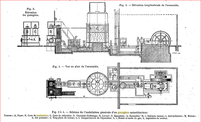

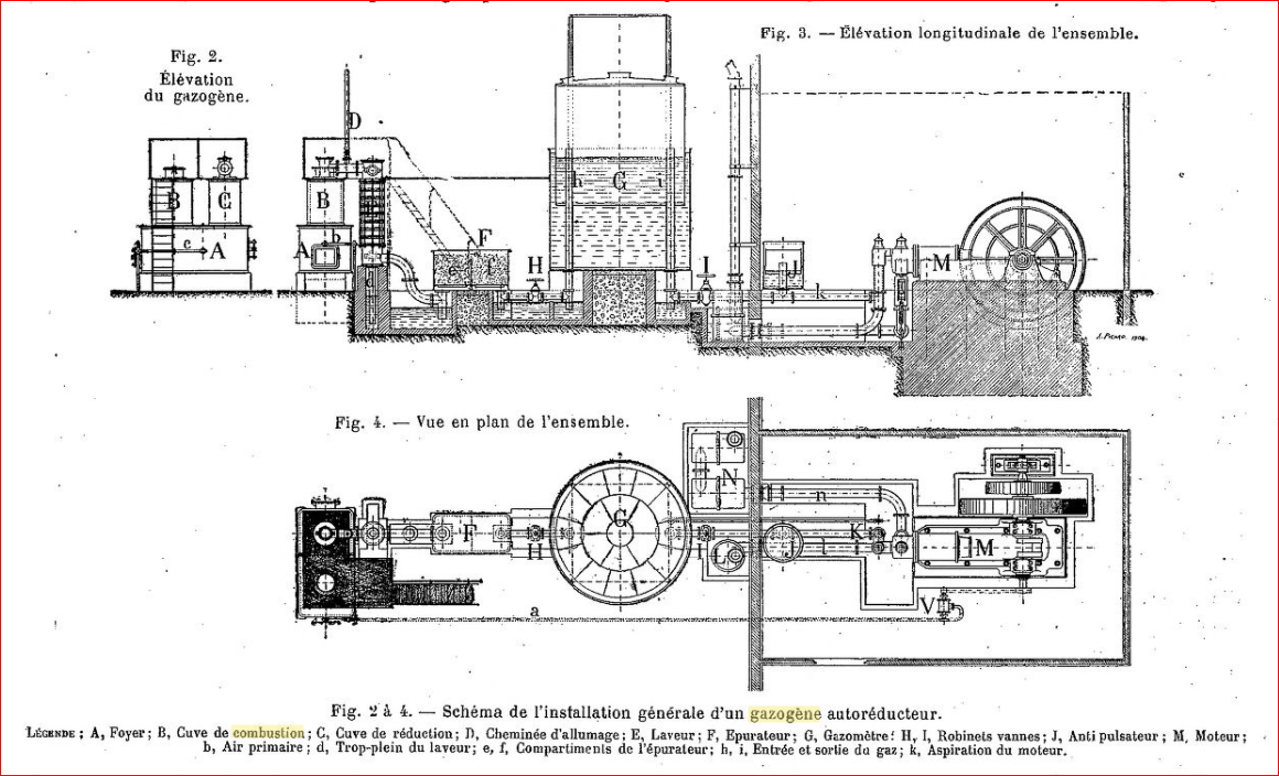

288/5000
The large volume in the center of the drawing is a gasometer, a tank that stores the syngas, its volume increases to the production of the gas and gives a constant volume for the engine and facilitates the decantation, the engine taking at the top of the volume its sampling, automatically the gas is cleaner.
Do you use the same name or is there a more common term for it down there?
