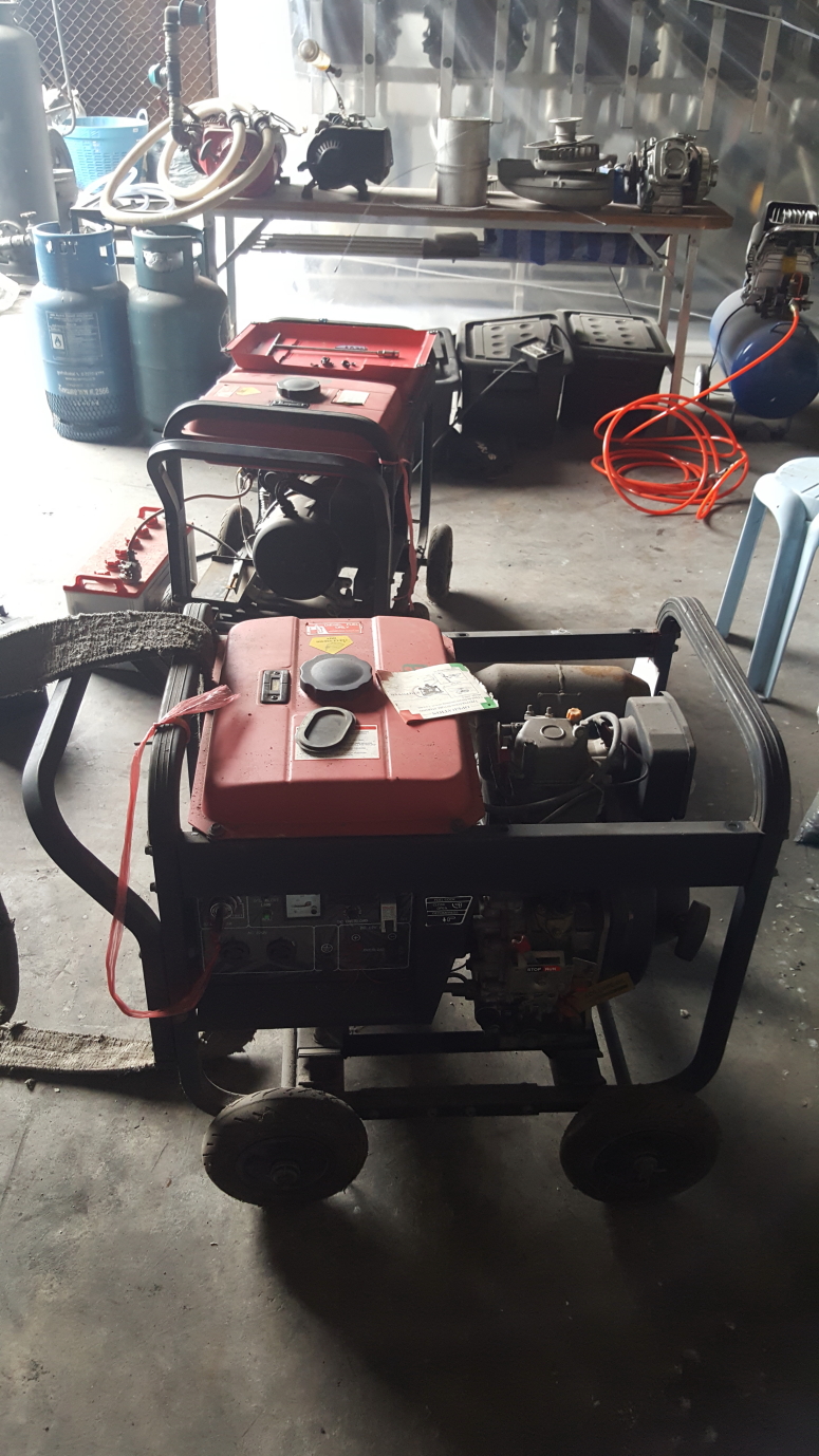

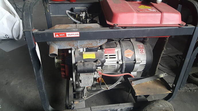

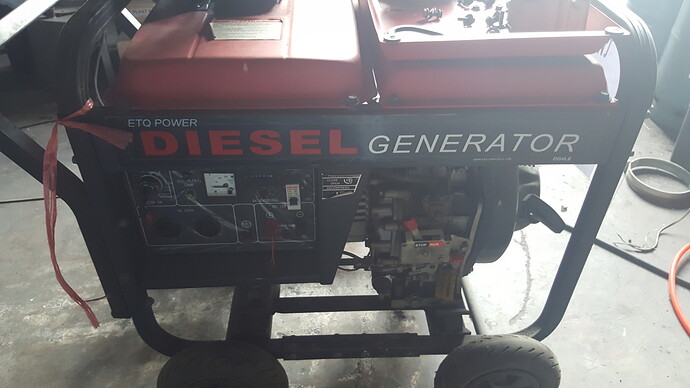

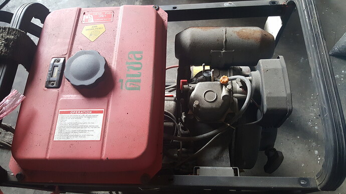

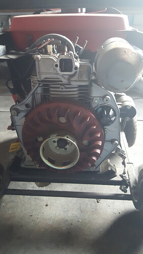

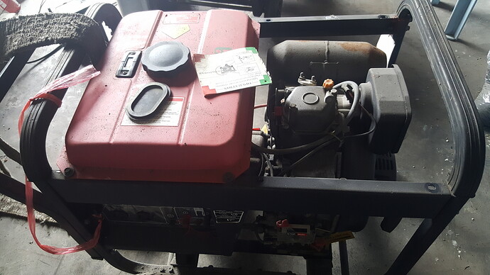

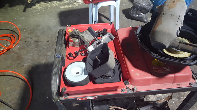

Did found 4 of these in my shop, hidden under plastic, brand new since 2010, only ran for about 2 hours and never started since.
And yes, of course i can “rebuild” them as i please… :grin:
Connected battery and started right away after 1 crank only… so, must be not to bad…

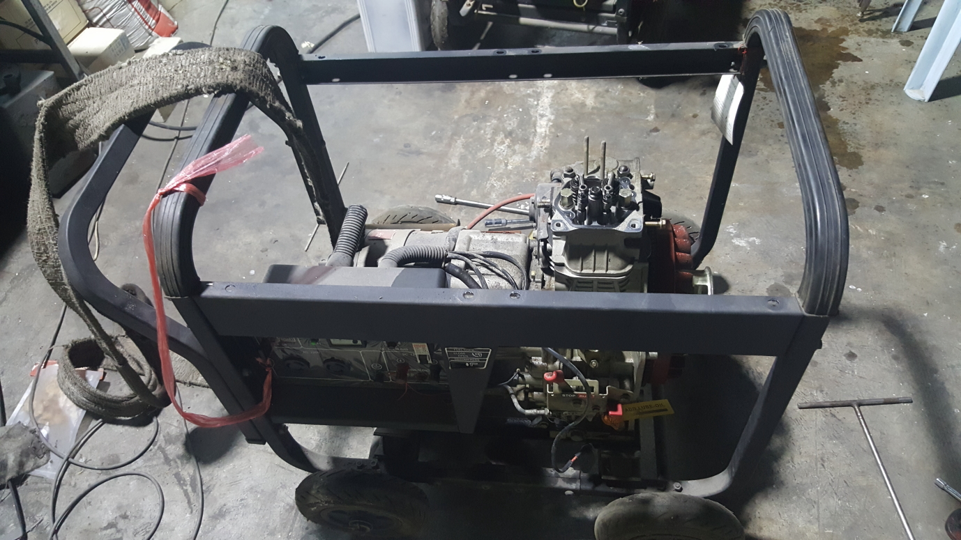

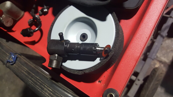

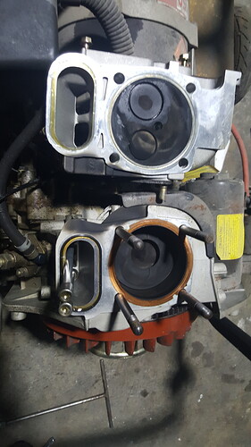

Stripping one down to check the inner parts
ordered ignition in China, Aliexpress
Link: AliExpress.com - Maintaining
DC voltage version, planning on installing it with a Neodynmium magnet and hall sensor.
Programable ignition timing only.

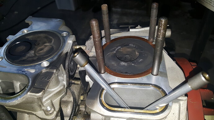

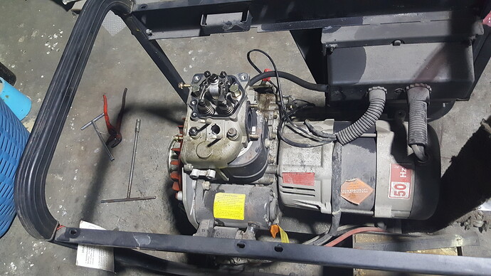

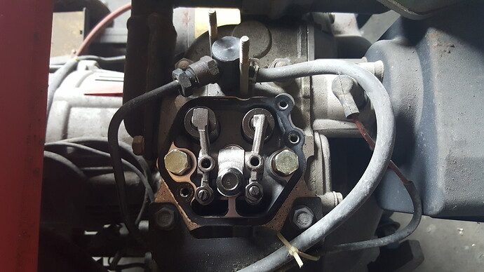

Pictures of the latest victim:
One hour further…
I can’t say that this is bad quality material… anything went smooth and no signs of lowest material quality

what compression this little engine?
Go planing the breech?

Not sure yet what compression it runs, will be measuring tomorrow…
Tonite looking for technical data on the internet
edit: could not wait until tomorrow, CR is between 17,5-1 and 18,5-1
I think i will do some minor modification only on the piston head, enlarging the combustion hole using a dremel
