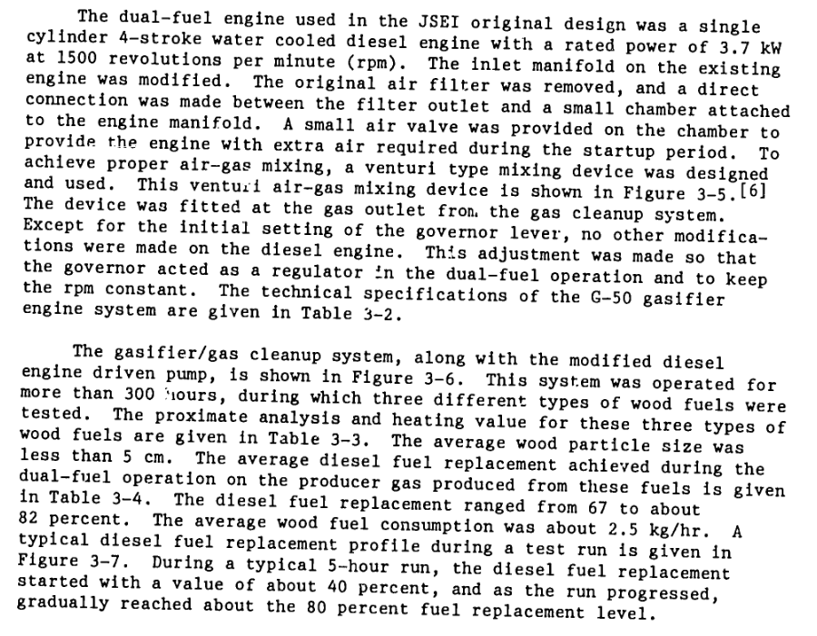

Kristijan, in the 1980’s there were some programs to use gasifiers with small diesel water pumps in India. They ran the engines in the hybrid or dual fuel mode, and the diesel fuel replacement started at 40% during start-up and up to about 80% while running. Here is a screenshot of part of page 39.
This is from a 206 page document: http://pdf.usaid.gov/pdf_docs/PNABH184.pdf
