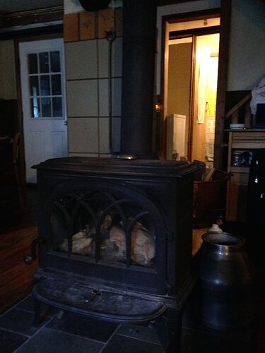

DickT your best explains to all woodgasification is shown out in your avatar picture out under those rain covers.
Your firewood stacks. Means you must have a way to turn that into Heat Energy.
You will never learn anything burning that up in a open fronted fireplace or open fronted stove. Opps. Wrong! Bad Steve! You’ll learn you need to have the fuelwood very, very dry to NOT be in place wet steaming, thermal quenching, dragged down to pitiful. Use/burn cords of it will show you well your base wood ash percent if you paying attention.
Now . . . put that cord wood fuel in a true “airtight” woodstove and then you can self-learn a lot about wood gasifing. Refer over to Mr Waynes, "Long road to gasification, expreimenting . . " topic about the differences controlling gasification by FUEL add amounts, sizing and even dryness. Then going the easier route by primary controlling by air.
Figure it. He learned these things perviously in his whole house heating bulk wood stoves.
With a true airtight woodstove, WITH a front glass viewing window you can now visual feedback train yourself for gasification achieved results. Make the pink flames. Blue flames. See my photo album here. Use/experience feel you way with heats, limited/controlled fuel adds, and adjusted air velocities on how to do this.
