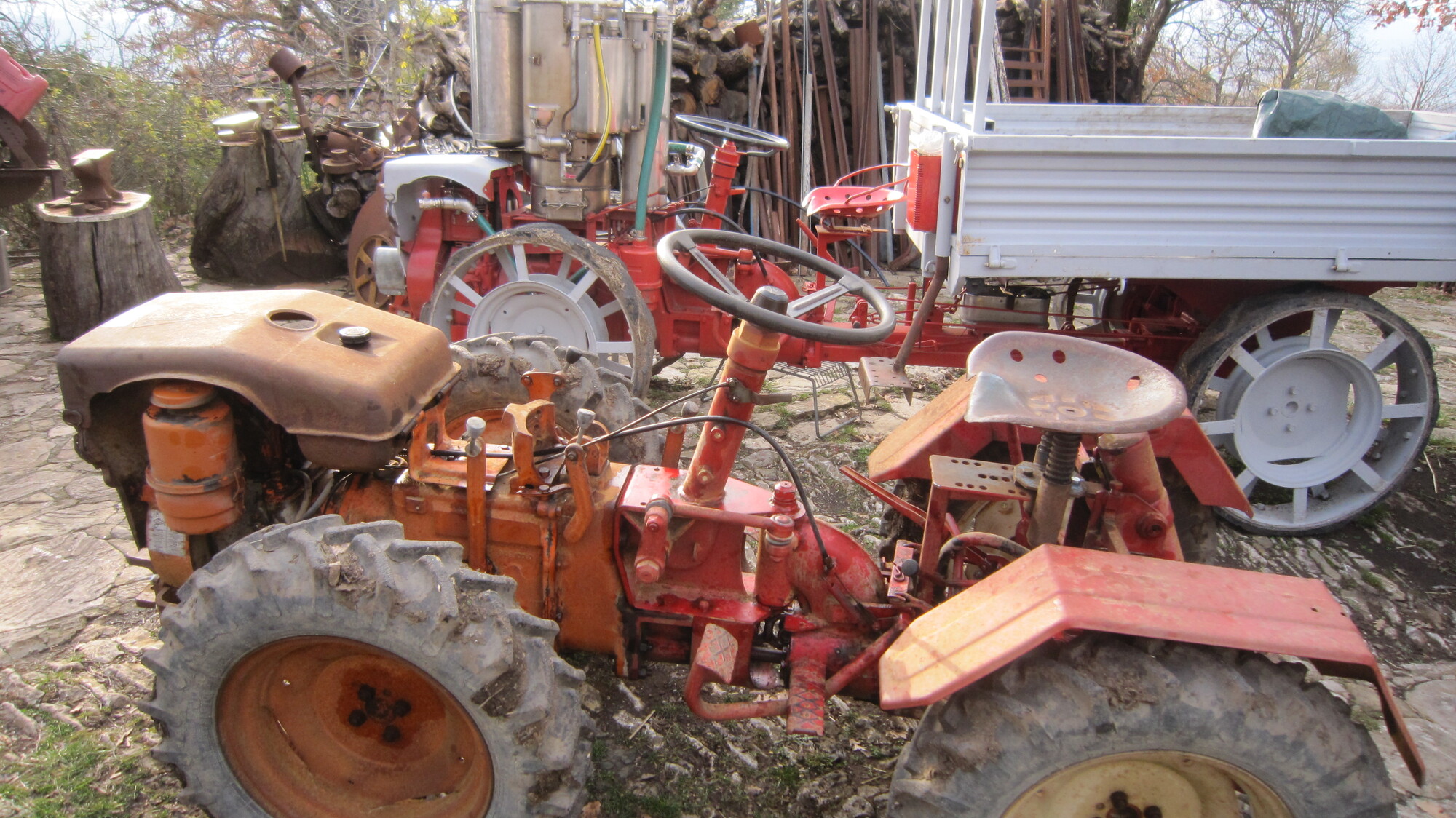

a new chargas candidate is arrived…my son cleans 8 hours…model 937 with 14 hp…the owner has 97 years, i told him from the gasifiers and he remembered that in his youth cars has driven with something on the back that runs with charcoal…

first we mounted a old bcs mower seat instead of the half gone original seat that was very down with his rubber foam , and keeps water like a sponge
the vertical filter with the water bath works 100 % fine, new spark plug from summer is after 35 hours like new, inner isolator very clean…the new engine will also get such a filter

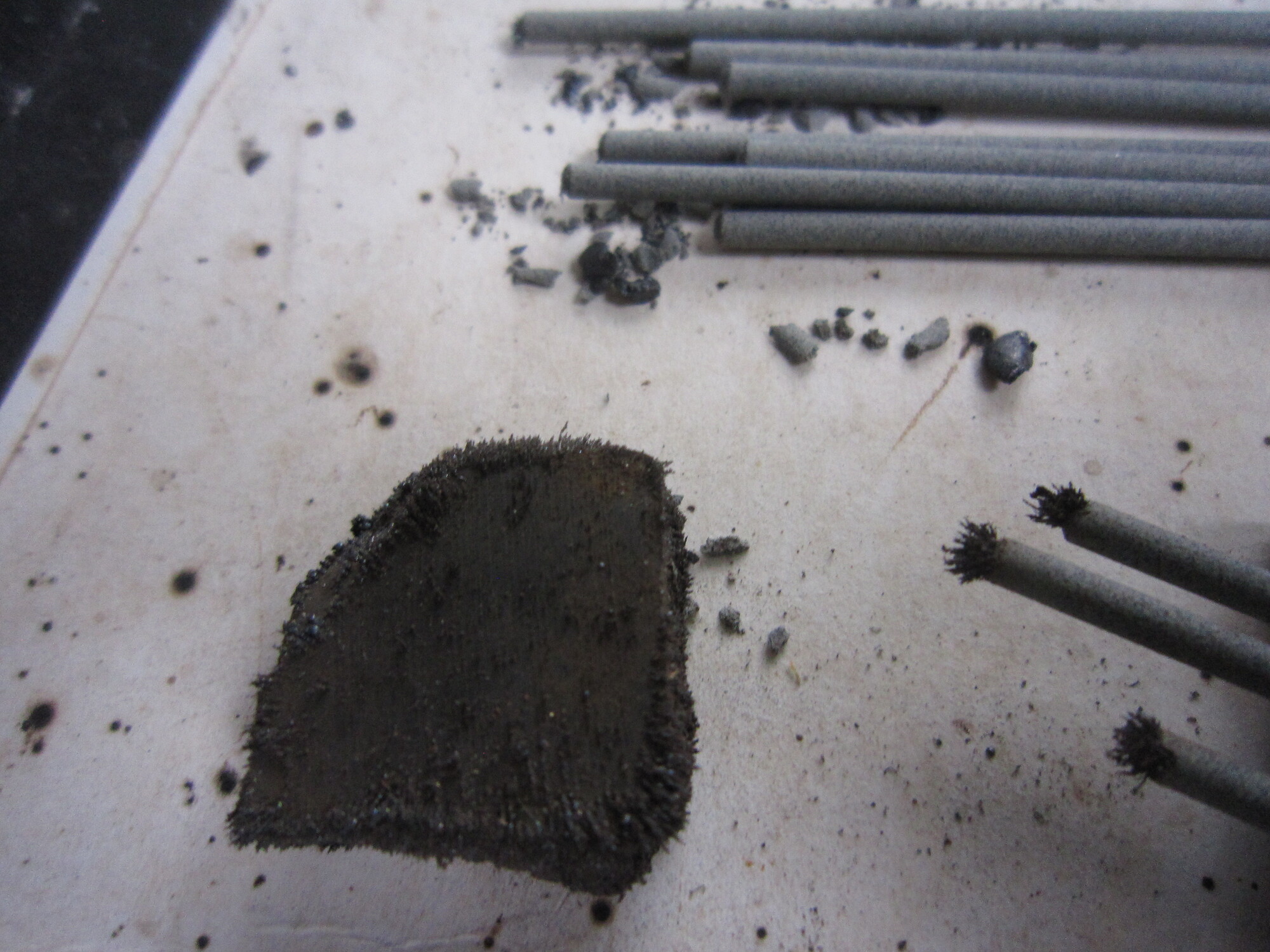

a secret for welding:
some interesting observation…i always cut the 1,6 mm welding electrodes with the angle grinder with a 1mm disc in half lenght, so welding is much easier because of less trembling…
so we discovered a interesting welding start “powder”.
on the workshop door is placed a magnete, and the magnete accumulates a lot of fine iron pieces from cutting…giving some of this powder on the electrode tip by touching the magnete, the welding electrode ignites perfect on the first touch with the welding object…of course works not with stainless steel
