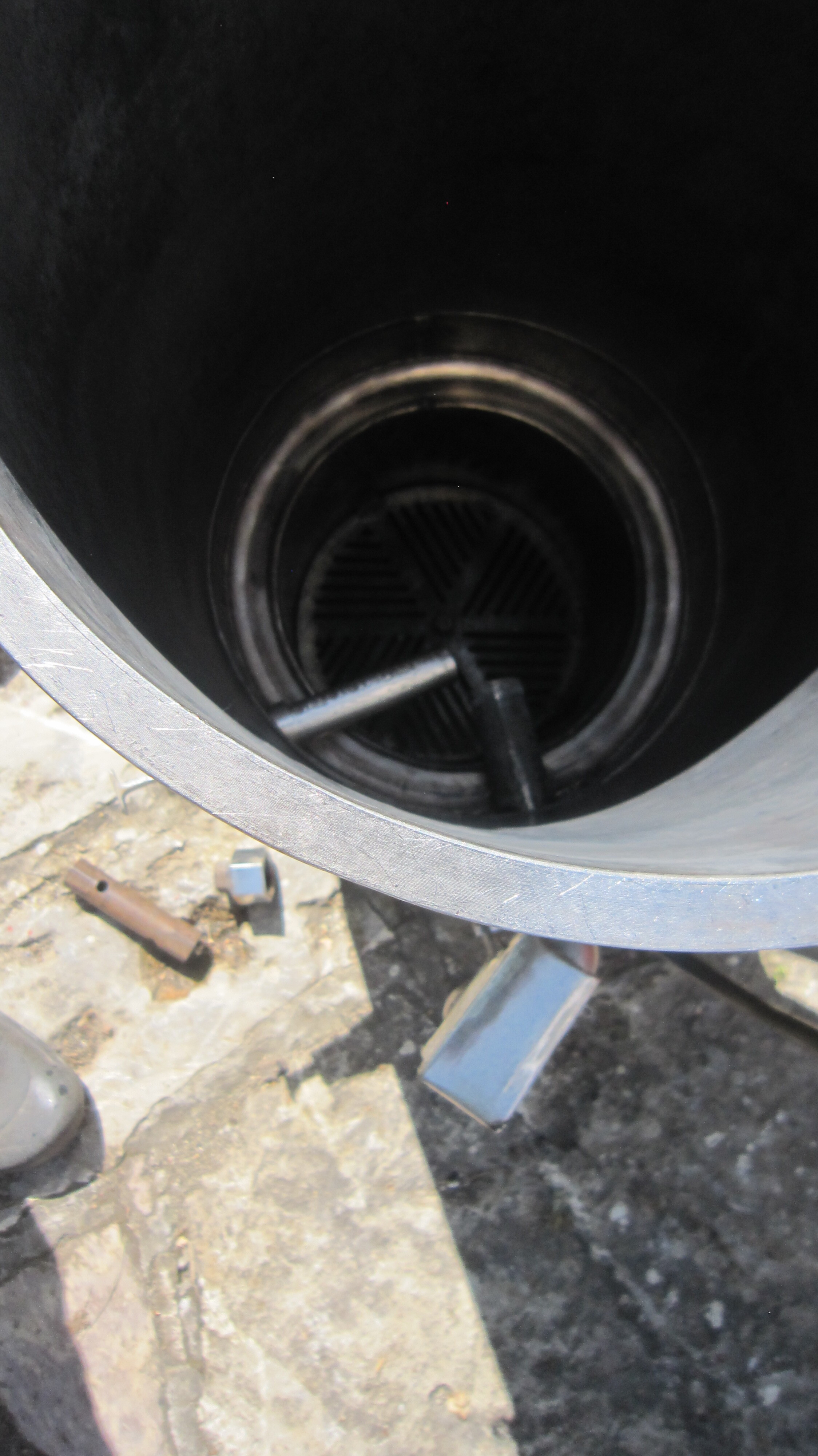

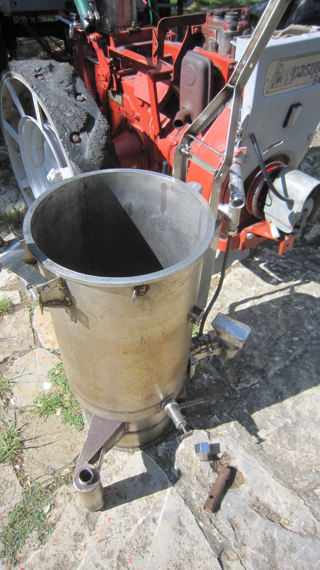

we made a ignition hole for the gasifier with coal pusher, unfortunately foto upload not works more…also with windows 11…the old forum system was definitively better…sorry
Too bad there’s no picture… Is the opening through which you light the fire at the level of the air nozzle? Or do you push the pieces of glowing charcoal directly into the air nozzle’s intake area?

the hopper ignition port works fine, so hopper level must not digged out till nozzle height for another ignition…only leaving the dust from the hearth area. doing this there remains a “bridge” of fuel thanks to the compactness of the hopper load by vibrations…poking than down the coal and igniting the coal at the igniting port…as i have positive pressure with my blower the glowing coal in the igniting port must be pushed with the coal pusher to the nozzle tip - see picture 1 left side

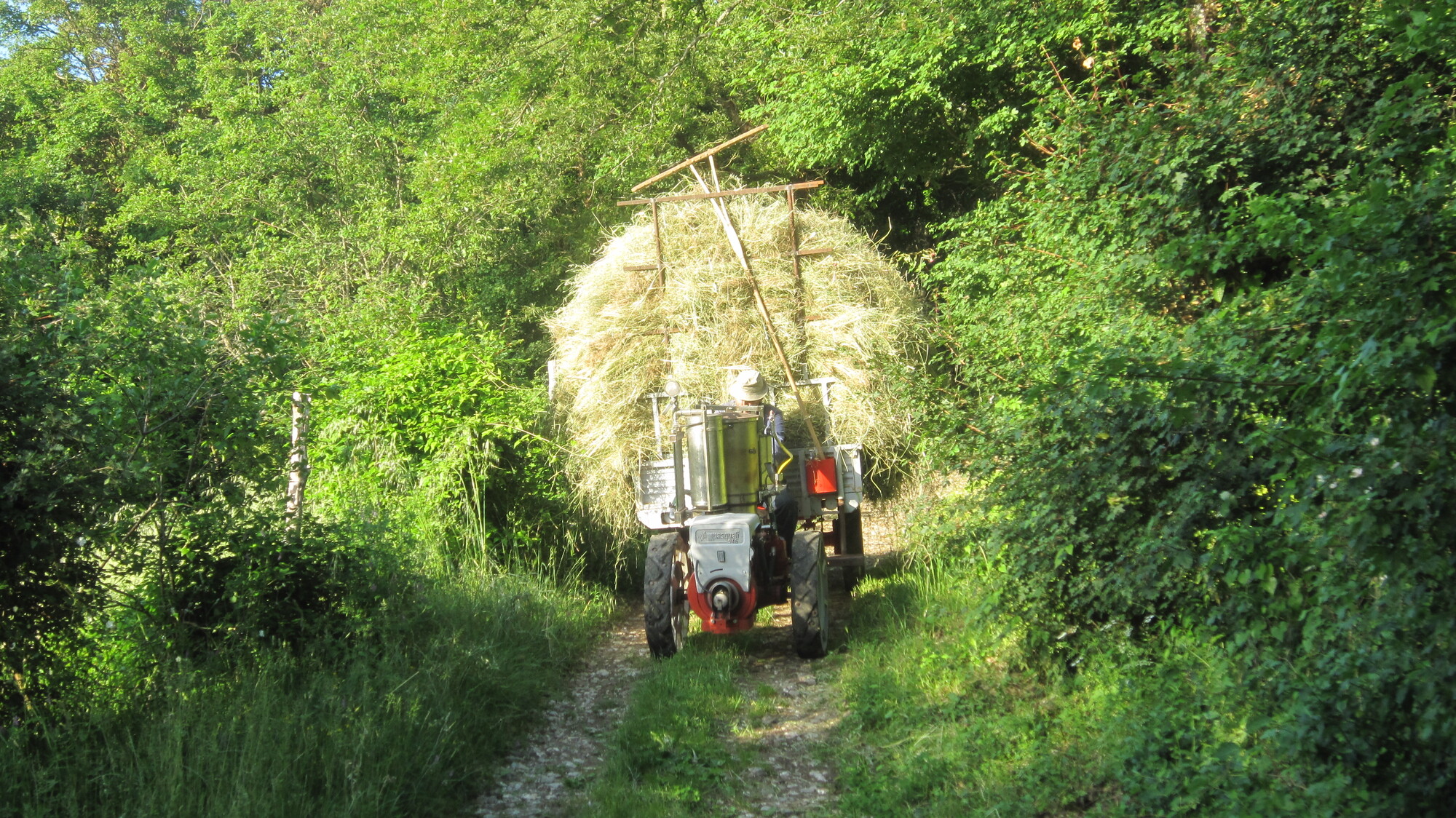

yesterday finished hay…pasquali on chargas with one of the heavy loads, and , yes the metal hay ladders were ready just in time some days before beginning…

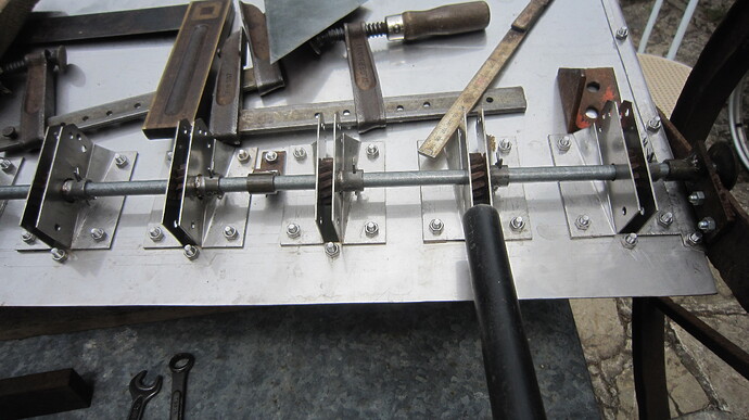

and besides other stuff…the seeder makes some progress when it not rains…should be ready in october for the seeds…

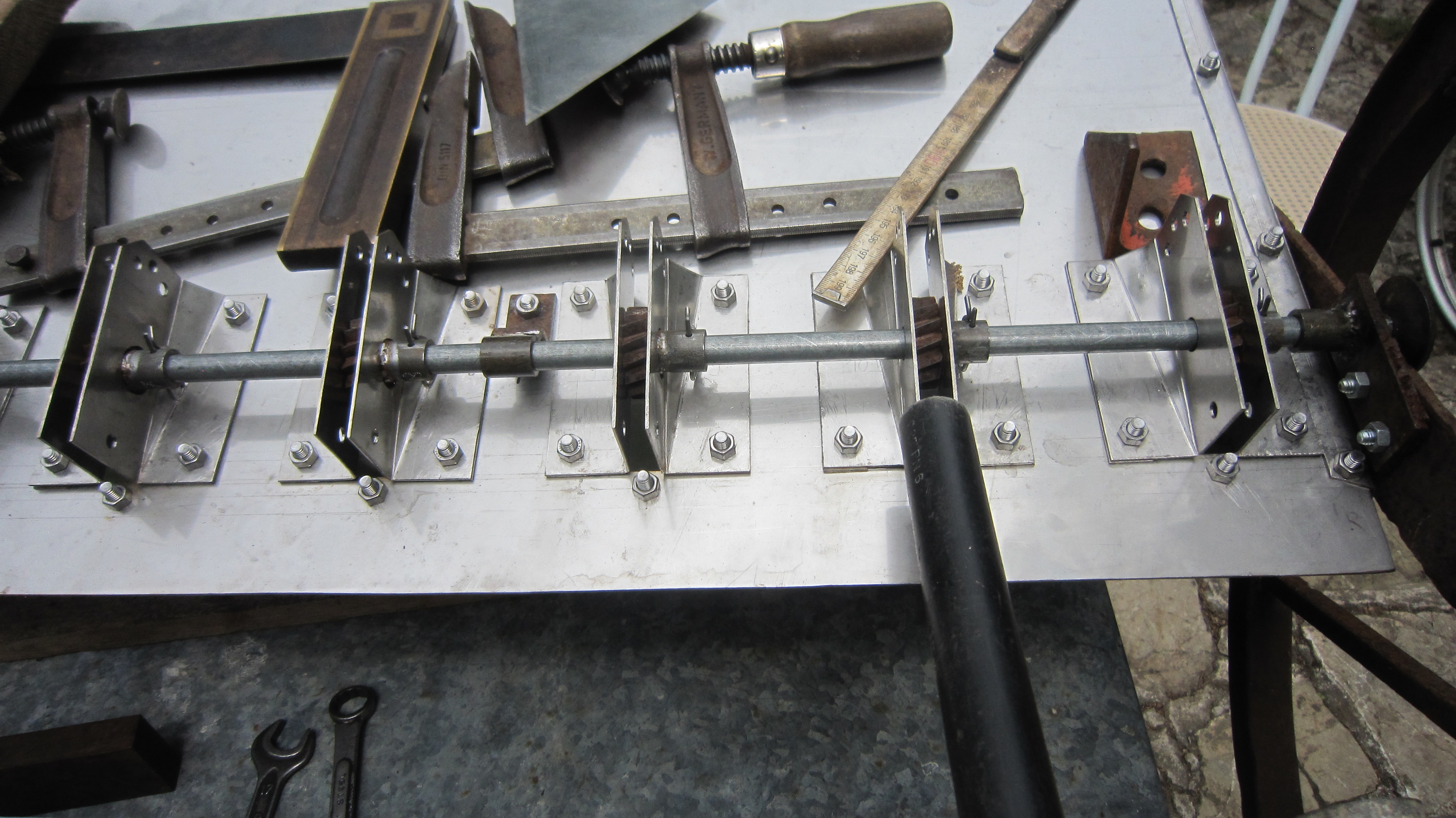

the crop box with the seed wheels…

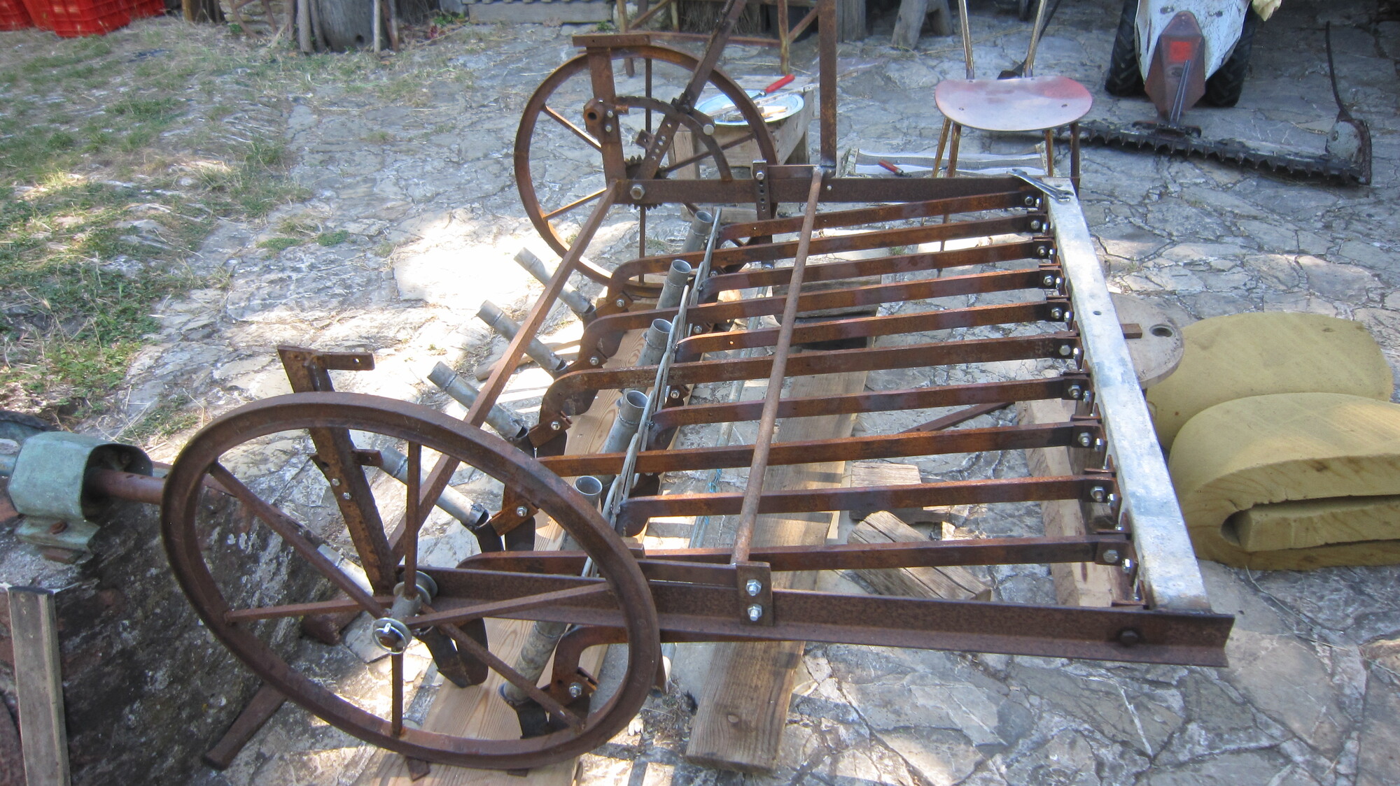

dry prove with the seeder on the harvested chickpeas field…seems works fine how it makes the groves in the ground. ( ground was worked in april for chickpeas)
