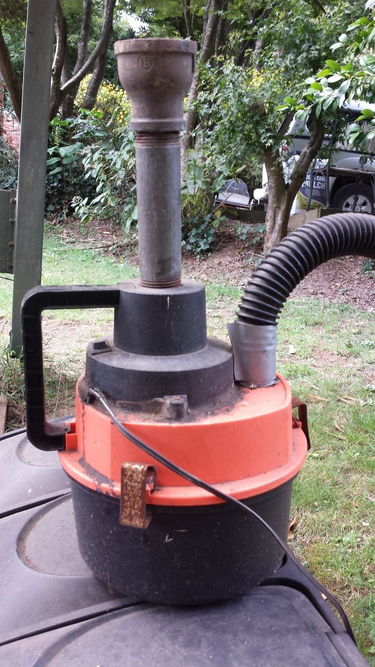

If you are finding that your flare will not stay alight once you take away your torch then that could be a couple of things , first off what does your flare tube look like is it just a plane pipe or does it increase in size with air holes on the bottom ?
The other reason for a flare not staying alight is air leaks in the system , my set up just point blank refused to stay alight one day after many months of no problems and I found that if I wrapped my hand around the hose going into my little vac it sealed off the air and straight away the flare kept going .
have put up a picture of my little 12 volt vac/blower and wrapped some tape around where the air leak was .
I
Dave, I don’t see any air holes in your flare pipe. Are they there?
Amazing to see this. I have used a similar flare setup with a similar 12 volt vacuum and holes are not needed.
I used a small 12v fan to test my charcoal gasser a few years ago and l juust culdnt get a flare without a torch. After some frustrating hours and a lot of dirthy words l found out the fan was built to suck some air thrugh the motor in order to cool it down. The resault was air mixing with gas. Just a strip of duct tape sealed the intake holes and the flare started burning strong. Maybee you gave a similar problem Triguax?
About the tar in your charcoal… sometimes there are small peases of uncharred wood that find their way in the engine fuel makeing some poblems. How do you grind your charcoal? l use a device similar to Garry Gilmores charcoal mill just that myne is hand operated. Whenever l feel a hard peace on the crank l stop and it is usualy one of those wood bits.
It is alsow posible that when you make your charcoal a part of wood is still charrinw while the rest of charcoal is alredy cool and it absorbes all that tar from the smoaking fuel. I put my charcoal out of the retort while it is still hot so none of the tar can reabsorb.
Well spotted Don ,
That tube I had on the vac has no holes in it ,as long as there are no high winds it works fine that way, and also allows me to connect a pipe to blow from there into the gasifier for leak testing , as soon as its windy I sit a tin can on top with small holes around the base and a 1 inch hole in middle makes a good wind shield .
