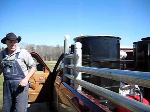

In this video from 4:50 -5:25 one might estimate dino usage.

I am curious about the amount of smoke/exhaust coming off your truck in the first video around the minute 6:00 mark. It seems to be about mid-bed, 2 or so feet forward of your rear axle. Is that an exhaust leak from a heat exchanger? Expelled woodgas that wasn’t clean enough to run through the engine yet? Straight-piped exhaust at the cat?

It might not be obvious, that video was taken in mid-January, temperatures likely in the 30s. What you’re seeing is water vapor “steam” from the exhaust, same as any car would make, until fully warmed up.
Thanks for pointing that out. The video might be misleading but on very cold morning there will be steam coming from the motor exhaust for the first few minutes, gasoline powered or wood powered.
Because I was demonstrating a cold start up there was no running of the motor prior to the light off.
Yes you are looking at the exhaust pipe about mid section of the truck.
The only area there should be any smoke visible is from the open hopper lid when refueling or reversing the air flow. When lighting the gasifier if there is any smoke exiting the blower ports or flare ports the char bed is poor. (Visible haze OK)
