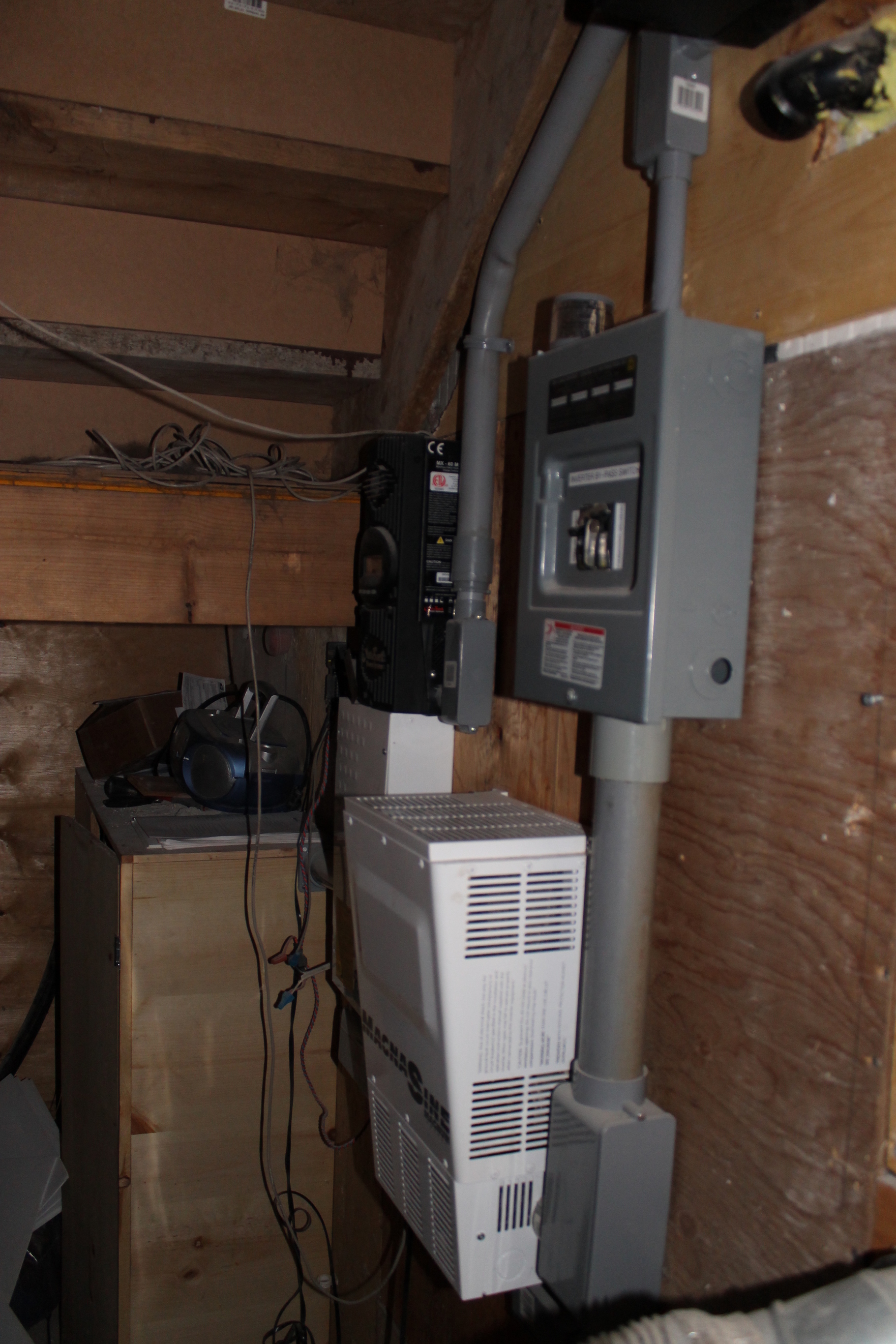

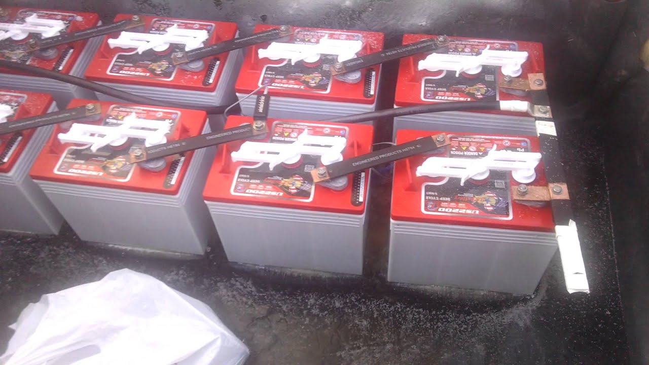

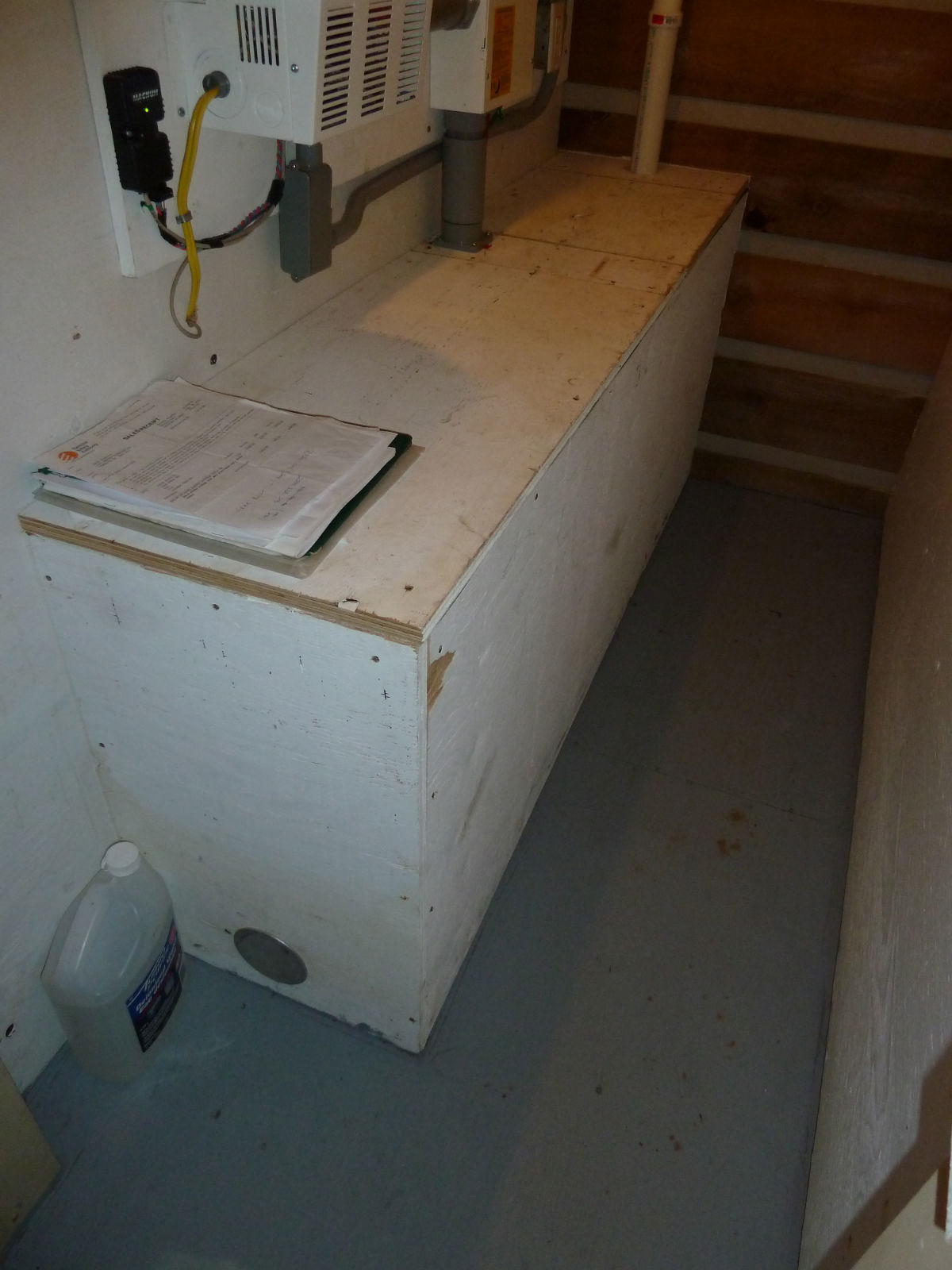

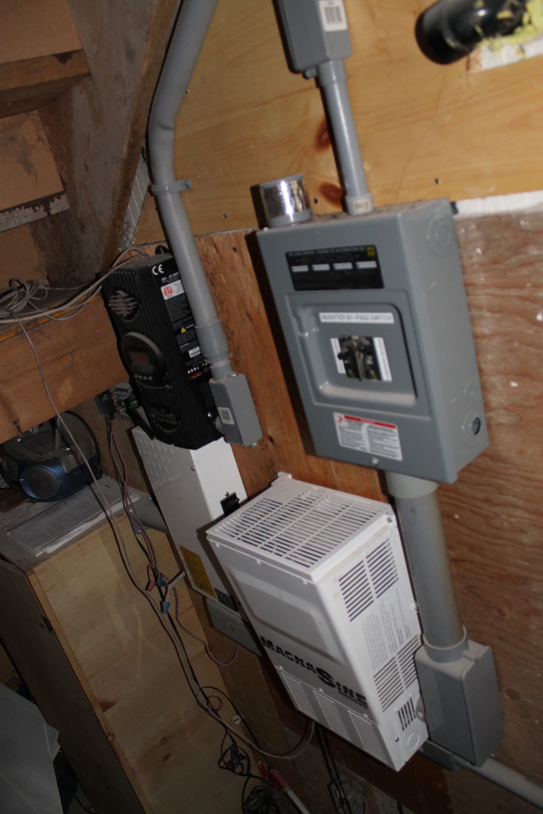

Hi Bill,
I was trying to find some pictures of battery boxes. Most seem to be lost to computer change overs…
Ist one is a system I worked on for someone, 8 X l16 size ones in a compact box, vented forgive the mess, I never took pictures for display…
2nd and 3rd one was our cabinet/battery box, again 8 x L16, vented, two rows of 4 to save space with auto waterers again to save space
