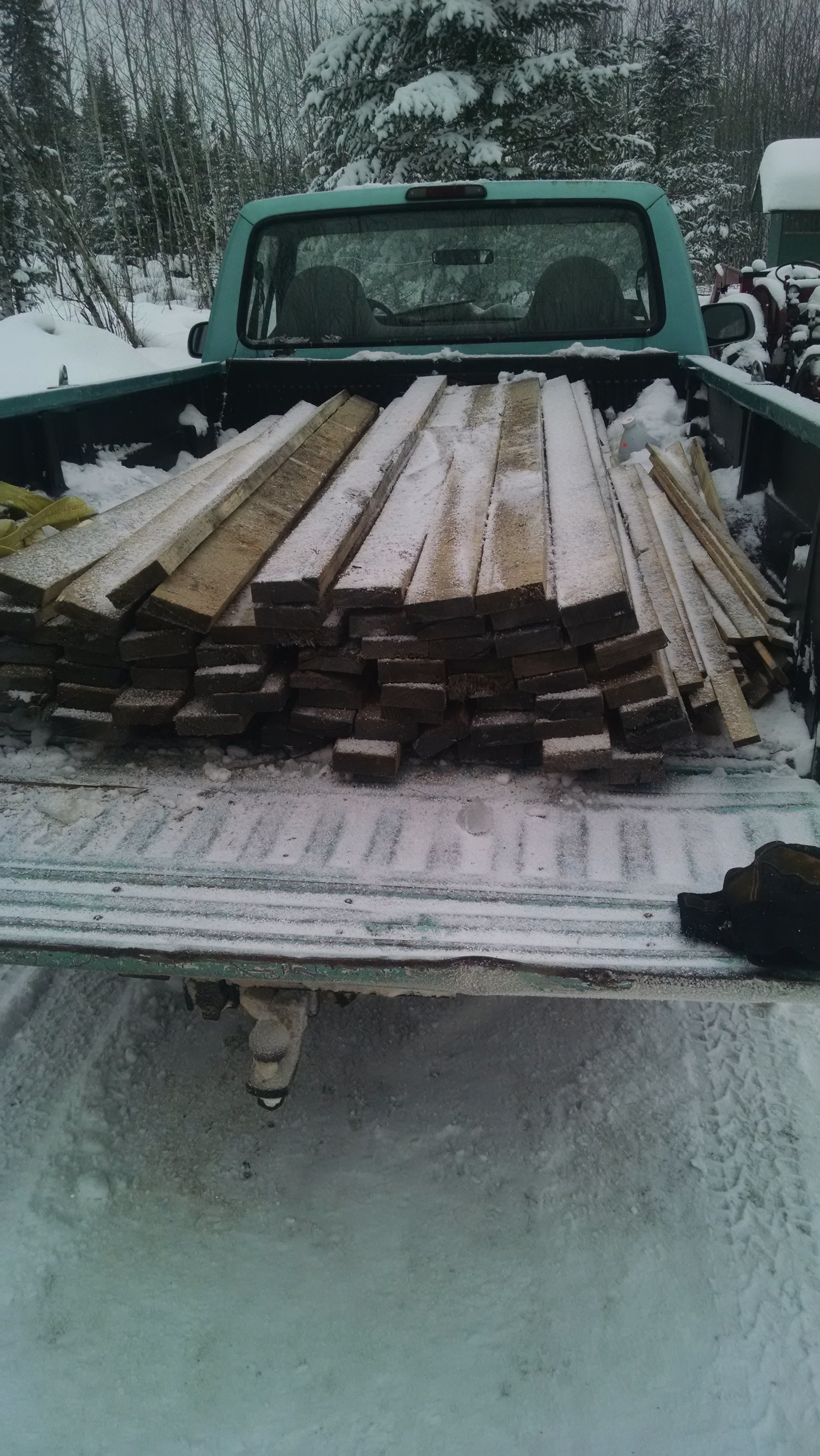

I also got a deal on a load of Aspen 1" x4". $20 for this truck load.

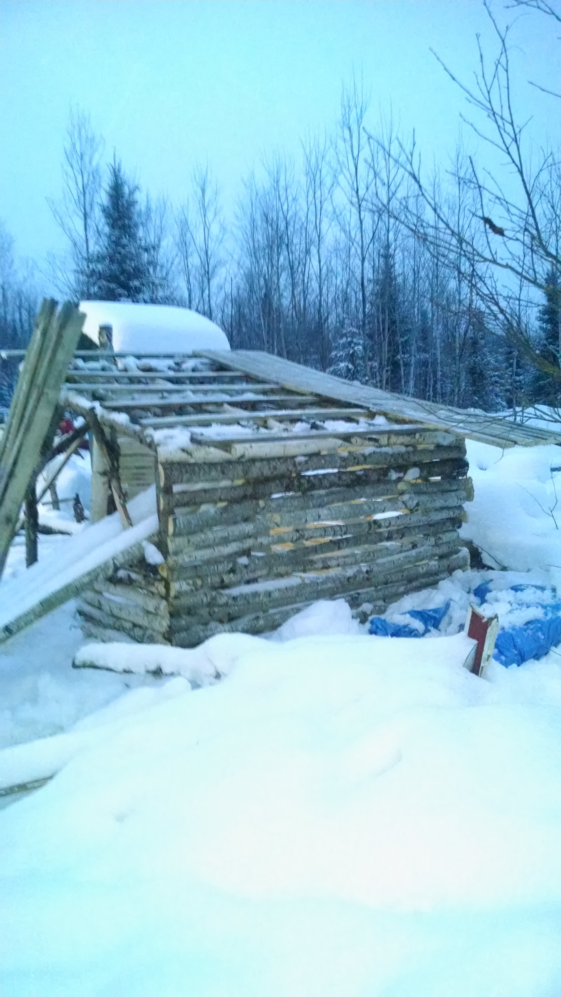

So I decided to use it for my wood shed roof.

Nice score on the lumber Bill. Wood shed is looking good. This is the sunniest winter I can remember since I have been paying attention. Man years we don’t have 10 days of bright sunshine from mid December till the 3rd week in February. Lots of overcast days. Sunny days just around the corner. Remember ice shacks of the lakes by March first. Maple sap time soon.
Thanks Jim, that’s the best deal I ever got with dimensional lumber.
