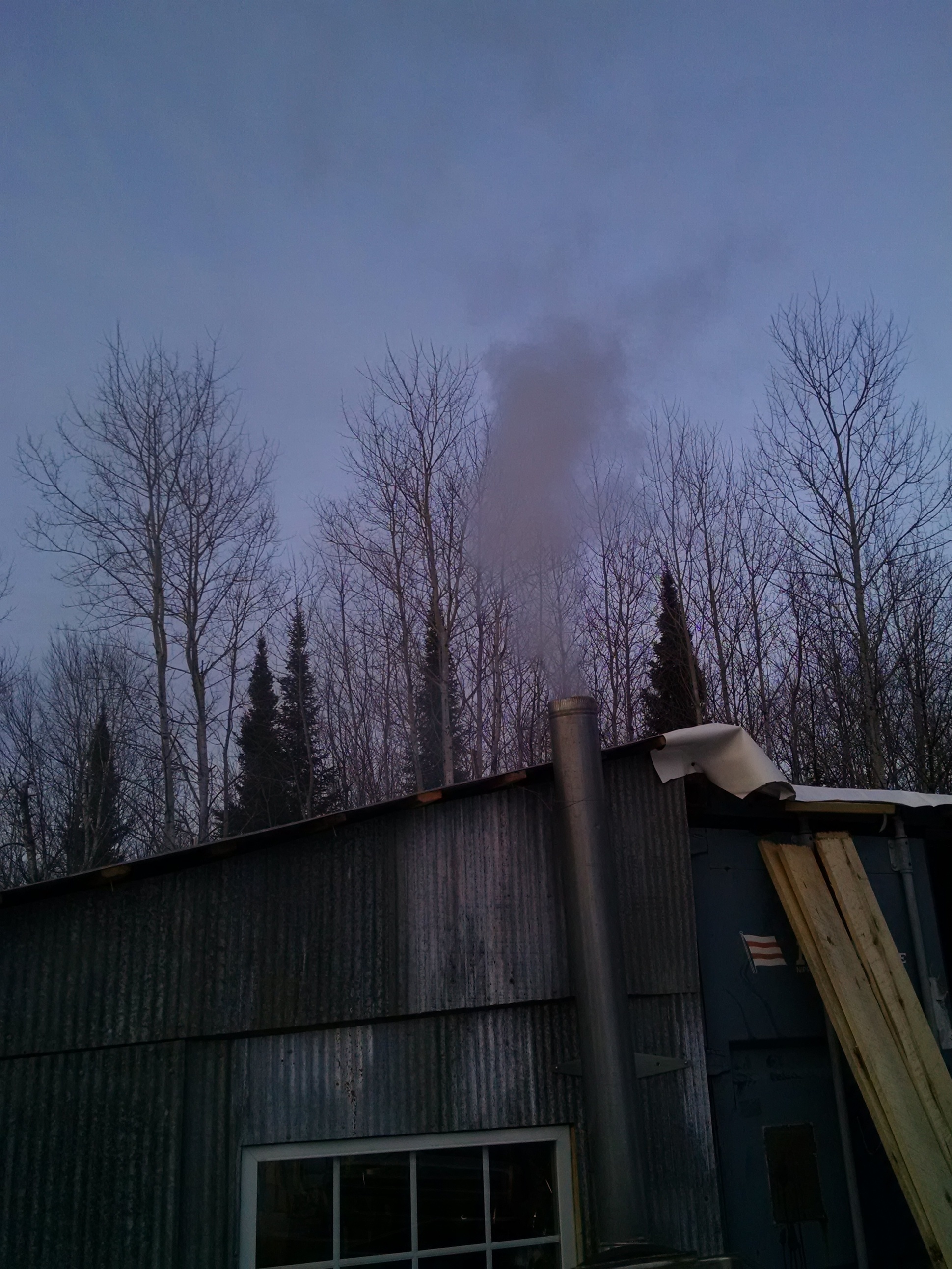

I have the evaporator a test run this evening. I was very pleased with how it ran with the fan on. When the fan is off, smoke starts coming from the chimney. Granted, I only had one load of wood in it so no coals were established.

My question is the fan is mounted over a 2" hole. If I want this to run without the fan, do I cut more holes in for the primary air?
Also, do I want to put a damper on this?
If it is smoking I think you need more air on the secondary to burn the smoke off. Can you easily add a blower there and let the primary run on a natural draft? It is probably a pretty big fire but I would think 2 inches with the chimney height you have there would pull a good draft on its own.
Your secondary air doesn’t have a long enough preheat travel distance to heat it up and thus pull a good draft on the secondary air.
The secondary air just doesn’t have a high enough cross section to pull in enough air without a blower. The modern systems I have studied bring in both primary and secondary air from one source and allow you to divide the flow rate between the two with a damper or gate valve. The secondary air also runs around the burn chamber somehow to give it more thermal expansion. I haven’t experimented with it myself only looked at designs and read about it so I am not sure.
