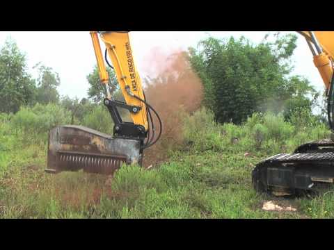

Ive been researching pellet mills and want to attempt to build one. I dont see how they are all that in efficient. They make enough fuel that would fill one of my small machines or ones like Stevens in no time. Just guessing but that amount of fuel I think could in turn run the pellet mill for an hour or two considering the density of this fuel. Ive developed our machines mostly around chips as this was what the majority of our customers wanted and the equipment is readily available. In order to increase run times auger fed systems came along so chips again was the fuel of choice. Our machines set up for chips I dont see an issue with running chunked fuels as long as it is sized according to what the machine can process. However, I think as I move forward and begin cost cutting in our manufacturing process our cost will soon begin to drastically reduce. This would leave room for the added cost of a pellet mill and finding dust for free is easily found. If not there is a company near me that produces a crumbler that can turn a log into dust in a matter of a minute. We could put a small version of this directly on top of the mill and shove chopped logs into it. There are a lot of other benefits, easier to flow, easier to auger, higher density, longer run times, allows for more compact systems, fuel storage and most of all fuel standardization. This opens possibilities for adding in other sources to be mixed that would not otherwise work in a gasifier. So I do think future development will be driven around pellets, the machines should begin to shrink in size but produce the same power but at a higher level of performance But first I need to make that pellet mill, see if we can run it on its own fuel and what the return is vs fuel invested :fire:
The crumbler is sort of like this thing.
Matt it will always be a trade off between the ease of operation and the energy used to produce the fuel. If you get dust as a waste product from some other value added process. For example milling lumber that is one thing you are turning waste into fuel. Closing the waste cycle is always a good thing. When you look at that crumble machine just grinding trees into dust then processing it into pellets the process has to use more energy to make fuel then just chipping, chucking or splitting it into stove wood. It is more processing in the quest for ease of operation. I am sure there is a market for pellet based systems because I am sure there are people who either don’t have access to their own fuel wood, don’t or can’t do the work to process it. As we all age we get to a point where working up wood isn’t as much fun.
I guess my point is don’t fool yourself into believing that the answer is to just fully move to an easier to run finial process. There is a need for both. Selling a pellet machine really just allows people to switch which company they are dependent on. That isn’t totally bad using our waste sawdust and other stuff that can be processed this way is a benefit over FF. But it isn’t as good as the chips or chunks comming off your own land.

The crumber vs the chipper both are going to use energy. The video is an extreme example of one. What we would build is a crumbler about an 1/8 of the size of this. This company builds machines for recycling various materials into usable medias. Glass, plastics, metals, wood, ext.
What Im after with pellets is putting that equipment into the hands of the user, while producing a machine that will be more practical along with easier fuel processing. Im am sure and 100% positive that this process will be more energy dependant, but if it saves time and the amount of labor the user has to put in then its worth it. Then to add indeed the whole point is to be renewable so waste product for fuel media is part of the goal. The crumbler added then gives the user the ability to take down there own fuels on their land to be processed.
