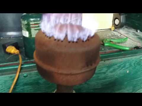

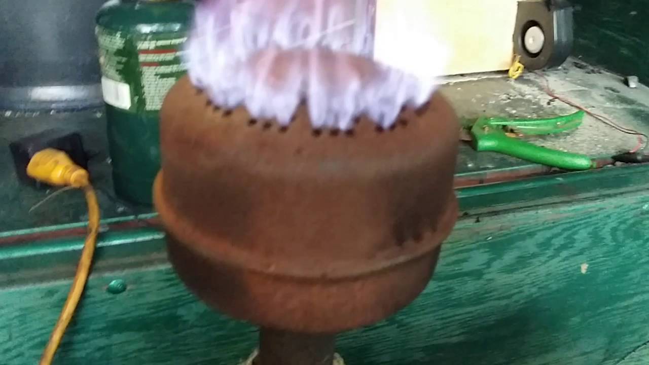

I am slowly catching up with Koen’s diversity after I get my wood gas cook stove built. This is the start of it.
Muffler burner is a clever use of materials for sure.
Don,
i need lemon juice now… my smile hurts…
Nice! The flames sure are butifull.
They also tend to dance like that on my charcoal stove but once the pan is on everything gets better.
Hmmm! A new way to charcoal broil a stake. Just hold it like a marshmallow on a stick. I’ll be right over. TomC
We are all like cave men who just discovered fire, the possibilities are endless!!! Great adaptation Don.You will survive!
Very clever!

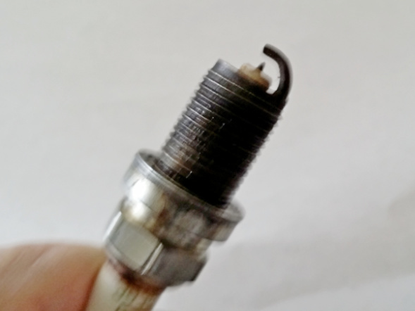

Tracker has been starting harder and missing under load a little so I thought I should replace the plugs once. I think this explains some of the problem.
The center pin was eroded to a point.
While I was at it I ordered a new set of wires because a couple of the long boots that went down through the valve cover were broken. I am not used to overhead cam engines where a socket extension has to be used to get down to the plugs. The E3 plugs I bought were a little longer from the compression washer down, so I plan to turn the engine over by hand to make sure they don’t get hit by the piston even though the manufacturer says they fit this engine.
Hi Don,
These plugs are with the point like that, maybe just a bit smaller gap,
They are either platinium or irridium
