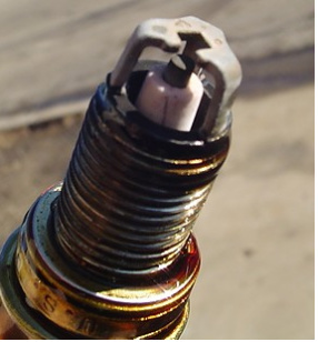

Yes Tom they are different. I think E3 stands for 3 electrodes like this , , .
The diamond shaped hole at the bottom is purported to release the spark downward instead of sideways as in regular plugs for a head start to a more complete burn.

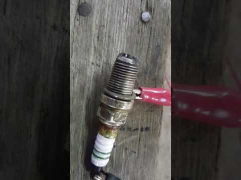

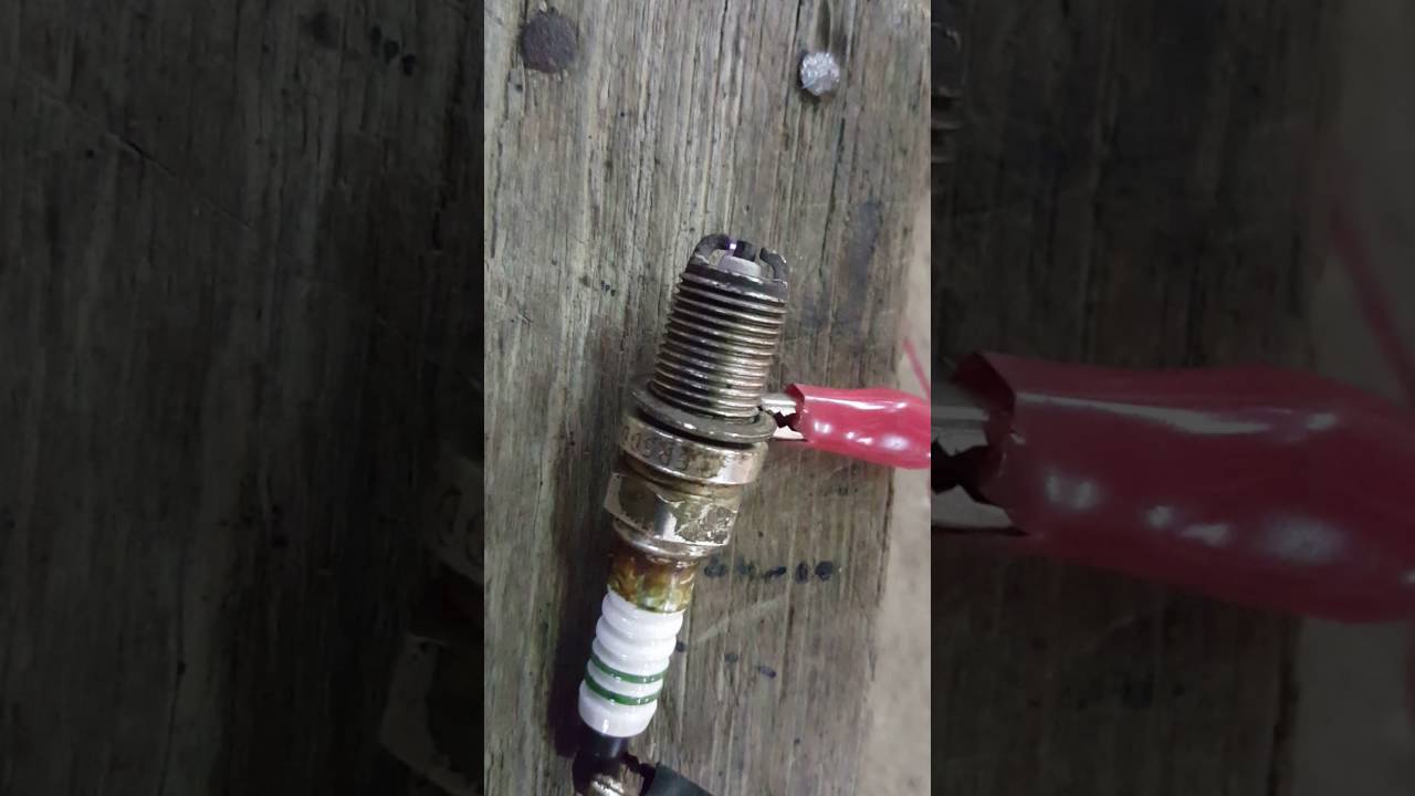

Been playing around with sparkplugs…
testing old plugs for gas/flare ignition…
did took old plugs to compare, coz the flare would not start…
Then i noticed the “R” sign in the plug-number and yes…
Which type you think would be better to use ?
How important are spark plugs with woodgas ?

A few thoughts on spark plugs that need qualification. Shorter gap gives longer duration and more dense/powerful spark (less likely to be snuffed out by pressure and less volatile fuel). Sharp edges initiate sparks better than rounded surfaces. Indexing or other geometry with spark open toward fuel is better than spark blocked by ground terminal. I look forward to learning from the experiments and discussion.
I have been using the E3 plugs @don_mannes, that Don talked about. I had new standard plugs and the E3 plugs seems to start on woodgas easier to me. My 2 cents.
